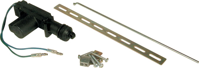

I purchased the power door lock actuator from Princess Auto for $10.
This kit includes:
- a simple servo motor with two wires
- a metal rod that hooks into a hole on the tip of the actuator
- a fastener to join the actuator's rod to the door lock mechanism
- screws that fit the plastic actuator housing perfectly
- some other mounting hardware we won't need in a Delica
The actuator is very simple. If you feed it 12V DC in one polarity it goes one way (unlock), feed it the other polarity and it goes the other way (lock). I installed the actuator directly below the manual push/pull lock knob in the door, up against the inside of the door frame. Here's a step by step:

In the L300, you want to mount the actuator against the inside panel of the door frame, well clear of the window glass, and directly below the manual lock lever, which you are going to attach your actuator's arm to.
  • Insert the supplied metal rod in the actuator. It needs to be attached before you install the actuator.
  • Slide the closed side of the rod fastener onto actuator's metal rod, and thread the screw loosely. Also thread in the other screw now so its handy when you are ready to fasten it to the manual door lock rod.
  • Position the door actuator inside the door frame by hand and line it up. The actuator's rod has to be bent to line up with the manual door lock rod; take note of where you are going to want to make that bend, as well as the general location of the mounting holes that will need to be drilled in the door to attach the actuator.
  • Make the bend in the actuator rod and line it up again. Remember you need that bend to happen low enough that you can tighten the screws on the rod fastener.
  • Make your first hole with a drill bit slightly larger that the provided actuator mounting screws. Use the actuator housing to line up your second hole and make it.
  • Now fasten the actuator on the inside of the door with the mounting screws, and attach the actuator rod to the manual lock rod.
  • Test the action with the manual lock. Adjust the rod fastener position as needed. Once you have it lined up, you can test the actuator motor with a little power. Switch polarity to change actuator direction.

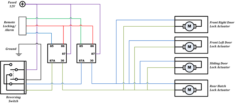

Ahh think i get what is happening here. If you break the correct wires at that switch, you are effectively cutting off the existing central locking relay box which runs the sliding and rear doors. Once that is done you can insert the one which came with the central locking kit.
Hmm now ive just got to figure out which wires lead to the existing central box. Any chance you can pop out that door switch and show us how the wires are connected?

we didn't touch the drivers door lock wiring, just added the actuator to that door so that when you hit the alarm control and lock the drivers door it would send the signal to lock the other two doors. Then we disconnected the wiring from the rear tailgate door switch and connected it to the alarm ,catch is i havn't figured out how to keep the tailgate door switch wired in as its not compatible with the alarm wiring, it kept blowing fuses every time we hit the alrm switch.Cheers Jay TardisDeli

Won't help the problem is the tailgate door switch itself, in its ''middle/off ''position its circuit is closed ,so when you hit the alarm switch it blows a fuse.I would change the switch but the problem is finding a switch that will fit in that hole ,which is not a standard size.

Here's the schematic that I proposed to Jay for the final configuration. We haven't implemented this yet, but essentially it uses a reversing switch in the dash (Jay says the stock switch won't work as it shorts in the resting position, which is very weird), and supports central locking. All locks including the hatch lock/unlock together.
Note that below we connect directly to all four actuators. I have deleted the stock door lock "brain box" and the automatic locking trigger in the driver's side door, as they conflict with the reversing switch and I feel it necessary to have a switch to control the locks in-dash.
