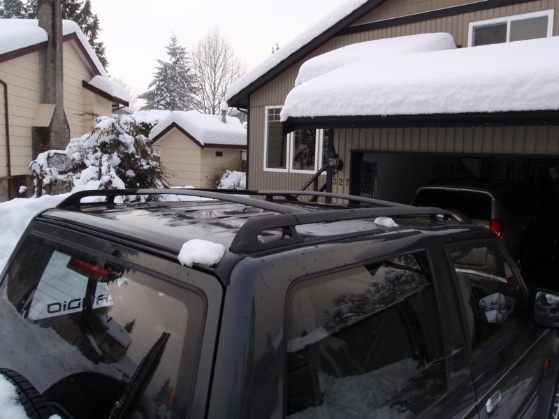

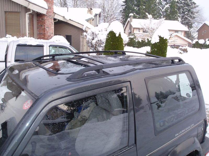

I went to the wrecker and found a truck with roof rails that were approx the correct length and width and came up with this

This was my last choice, but now that I see it all together, it seems like the best way to go. Better quality than the yakima crap, bigger feet etc.
Do you remember what vehicle it came from? What did you need to remove it? Saws-All? lol

you'lll find that when searching at the wrecker's, most of the roof racks seem to be manufactured by the same factory. they all seem to be almost identical (mot of them not all) I got this one off a Nissan Frontier... however i'm pretty sure that the newer style (around 98 or 2000 year) blazers and other smaller SUV's have them
I took the head liner out and used things called "nutserts" to mount them (they are a rubber "Crush nut" thing) availablt at lordco for cheap and then used marine grade epoxy on each bolt to ensure strength and seal

Raule Duke wrote:I took the head liner out and used things called "nutserts" to mount them (they are a rubber "Crush nut" thing) availablt at lordco for cheap and then used marine grade epoxy on each bolt to ensure strength and seal
Ah ha! That's what we used. Although we didn't take the roof liner out, just inserted from the top.

I just realized that I took home the same rack from the wreckers. You're right, there are lots. I figured it was also a good thing in case you need parts.
