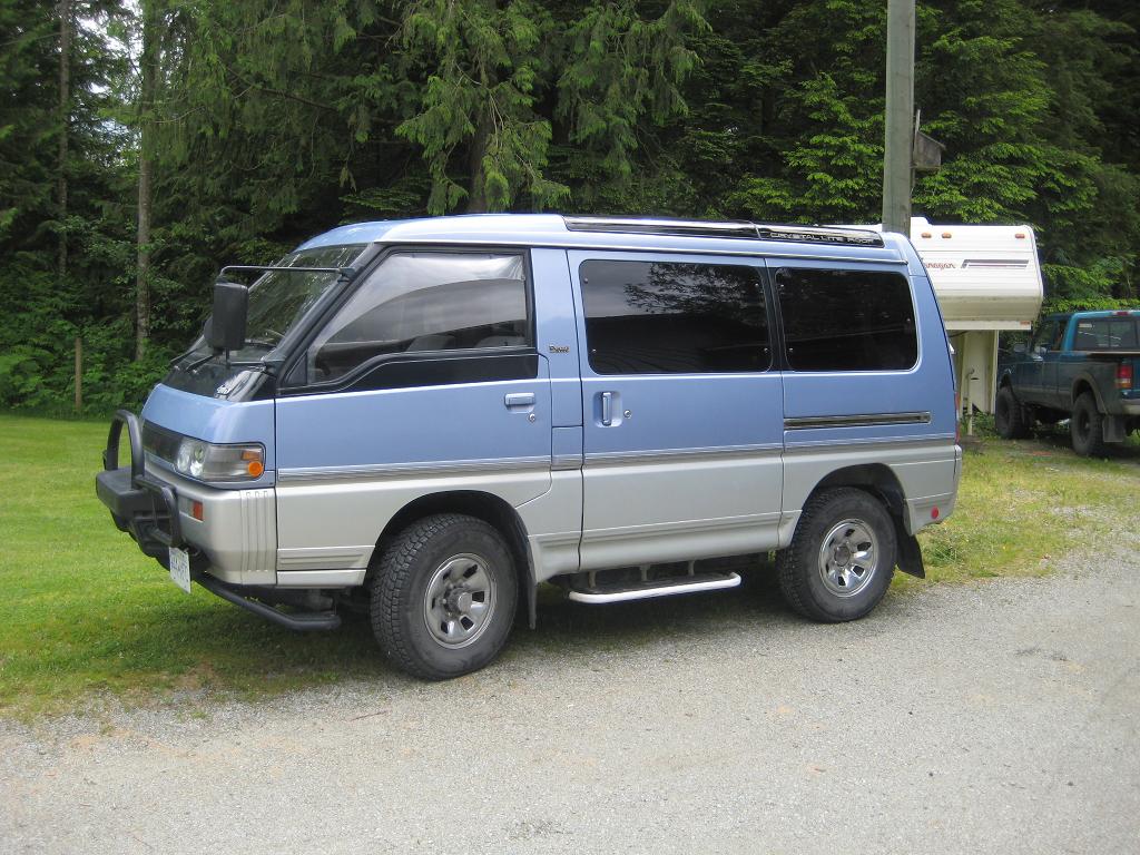

On an L400 note, I just finished an install for a customer.
This one went from one extreme to another.
The stock L400 was sitting on 27" tires (17x10" rims / 40 series tires). Although it was a rocket on the street, alas, offroad it would do nothing. So a lift was put in with a fresh set of 31" BFG AT boots.
The effect before/after is quite noticeable. :-D
Comparison with lifted vs. non-lifted (on the right)
Too low
Tire comparison
Final product

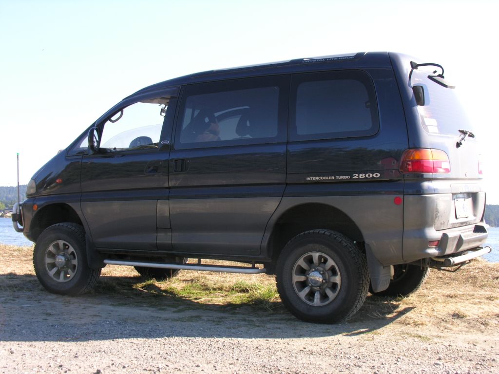

Just wanted to add my 2 cents worth on these lifts. I purchased one and had Jesse install it a month or so ago and am verry happy so far. I would have posted earlier but I was waiting to try it off road first. I still havn't got off road with it :-(. On road it is great to drive with though the bigger tires have slowed me down some. It also realy looks good in my opinion. Thanks Jesse and Ill have more to say when I get it off road.
Befor
Befor
After
After

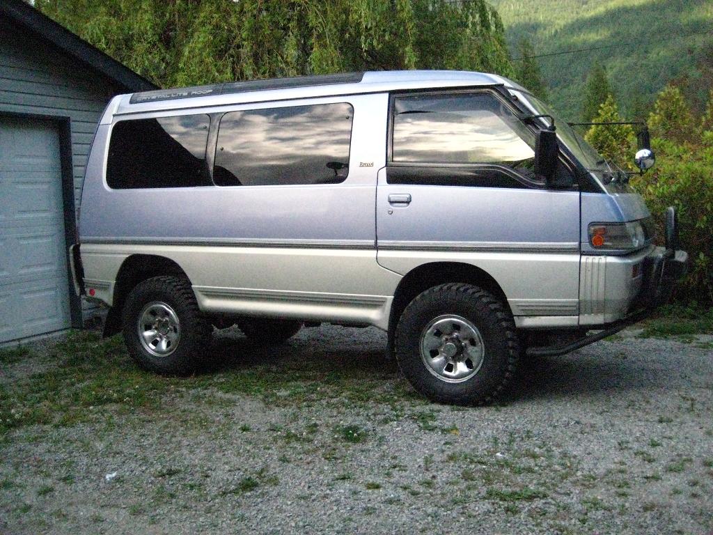

Hi Jesse, thanks again for the spacers. Below are a couple of pix of the van with the lift and 30" x 10.5" BFG Mud-Terrain KM2 tires. A great setup for every season. Leaf.
Re: 2" L300 / 3" L300 / 2" L400 lift kits for sale
Nice Leaf !
Those look like 31's .
Nice spotties up front 8-)
