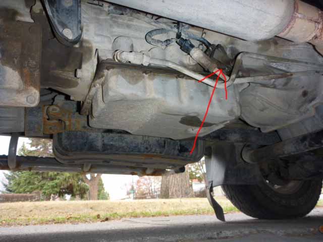

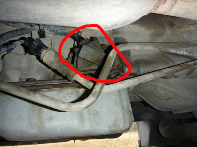

Okay, now that I know what and where it is, here are photos for everyone else.
They are taken from the right side of the Deli, behind the driver's door, facing the left side. First, an overview; you can see the fuel tank and sliding door's step in the background:
Tranny module 1.JPG (63.08 KiB) Viewed 7175 times
And now a close-up shot:
Tranny module 2.JPG (59.04 KiB) Viewed 7175 times
Oh, and before someone tells me I have a tranny fluid leak, those stains are all WD-40, Liquid Wrench, or silicone lubricant.
Hopefully this helps someone else.

What's in that thing anyway? Electrics? Cable? How does it work? Moving the shifter pulls a cable, does the cable go in there? Are the wires for tellbacks to the dash and the computer?
Re: Auto shifter stiff
Posted: Wed Mar 31, 2010 7:39 pm
by Erebus
mararmeisto wrote:What's in that thing anyway? Electrics? Cable? How does it work? Moving the shifter pulls a cable, does the cable go in there? Are the wires for tellbacks to the dash and the computer?
When you move shift lever, it pushes cable, which pushes lever on left side of transmission, which rotates a shaft that goes horizontally right through the tranny. It has, on the inside of the tranny, what has been called a rooster comb on. That does the actual shifting of the tranny, other than the electrically operated overdrive.
The shaft comes out on the right side of the tranny. On the end of the shaft is this module. The module detects the rotation of the shaft, which tells the module what position your shift lever is in, which normally is also the gear the tranny is in. The module then tells the dash display which light to show. It also tells the computer, which controls the overdrive and perhaps other things too.
In the close-up photo, there is a rectangular plate that is on top of a 1/4 of a circle. The rectangular plate moves with the rotation of the shaft, telling the 1/4 circle what position the shift lever is in.
Hope this makes sense.
