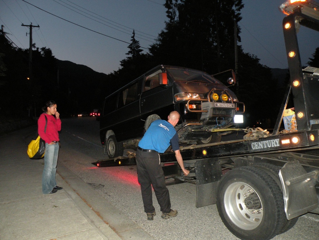

...so this is the first picture of my lovely deli on day 9
and the friendly payless guy.
