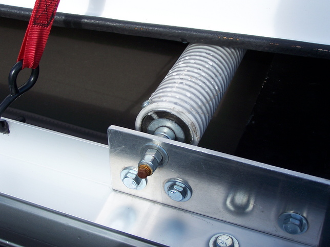

4318: The frame for the system is 2” aluminum angle. The roller is mounted on 3/16” aluminum plate bolted to the angle for additional strength. The rollers are 2”. I made acrylic inserts to fit in the pipe and glued and screwed them in place. I used 3 – 1/2”pieces glued together. I drilled 5/8” holes in the acrylic and drove 1/2” bushings into the acrylic to provide a smooth long lasting surface for the shaft. The only size that is important is the shaft. The remainder is whatever material you can scrounge.

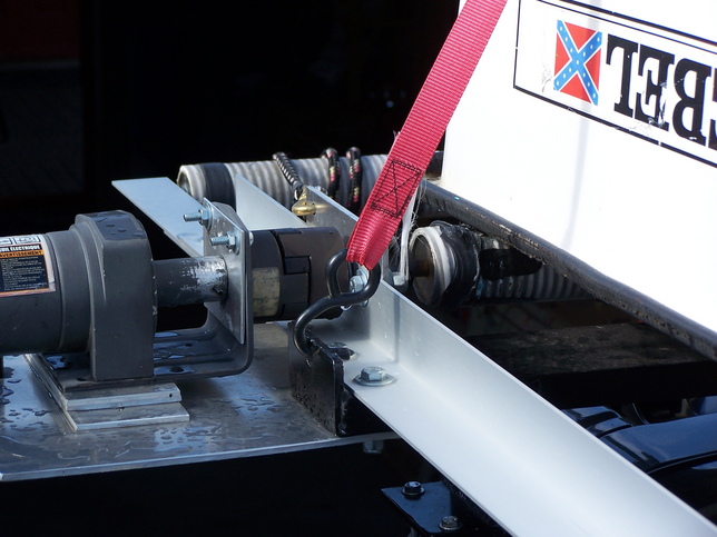

4319: The drive system uses a 2000# winch with the drum removed and a flexible coupling added. I have since found an angle drive that would work better but the winch was $ 59 and the drive > $ 200. This was the trickiest part of the system. I would use different connection system for the winch drive shaft next time. I used 2” suction hose over the pipe for traction as the drive roller pushes the boat on and pulls it off. Some use a hose similar to a rad hose which would work better. I have added rubber tape to give better traction but is wares off.

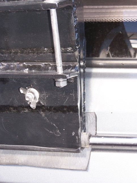

4320: I was concerned the rack might scratch or rub the gutter so I used a piece of old tube for protection. This worked well as after a year of use the rubber was not wore through and you can't even tell where the racks were mounted.

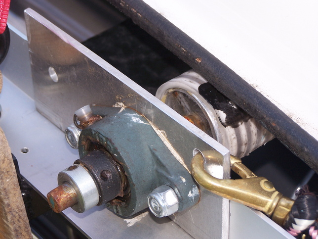

4321: I used bearings for the rear drive to make it as smooth as possible. This may be overkill but it provides a nice solid drive roller.
