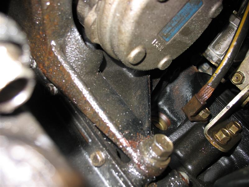

Alright.. I changed the oil and filter, and got around to taking pics of where the diesel is leaking from..
Does this look like an easy fix ?? I'm afraid to tighten it and eff something up further. :M Help?
Ok, Glen tells me this is the valve cover gasket... hmm,
If it is that, then it's oil then.. I'll take it to Glen and see if he can give er a look over and fix it up... :)
When it's dry out, i'll have a look again and see if i can maybe see a diff source of the leak, cause the valve cover was replaced in August.

Re: burning smell and oil on ground
Are you certain it's not leaking from the turbo ?
Oil has a way of making it's way in all sorts of small areas under your vehicle.
Gravity and driving can place oil in places far away from the originating leak to places where there is no leak.
On your pic it looks like the gasket is on it's last legs.
Take a few more pictures from different angles if you can. That would help. :M

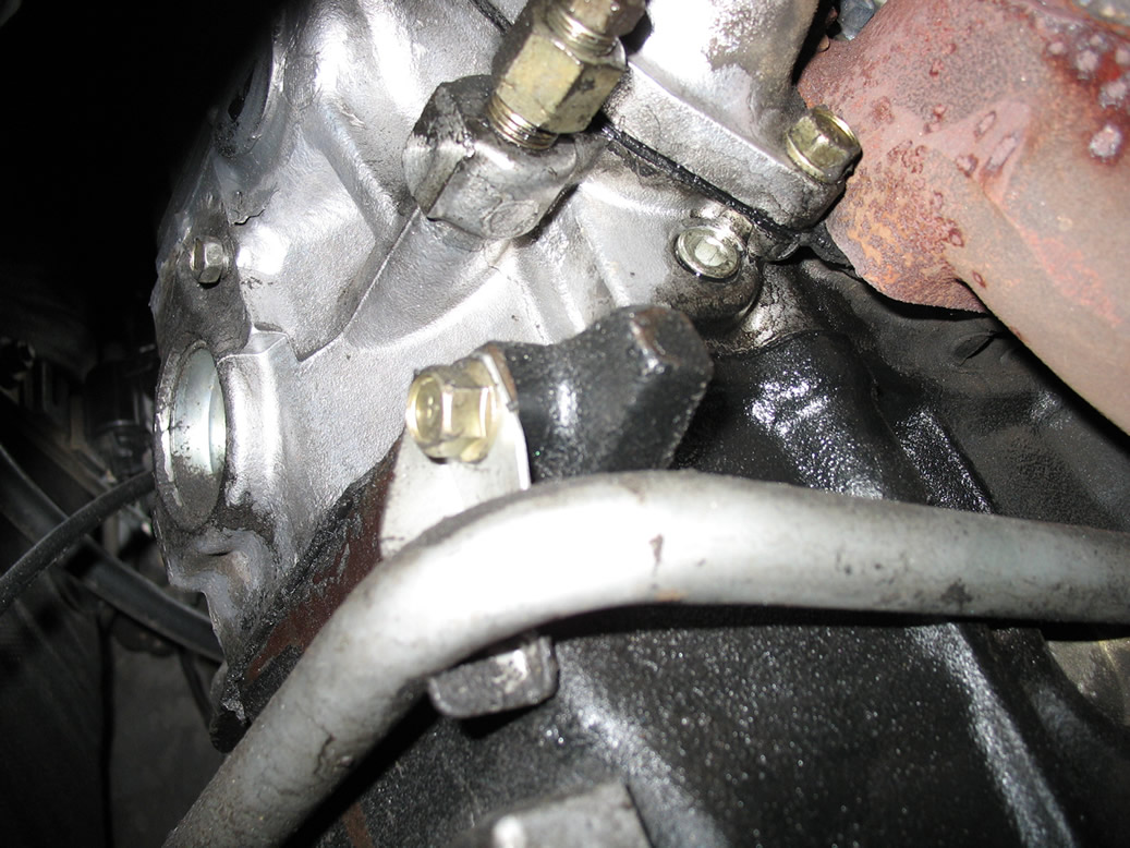

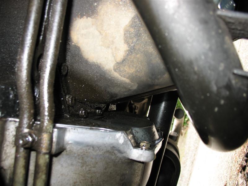

I dunno where it's coming from. It'd be much easier on a hoist.
IMG_0255 (Medium).jpg (79.35 KiB) Viewed 3691 times
IMG_0266 (Medium).jpg (63.72 KiB) Viewed 3690 times
Can't tell from the pics.
Slide the driver's seat all the way forward, fold up the carpet behind it, undo the wingnut and remove that panel.
Look down at the turbo and see if it's leaking there.
Who knows, but it could be leaking from the turbo up to or the half moon valve cover gasket near the rear of the engine.
Both points leak similar to your pics.
In your shoes, I would PM/ask another member on here who lives in Victoria if there are any places in the Vic area that can do Delica's and are trustworthy.
If not, then I would call Noel and ask him. He's full of Deli knowledge. enviroimports.com and located in Victoria.

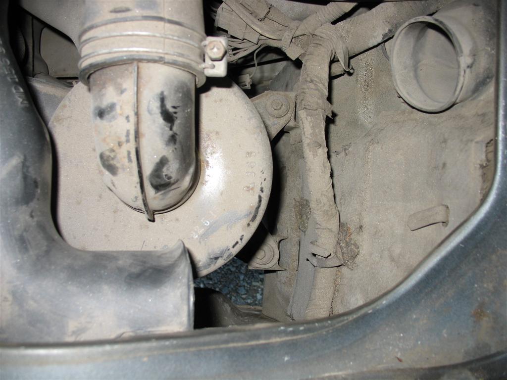

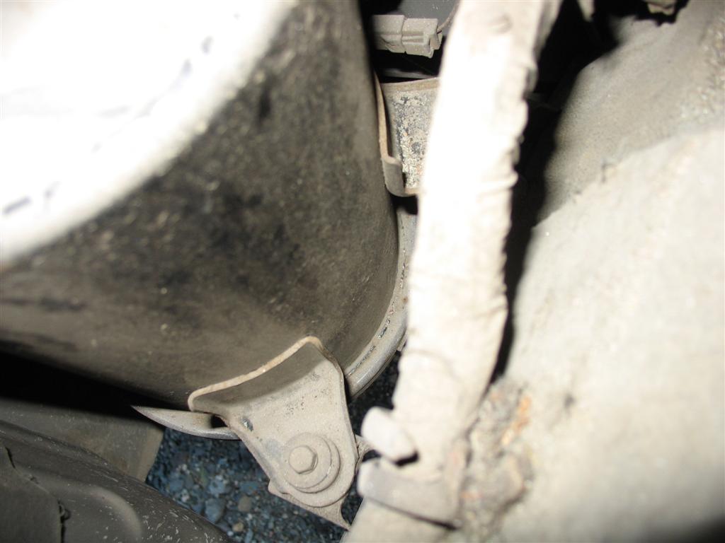

it's dry as can be under that access panel
IMG_0274 (Large).jpg (67.26 KiB) Viewed 3643 times
I see what looks like a hose missing though..but that's nothing.
don't worry, that's intentionally missing... allows any big particles to "fall out" before they get to the air filter, it's actually a brilliant bit of design work.
