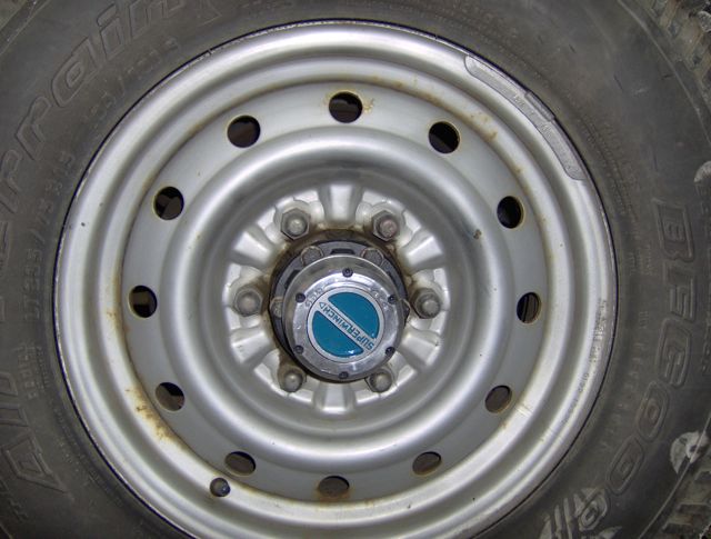

Re: 4x4 mode on a Delica
With auto hubs, yes, they will unlock if you reverse in 2 high - Did you do a 2 high back in or out of your driveway? You only need to roll back a meter or so to unlock them. No need to put it in park to switch in and out of 4 high either, just the hubs locked and a non-grippy track to run on and you can do it while motoring. I can keep Hazel's hubs locked in 2 high reverse 'cause I have to lock and unlock them by hand - there are real advantages to the manual hubs... :-D :M
manual hubs.jpg (52.17 KiB) Viewed 5502 times
