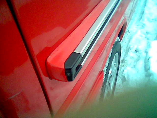

What if we put the door extension mod upside down?
- Door rail extender.jpg (29.14 KiB) Viewed 3858 times

Re: Sliding door extension
one thing you can do as well.
I took a few spacers and spaced out the roller guide (outside along the van).
Now it 'just' clears the offset tires.
After Oil,
Have you tried putting a couple spacers on the door (to push out the roller thing at the back of the door). I've done that on mine and that was enough to clear the tire (31" mud) and pretty much fully open the door (still very slight rub but could be because the superexceed carpet is thicker). It also doesn't affect the seal for the door once closed.
Might work better than waiting for someone to do that extender and much cheaper!
Good luck,
Good luck,
i only see L400 stuff on there...Green1 wrote:the delica.us site has sliding door extension hinges available...
i added spacers behind the wheel channel. it gave me some clearance, but still not enough! next maybe ill pull off the sliding door panel and see if i can add spacers to the rear hinge.. i hate pulling panels, i always break the crappy board
I didn't put any behind the wheel channel, just the sliding door hinge so it'be be worth giving it a go! Panel boards are over rated!
