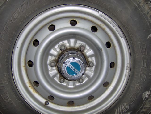

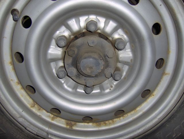

Well we finally got the hubs changed over to the Superwinch manuals. No, I didn't attempt the project! Hazel was in to ccautos for a new windshield and motor mounts so we had the pros do the switch. Thanks for the parts number and connection jfarsang - a big help. I want to bring up this post again to point out that some delicas come with permanently locked hubs. Ours did and hence the desire to switch them. The new manuals are great - with the deli ya don't even need to get out to switch them; just open the door and reach down!
If your hubs look like this they are permanently locked and so should probably be switched for auto lockers or manuals
The new manual lockers don't look as good, but hey, not bad, and function before form, right?
- manual hubs.jpg (52.17 KiB) Viewed 13727 times
