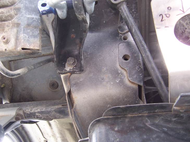

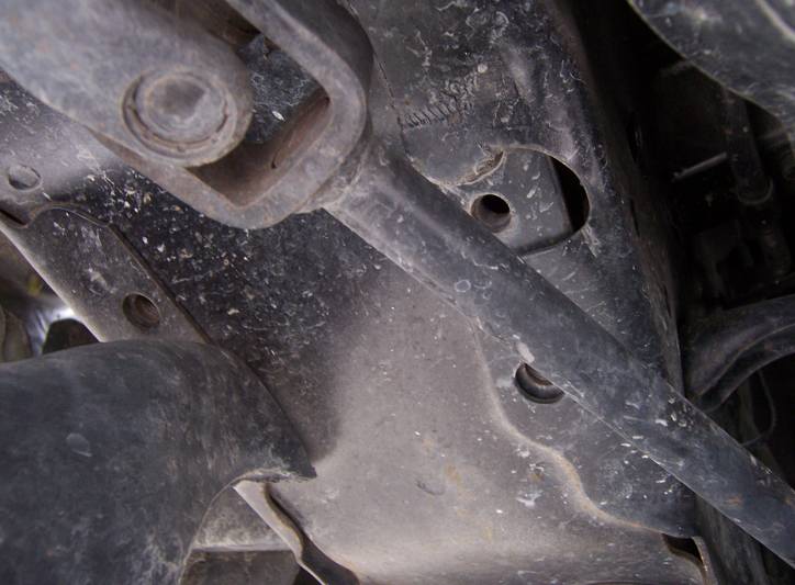

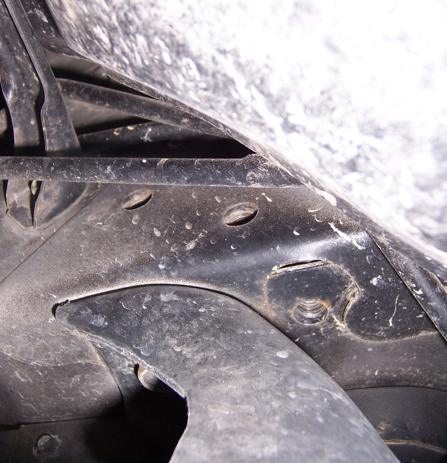

Where the driver's side front bar (the bar with the shackle) is mounted on the frame it's only using 1 bolt but the frame at this location already has tapped holes for 3 more bolts. Could one fabricate a single arm with a mounting plate using either the 3 remaining available tapped holes (or managing to use all 4) to support the winch? Would it be strong enough?
The passenger's side front bar is using the only one of the two available mounting holes and the space is at a premium on that side (well, both side it's at a premium...). Like most others, just trying to find the best way to mount a winch...
Thanks,
David
It would be easier if you dident even look at those mounting spots, take a 14 mill socket, Remove the two bottom bolts, then reach inside of your plastic guard, you will feel two bolts on each side, Remove those, then your whole front bull bars will come off, then you will see the two steel sections that are attached to the frame , THAT is what you should mount your winch to. Keep it nice, simple and strong with out complicating things. when we mounted a winch on a customers van this is what we did, the plastic center section is cut to fit around the winch... you could always buy a winch, have us mount it and then you will fully realise how it goes......Yes Im cheeky, but Im typing so I'm allowed lol

They're on the right and left of the black part in the middle-bottom....
And I've winched mine out of a snowbank-ditch using the bullbars, so they aren't that flimsy, but I attached close to a mount point.

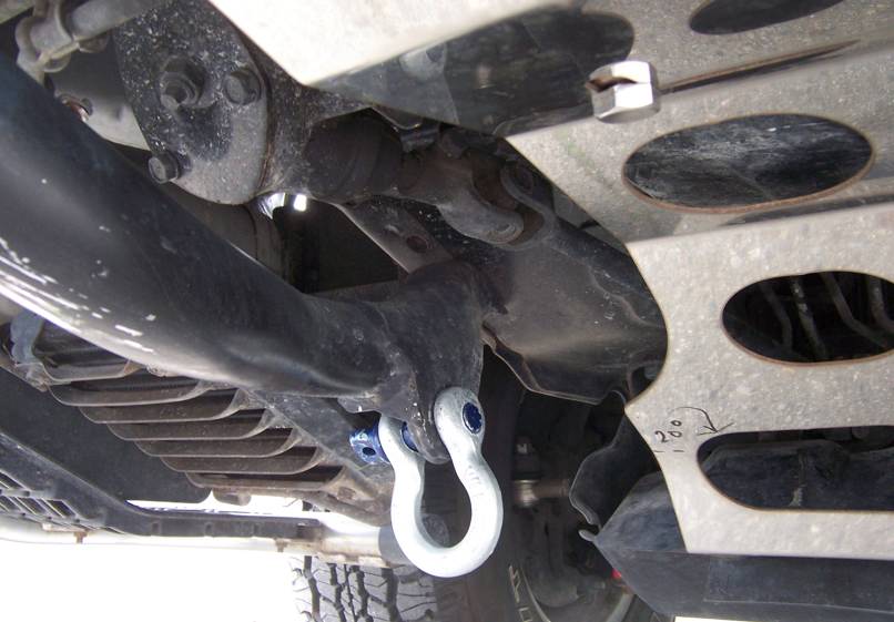

proper point to attach a line is on the lower arms in such a way that they can "slide" upwards to almost the mounting points shown in your picture (according to mitsubishi, and it makes sense, that puts it between the attachment points, and closest to the stronger of the 2)And I've winched mine out of a snowbank-ditch using the bullbars, so they aren't that flimsy, but I attached close to a mount point.
As for a winch, I would mount it in such a way as to have most of the force transfered to those attachment points.

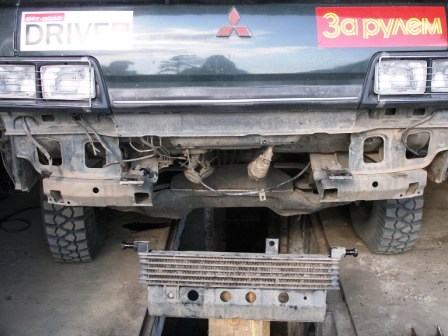

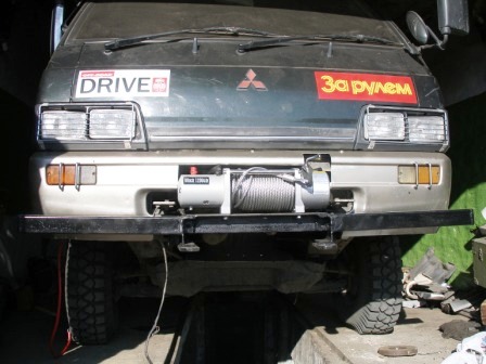

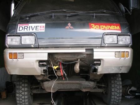

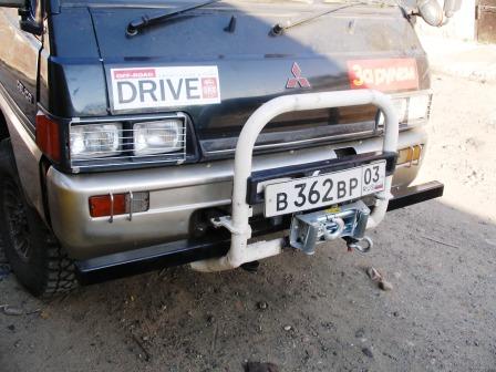

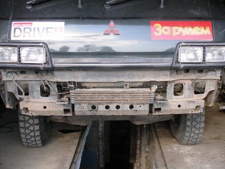

Here are the winch (12000) installation pictures found on http://www.delicaclub.ru/forum/index.php?showtopic=1376
BTW it is funny how they use short names 'a brick' for L300 and 'a bun' for L400.
