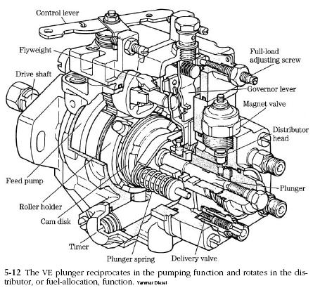

There are two plungers in a VE pump- the timing advance, and the injection/distributor plunger. If the timing advance plunger was stuck it would cause your symptoms.

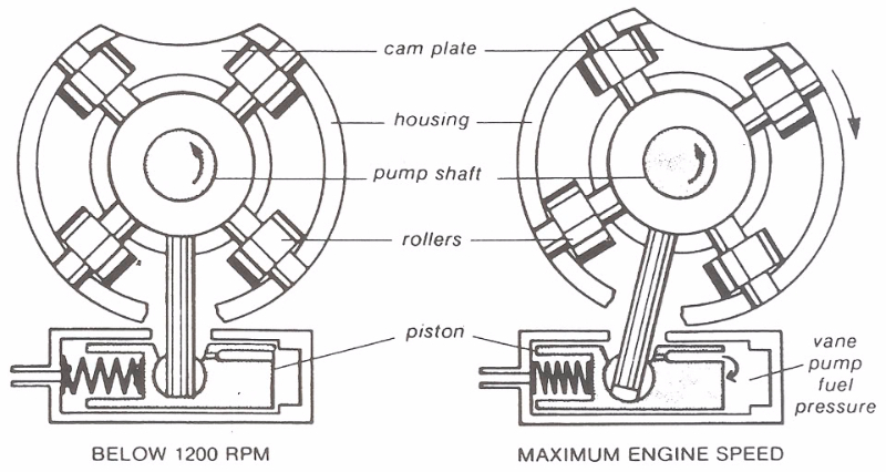

The advance plunger is labelled "timer" on the first diagram, so I'll call it that for now. Its function is similar to the ignition advance on a gas engine- fuel takes a fixed amount of time to burn regardless of engine speed, so when the engine is running faster you need to inject the fuel a bit earlier to give it time to burn fully before the exhaust valve opens. As engine speed increases, increasing fuel pressure in the pump pushes on the timer, which rotates the roller holder so the rollers hit the high spots on the cam disk earlier. Like this:
Incidentally, fuel pump internal pressure is controlled by a tiny orifice on the pump outlet. Thicker fuel will increase internal pump pressure, which would advance injection timing more- which is odd, since your symptoms imply *retarded* injection timing. Which is why I think the advance plunger might be stuck. Maybe the engine oil loosened some sludge that straight diesel didn't touch?.
The injection/distributor plunger is the bit that creates the high pressure for the injectors. Initial timing setup is done by measuring how far it has moved when the engine is at a certain angle (1mm at 9 degrees, on your engine, from memory). Actual setting procedure should be in one of the workshop manuals. I doubt your issue is caused by incorrect initial timing, but if you remove or rebuild the injection pump you'll probably need to set your initial timing.

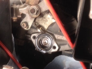

Purge made no difference, oh well. I removed the timer cover,
and I see the plunger.
I pushed it with my finger and it did not move at all. How far should it move? Are we talking thousands of an inch or a few millimeters? There is a snap ring visible in the picture that I could remove and then the plunger could move toward the opening? Taking a break for now......
EGTs high, Truck Sluggish
It moves a couple of centimetres at least during normal operation. You are pushing against a spring and the cam gears so it won't move freely, but I wouldn't have thought it was *that* hard to push. Disclaimer: I've not actually done what you're doing, so I'm guessing how hard the plunger would be to move. I can't think of any reason why it *wouldn't* move though.
I would try removing the snap ring and see if the plunger moves outwards at all. It may be that a small amount of movement is enough to free up whatever is holding it in place? It shouldn't be able to come out entirely since you have to dismantle the interior of the pump to get at the timing pin (steps 23-36 in the rebuild guide).
