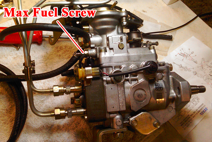

By "MAX FUEL SCREW" are you referring to the throttle lever screw? or the fuel flow screw ? I think you mean throttle lever screw. That looks about where it should be.

Artie Fufkin wrote: By "MAX FUEL SCREW" are you referring to the throttle lever screw? or the fuel flow screw ? I think you mean throttle lever screw. That looks about where it should be.
Max fuel screw is also called Power adjustment, full-load adjustment, fuel adjustment. This one here, on the back of the IP:
It sets the absolute maximum amount of fuel that can be injected (even if the governor is jammed, and the accelerator is on the floor), but it effects the fuel curve over the whole range. If it's set stupidly low, it will limit the maximum speed your engine will run at- engine speed on a diesel is entirely controlled by the amount of fuel injected.
Running better when warm also supports the idea that it's not injecting enough fuel- weak mixtures are difficult to ignite, but once the engine's hot they'll burn much better. I'd try turning the fuel screw 2 full turns clockwise (in) and see what happens. I wouldn't worry too much about winding the screw too far in, just adjust it by one or two turns at a time. If you've gone too far you'll find it impossible to get the idle down to 700rpm.
It *could* be a sticky governor, but I'd expect a sticky governor to cause over-revving as often as under-revving. Also, to stick in the "fuel cutoff" position, you'd have to have revved the engine over 4000rpm, which I don't think you've achieved yet.
My injection pump doesn't have any markings on the throttle lever or splines, so I had to make my own before dismantling. (Bosch pumps have fancy markings from the factory for ease of rebuilding.) If someone has added markings to yours, then it's a good bet it's been rebuilt before and the markings are probably correct.
