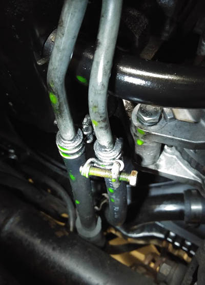

Of course, today when I went to install it (while taking photos for a how-to post) I noticed this:
Pretty sure my alternator isn't supposed to be leaking coolant, and all the usual suspects (radiator, overflow, hoses) are nice and dry. After a bit of investigation with a mirror on a stick I discovered that the water pump is pissing coolant out its weep hole. Not happy- it's only 40,000km old, and an allegedly high-quality GMB pump. So I have that to fix before starting on the Lokka install. Still, pulling the front diff will be easier with the radiator out of the way, I guess.

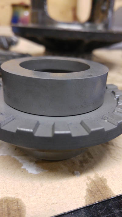

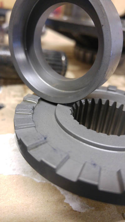

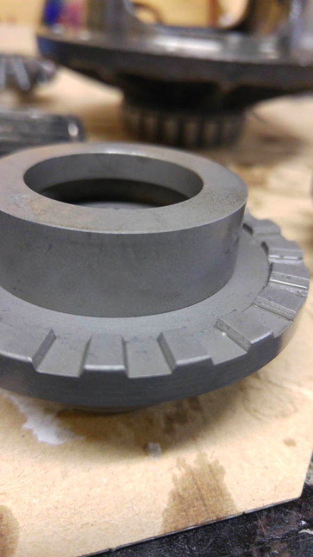

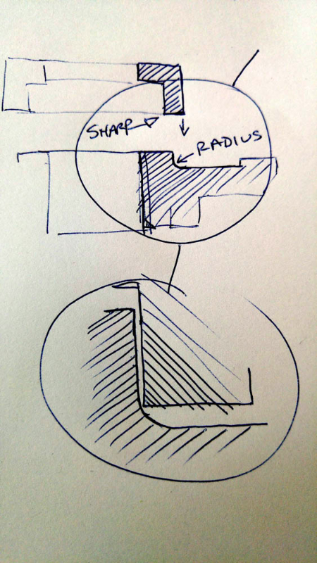

The two axle gears in the kit are different to each other, and the instructions confirm that this is correct. They expect one axle to have a circlip and one not- but both my axles have circlips. I've emailed Lokka to ask for clarification about which axle gear goes where.
There appears to be a machining fault- the spacers have sharp edges, but the axle gears have a nice radius, which means the spacers don't sit flat as the sharp edge catches on the radius.
sharp edge.jpg (48.27 KiB) Viewed 9686 times
This didn't give enough clearance for me to install my cross pin, so I fixed it (and ruined my warranty, probably) by grinding off the sharp edge on the spacers.
sitis flat.JPG (299.69 KiB) Viewed 9686 times
The thing that's really got me stuck is that it appears my front diff has been rebuilt at some time, and larger shims installed to compensate for gear wear. I have nowhere near enough clearance for the Lokka to work correctly, so I've put everything back together and ordered a shim kit (mitsubishi part number MB185519) as well as a new cross pin (MB241909). I tried grinding down my existing shims but they're super hard.
I'll try again once the shim kit arrives.

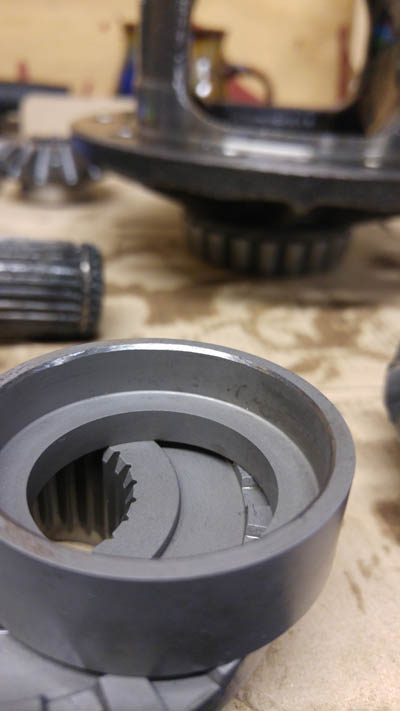

I'm ready to install the Lokka next week. When I took it out of the box to review the install ( and Growler's great write up ) I found it almost impossible to get the spacers on and off. I remember they were tight when I opened the box several months ago to see where the spacer needs to be modified but now they are really tight. They have been in my house all this time so it's not rust or anything as they look just like they did when I got them. My questions are:
1. How tight should they be?
2. Best method to make them fit?
Larry
L300 front locking differential solution, $300!
Mine were really tight, more so on the long/deep side. From memory the spacer went on the shallow side gear ok, but I used a vice to fit the other one.
If they go on even a tiny bit crooked they jam up. A bit of oil when fitting should help them go on straight.
