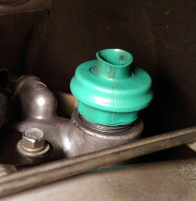

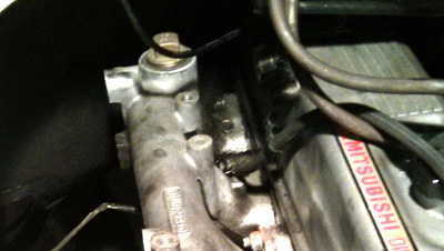

Standard practice is to put a hose clamp around the manifold and over the valve to hold it closed. Flexboi made a fancy adjuster here: http://dinoevo.de/pressure-valve-blocker/ and I've seen heat shrink used:
I cheated and replaced it with a brass plug. Not recommended unless you have a boost gauge and a boost controller.

Wow! Great pics, thank you.
So in both of these scenarios you don't have the line from the turbo attached anymore. So how do you control the wastegate??
Where exactly is the pressure releasing from out of curiousity, Is it the threads where the valve is screwed in?

Ah. In my picture the engine is half disassembled- it's difficult to get a photo of the pressure relief valve with everything installed. The wastegate actuator is installed as usual, with the usual line going to one of the turbo's output spigots.

Haha do you live on the forums? Thank you! I actually was confused, the close up pictures with a plastic sock on it confused me for the actuator.
I will investigate a bolt or shrink wrap. Thanks again.
