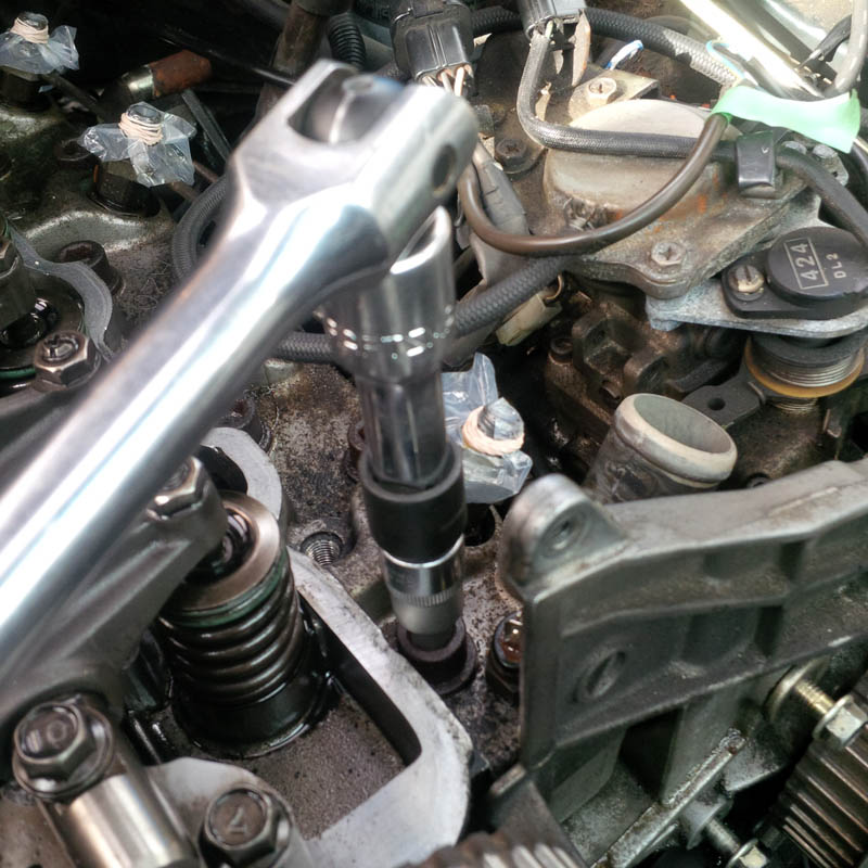

Crossing back to the passenger side of the motor, the next move was to crack loose the glow plugs.

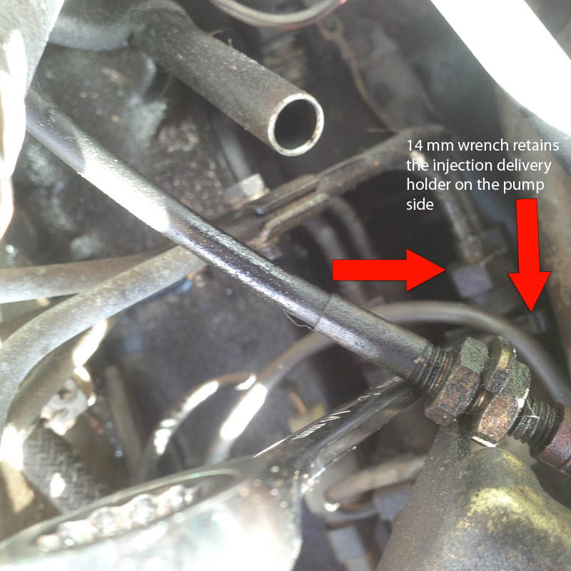

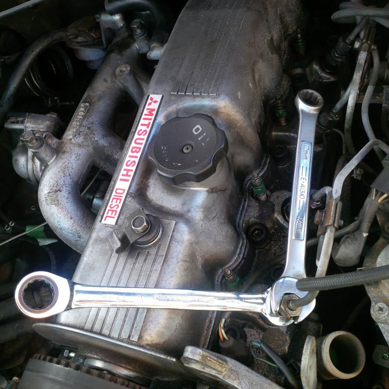

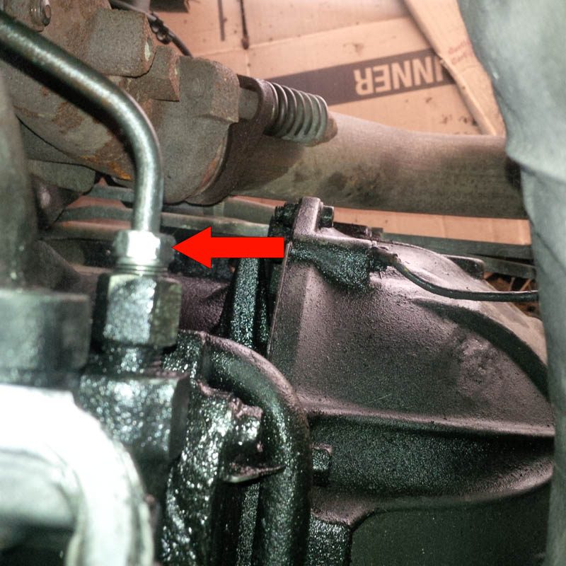

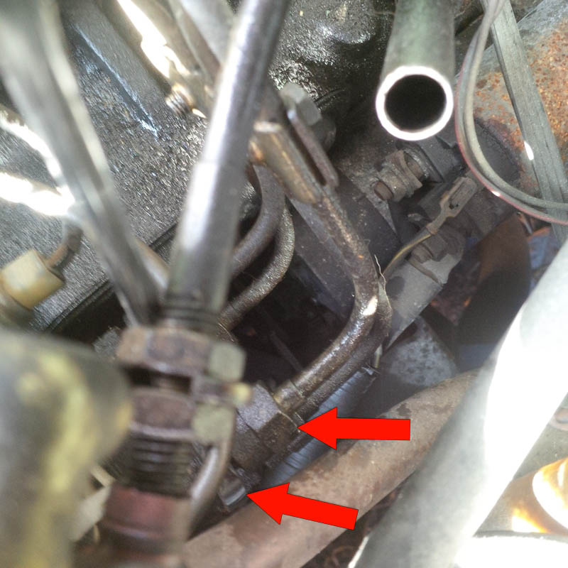

Then loosen all the unions for the fuel injection pipes, there are 8 in total. Use two wrenches and be gentle! Not a lot of room down in behind the injection pump.

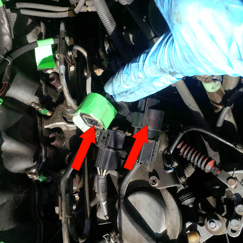

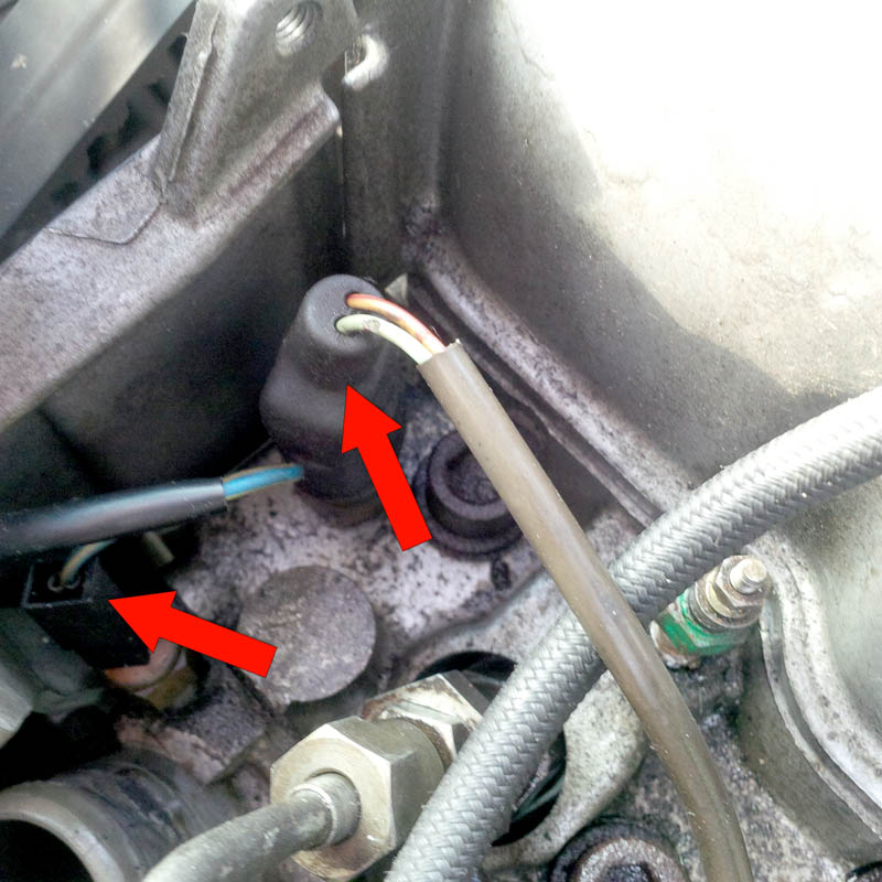

Remove the two electrical connectors on top of the injection pump.
And remove the two connectors near the front of the head on the passenger side, for engine coolant temperature.
Here are a couple more pictures of the back of the injection pump. Awkward to get in there, but it's doable with a bit of patience. Personally I get nervous around the IP. Try not to break anything!

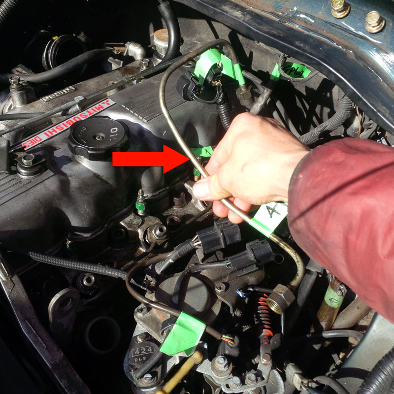

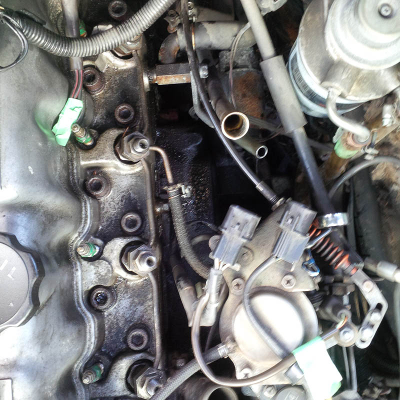

With the fuel pipes removed, it looks like this:
Make sure you've marked where everything goes for reassembly.

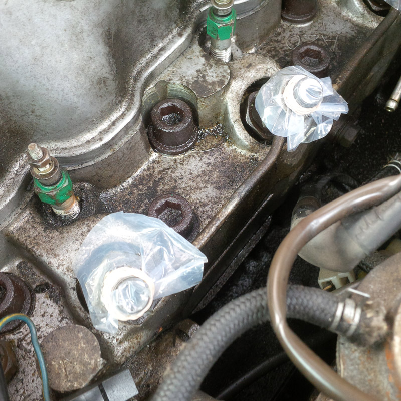

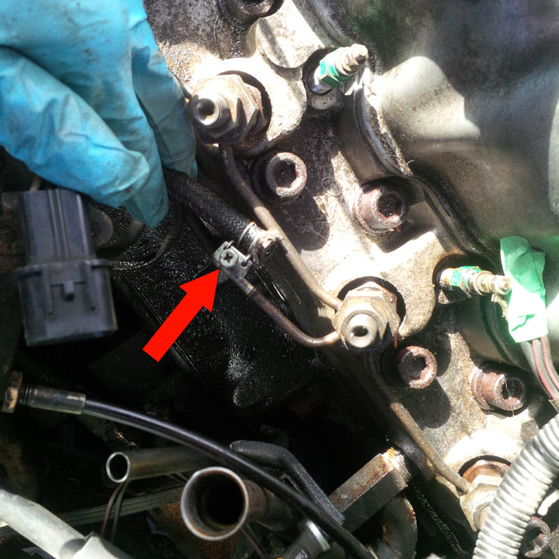

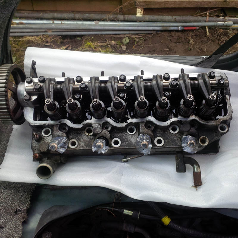

Remove the small rubber return fuel line.

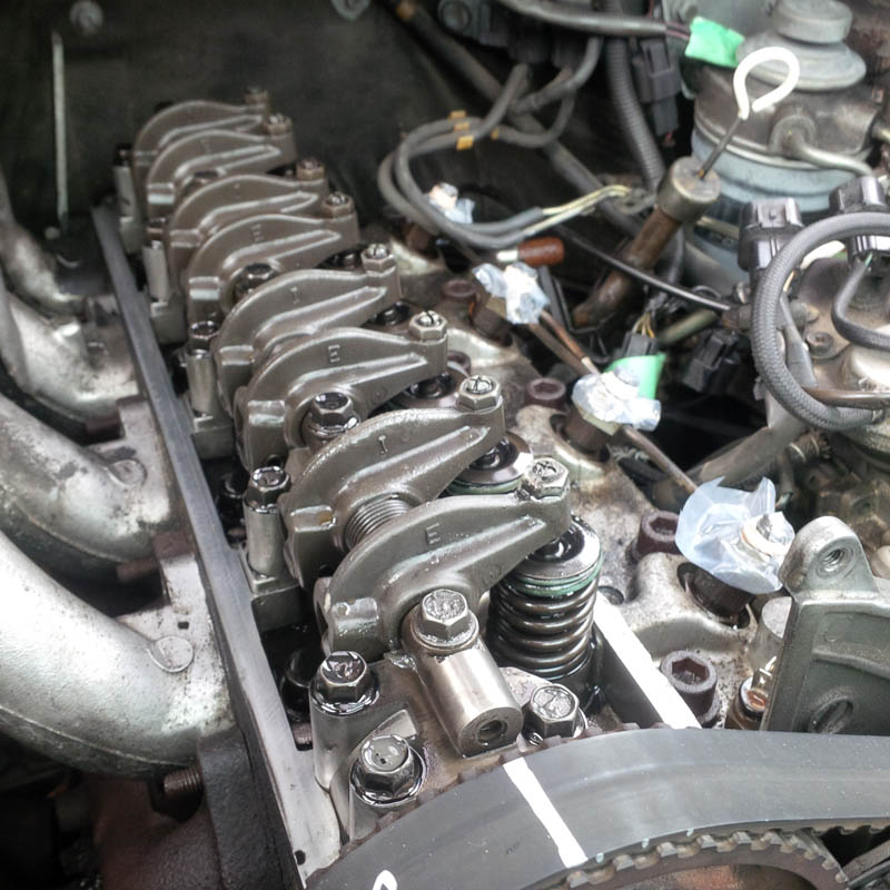

Now make some fuel injector condoms!

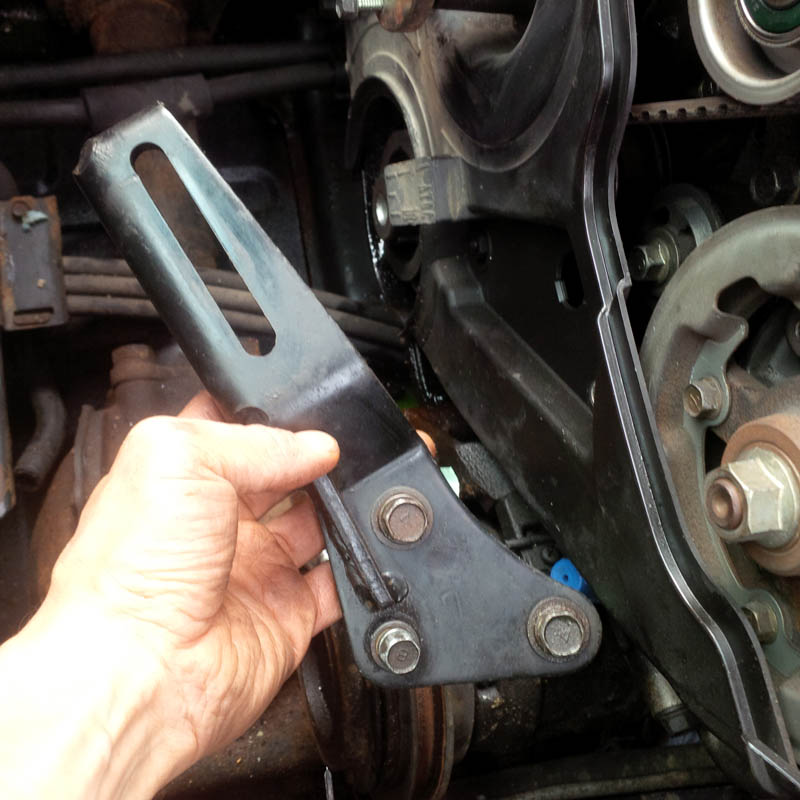

Remove the hoisting bracket at the front of the head.

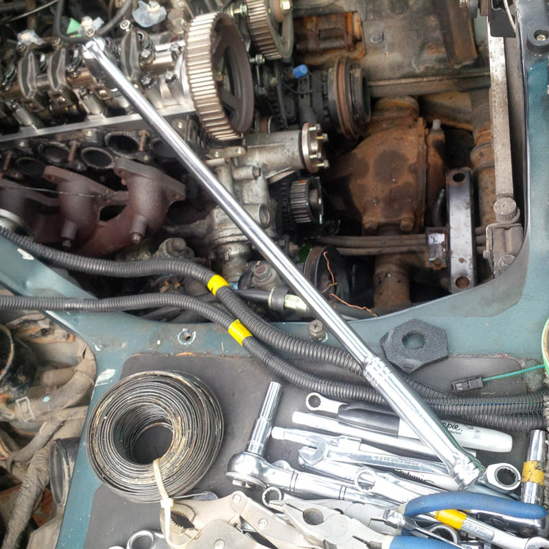

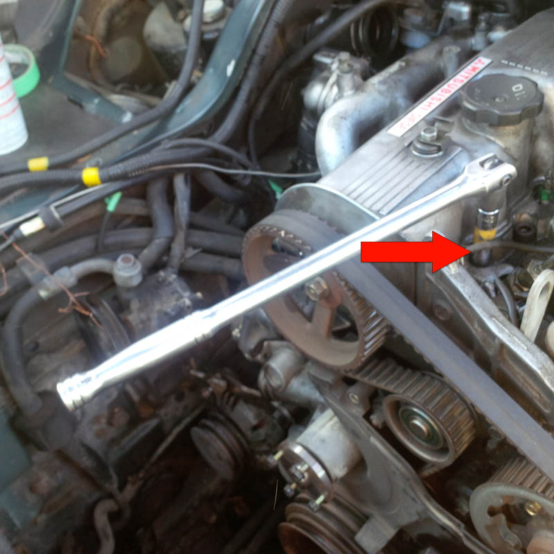

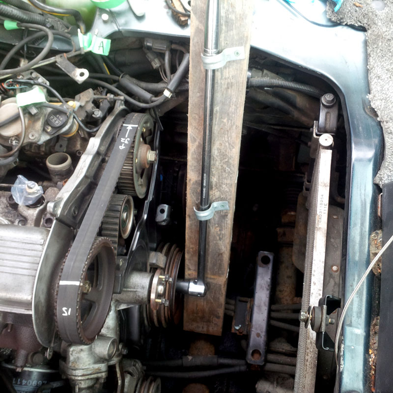

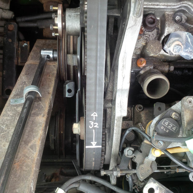

Well, I've put this off for long enough. Time to finally remove the crankshaft pulley. There are a few ways to do this. If you have the proper tool, then by all means use it! I've decided to do the starter motor blip method. Remove the glow plugs (if you are really paranoid like me) reattach the battery leads, put a long breaker bar and impact socket on the crank bolt, then turn over the starter motor for a fraction of a second just to get it to turn. You DO NOT want compression ignition due to a bit of fuel being left over in the system cause that would be bad m'kay.
Here is a picture of my setup. I took a piece 2 x 4 and attached the breaker bar to it. My thought was that if something fails, it won't fly around the inside of the van and puncture something, like me. The 4D56 is a clockwise turning motor, so ground your breaker bar on the passenger side. Crank turns clockwise, bolt stays put, that's the theory.

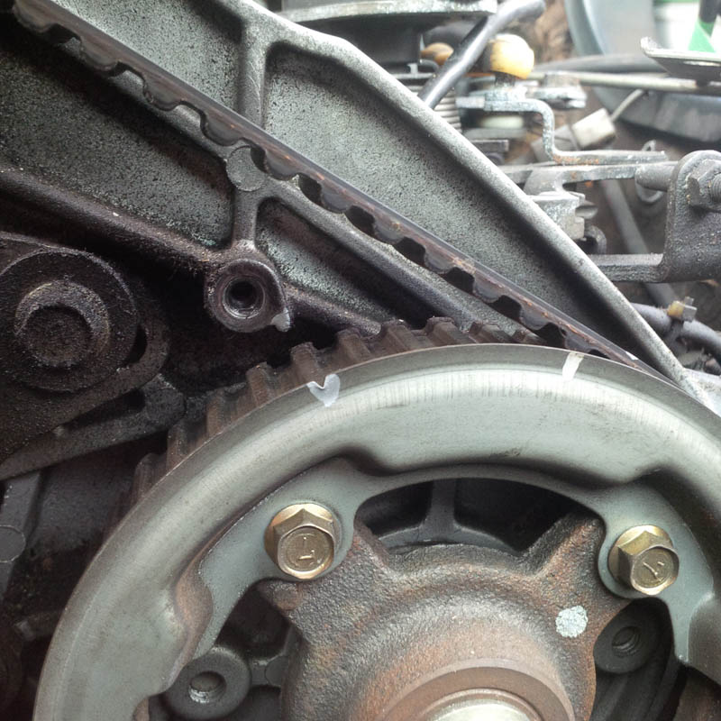

Something I should add. Before removing the crank pulley I counted teeth on the timing belt. This will just help to verify that I've got it right upon reassembly.

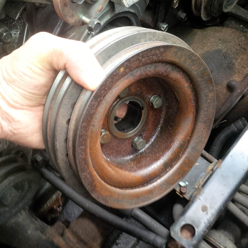

Et voila! Crank pulley bolt came loose! Then removed the pulley. Mine was snug, but I could still pull it out by hand. If yours is stuck then you'll have to use a puller tool.

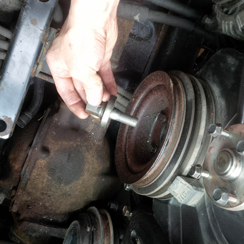

Now replace the crank bolt just finger tight and rotate the motor back to TDC (top dead centre) and the arrows will align on the cam pulley and injection pulley. Then remove the crank bolt again. Always turn the motor from the crank in a clockwise direction only, never turn it from the injection pump or camshaft pulley.

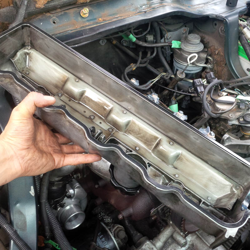

Remove the valve cover.
And there you have it. Ready to take off the head, well almost.

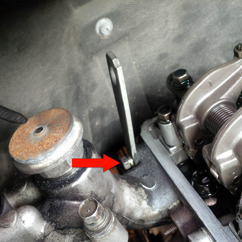

Remove the other hoist bracket at the back of the head, drivers side.

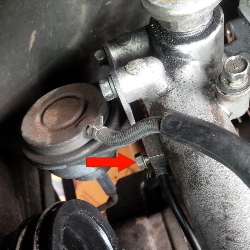

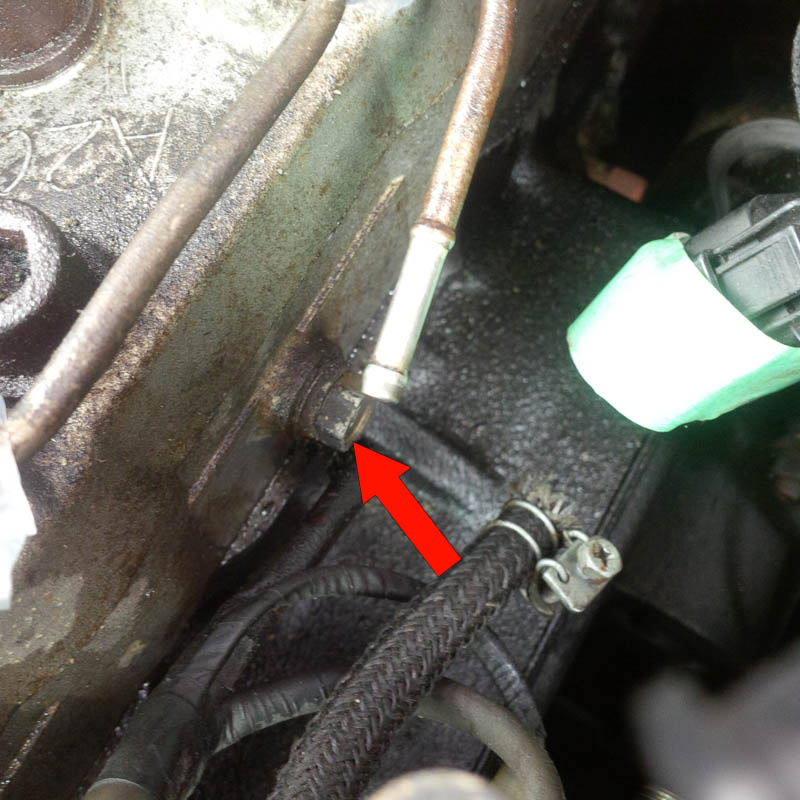

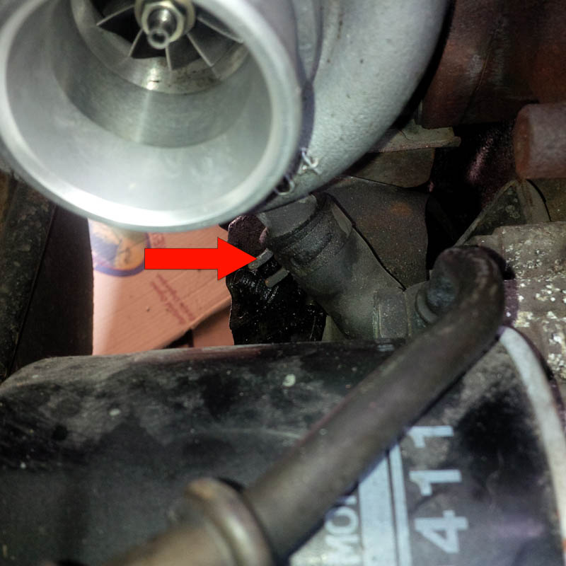

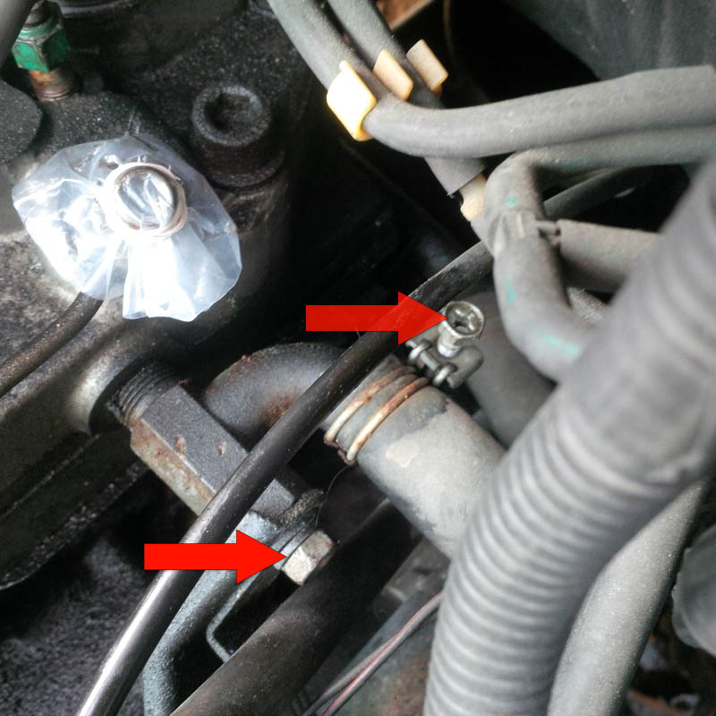

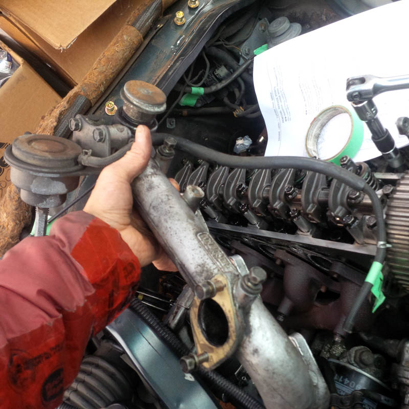

Detach the oil line from the turbo by undoing the bracket on the intake manifold and following the line to the back of the head where there is a hard to get at connector. I got in there from underneath. As you can see from the photo, the infamous half moon seal on the back of the valve cover was leaking oil back there. This will get fixed on reassembly.
Remove the intake manifold by undoing the two bolts to the turbo. You'll have to get under there and remove the split pin that holds on the linkage for the turbo waste gate.

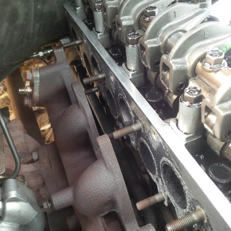

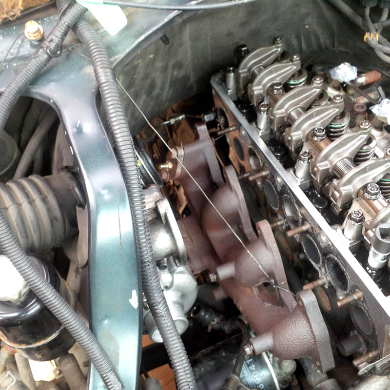

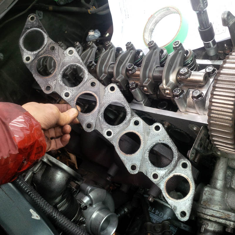

Pull the exhaust manifold to the side and remove the gasket.
Then wire the manifold to the side of the engine compartment, pulling it out of the way.

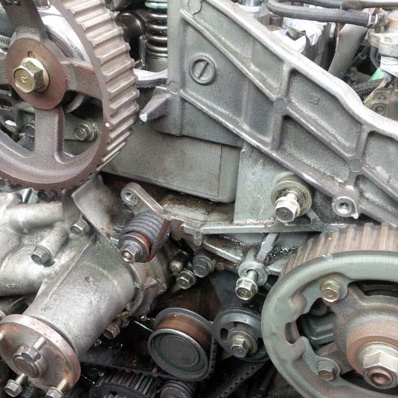

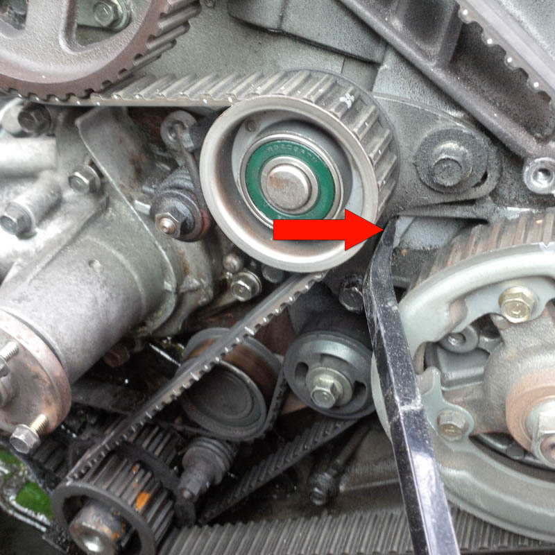

Back to the front of the motor to remove the timing belt tensioning pulley and bracket.

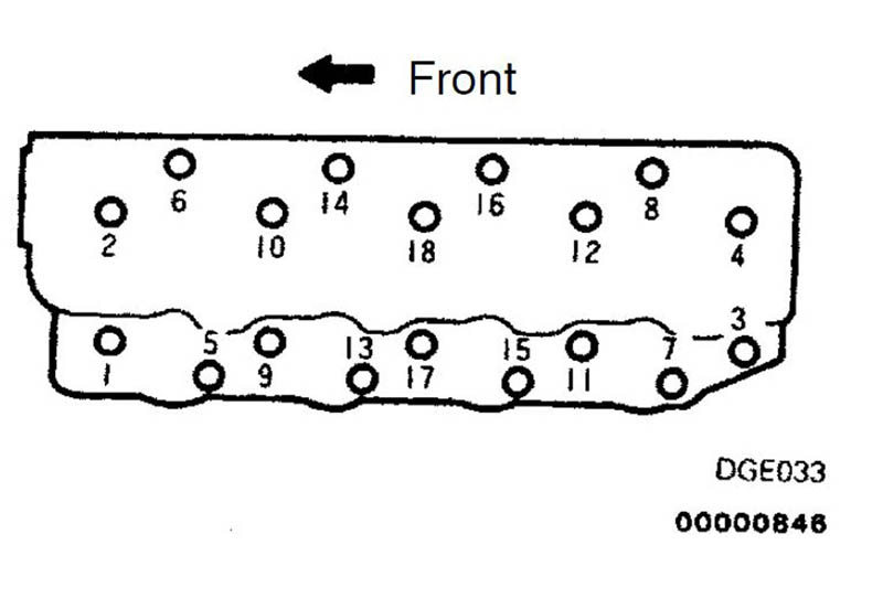

Here are a couple of images of removing the head. It required the longer breaker bar. The bolts were under a lot of torque, and some were stubborn. Just make sure that your 10mm hex head socket is well seated in the head of the bolt. Corrosion might cause the hex to lift and this will round out the fastener. Also, do yourself a favour and buy a high quality hex head socket. Follow the pattern laid out in the service manual, attached below.
This is the pattern for disassembly. It's the opposite pattern for reassembly.

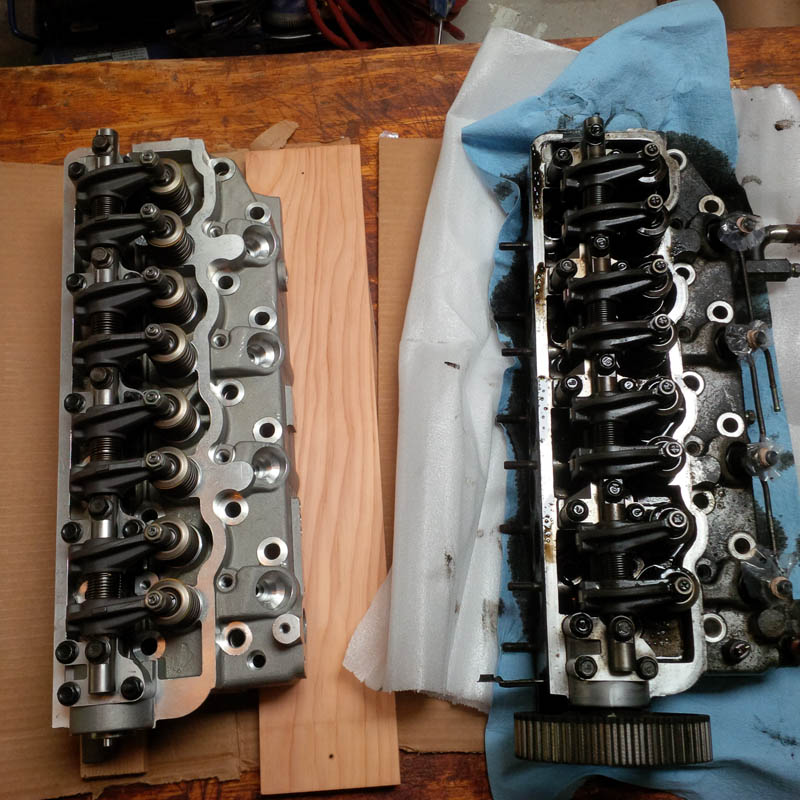

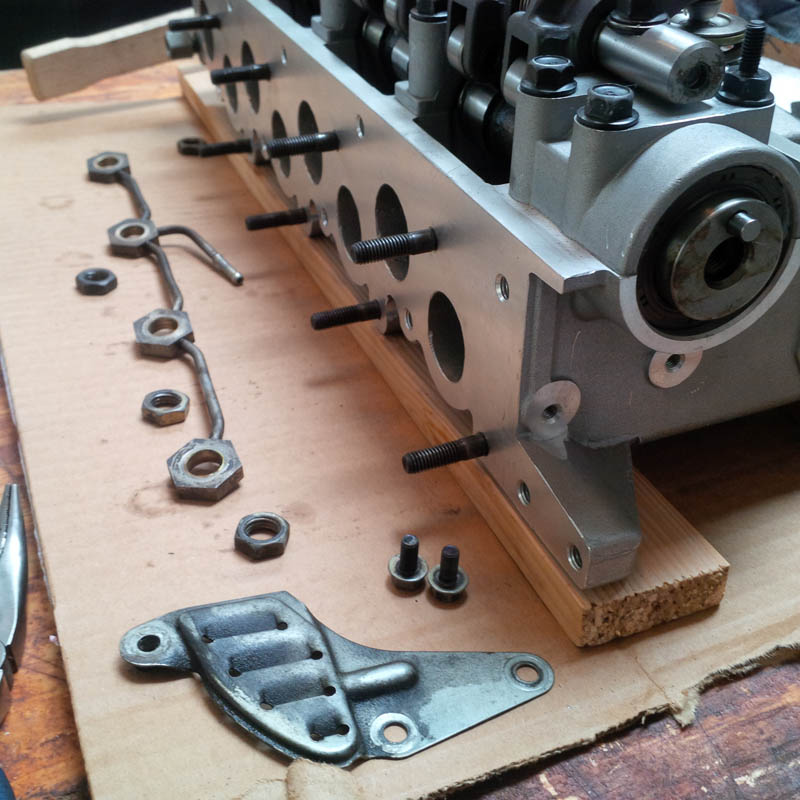

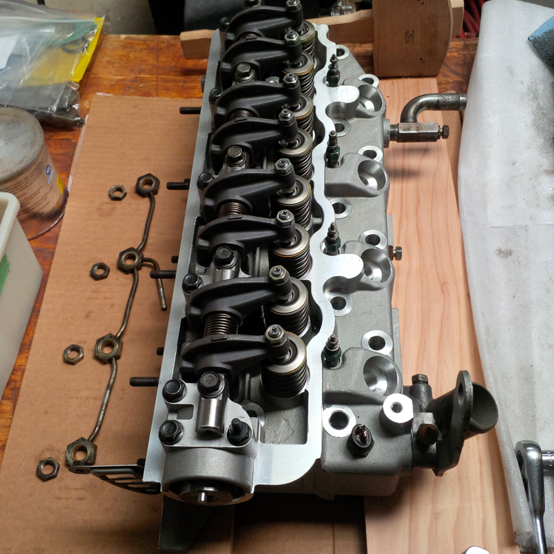

The new head and the old head are laid out on the bench and I've started to transfer all the bits and pieces. If you've got a 1993 or earlier head with protruding valves like I do, then raise up the head on blocks of wood to avoid damaging the valves.

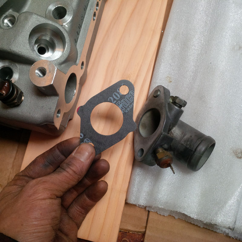

New gasket for the coolant outlet fitting.

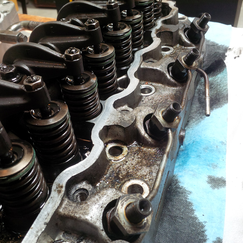

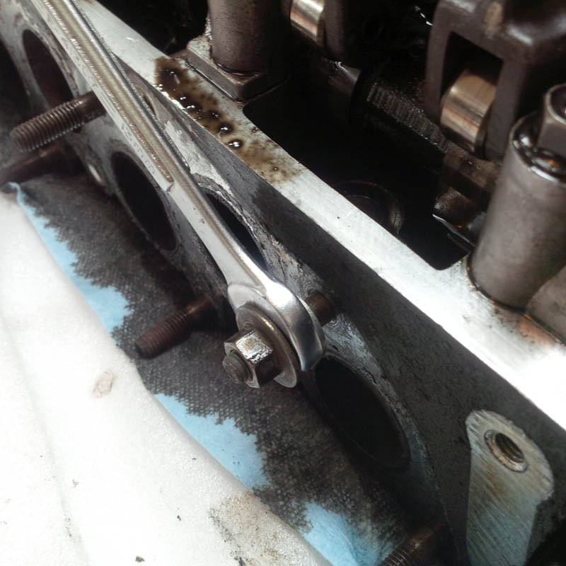

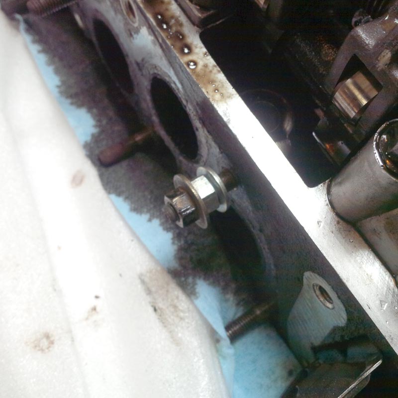

The exhaust studs are a little finicky to remove. Either buy some fresh ones, or remove the old ones using two M8 steel nuts. DO NOT use the nuts that came off of the studs as they are soft metal and will fail. Spin both nuts on and tighten them against each other, then reverse out the stud using the inside nut. Some of the studs were really stuck in there, so again I just soaked it for a day with the penetrating oil and eventually worked them loose.
Removed the return fuel rail.
And this is where I'm at. Reattached the glow plugs, sheet metal shield on the front, temperature sensors, tapered oil fitting on the back, heater pipe on the passenger side, and ground bolt. Going to pause for a few days as I've ordered some waterjet cut parts for a combination cam and crank pulley tool that I'll be using for reassembly. If it actually works, then I'll post all the design files and drawings for y'all.

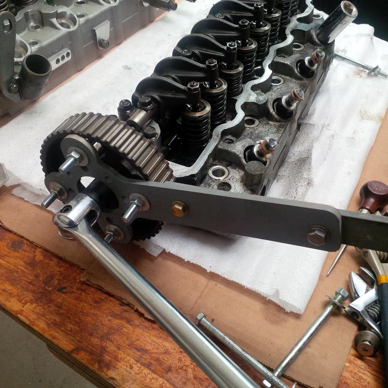

It's been a few weeks, but winter came back so I had to go and sample some powder in the backcountry! Also, some waterjet cut parts came in the mail and I sourced some fasteners and assembled my custom L300 crank/cam tool. Now to test it out...

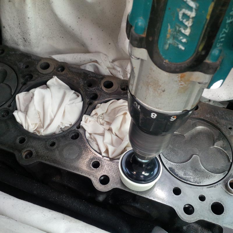

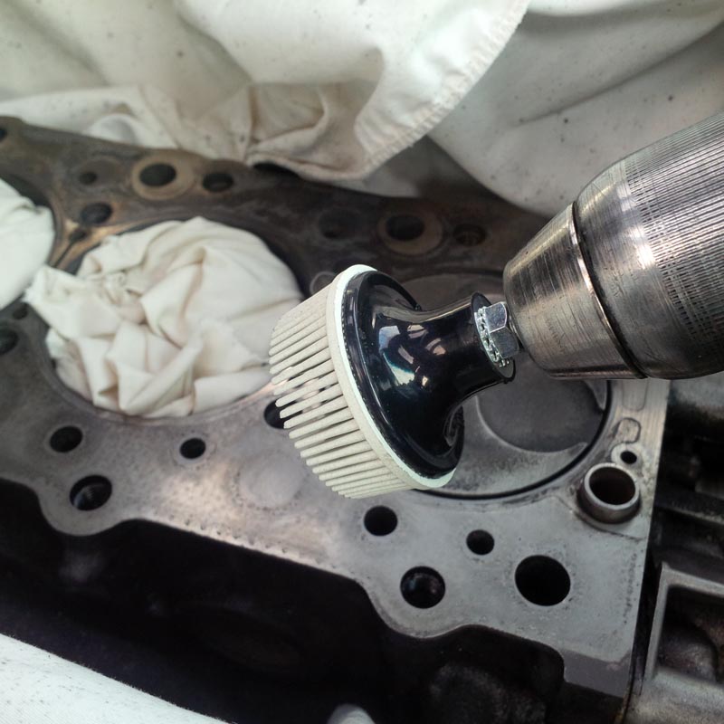

First, back to the block to clean up the mating face with a 3M Roloc, 120 grit, 2" bristle disc #07528
These will work on steel, but if you are polishing up aluminum then be very careful not to dig in to the metal. Clean off any residue with brake cleaner.

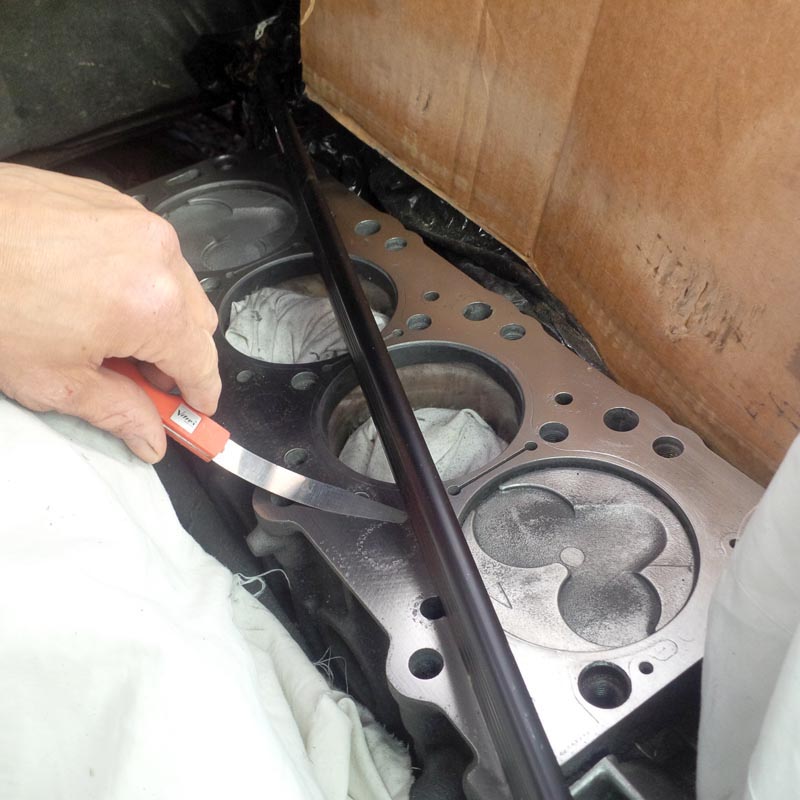

It does a fine job of cleaning, and I'm happy with the look of the mating surface. Note the area around the fire ring needs to be perfectly smooth with no pitting as in this photo. If it's badly pitted, then you're pulling the block and having it decked at a machine shop.
Check to see if the surface is perfectly flat with a high quality straight edge (I'm using the Veritas one from Lee Valley) and a feeler gauge. I couldn't get a 0.001" feeler under the ruler, so I'm happy about that.

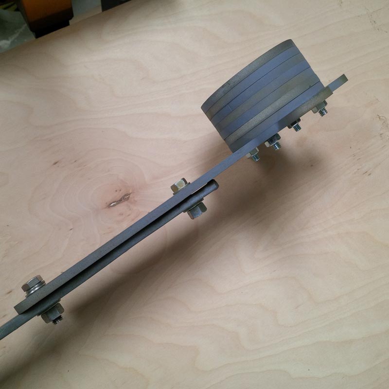

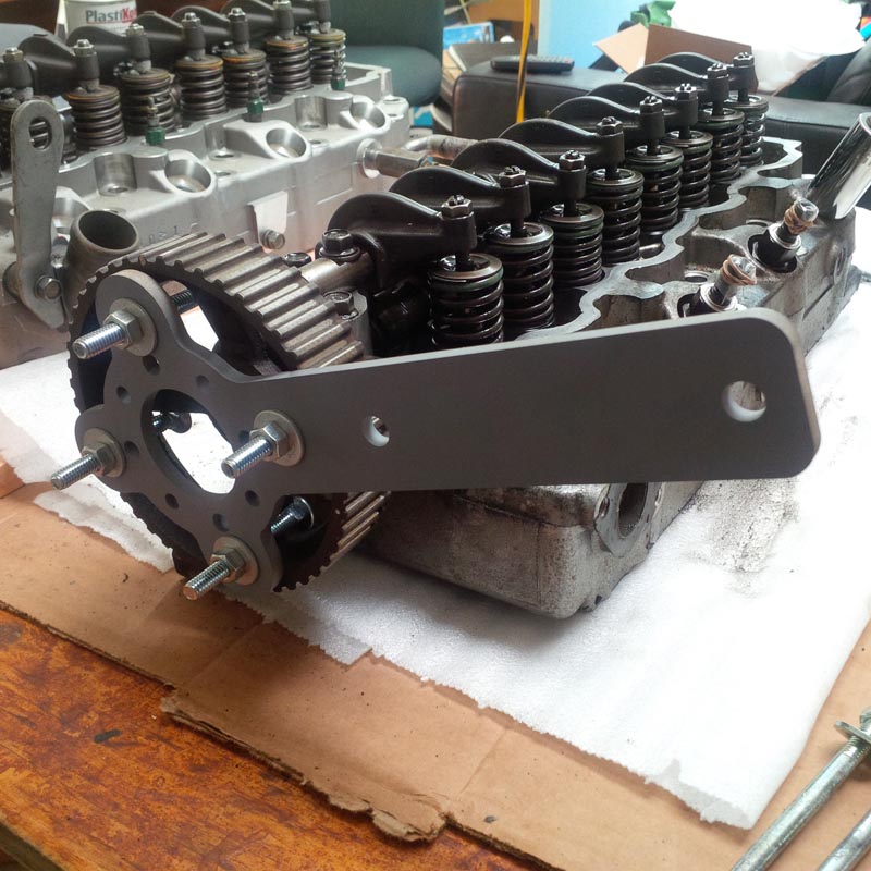

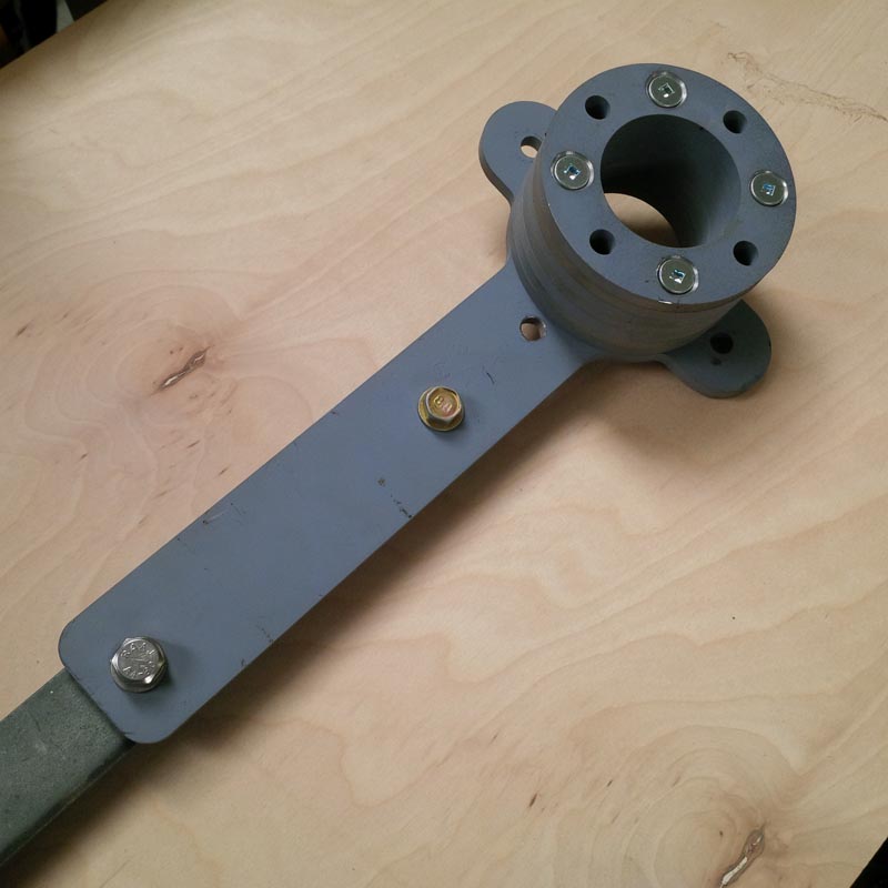

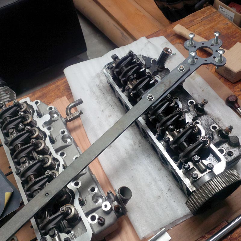

Back to the head, and I assembled my cam and crank pulley removal tool using 4 of 2.5" long, 1/4"-20 carriage bolts and it looks like this:
Then attached a 30" long steel bar. NOTE: The cam pulley can be removed while the head is still on the vehicle!

Crack loose the cam pulley bolt, it takes quite a bit of force unless of course you have a rattle gun.

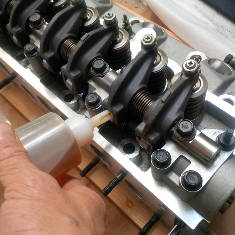

Dabbed some oil on all the moving parts on the new head. This will help during initial start-up.

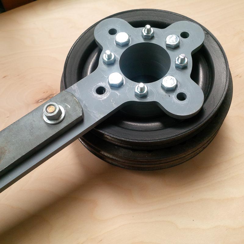

I also had seven 1/4" discs made which I stacked together and fastened to the cam tool to convert it to a crank tool.
Test fit it to the crank pulley. Looks like it should work, and if it does I'll post up technical drawings and a DXF outline so you can fabricate your own. I'll be the guinea pig.

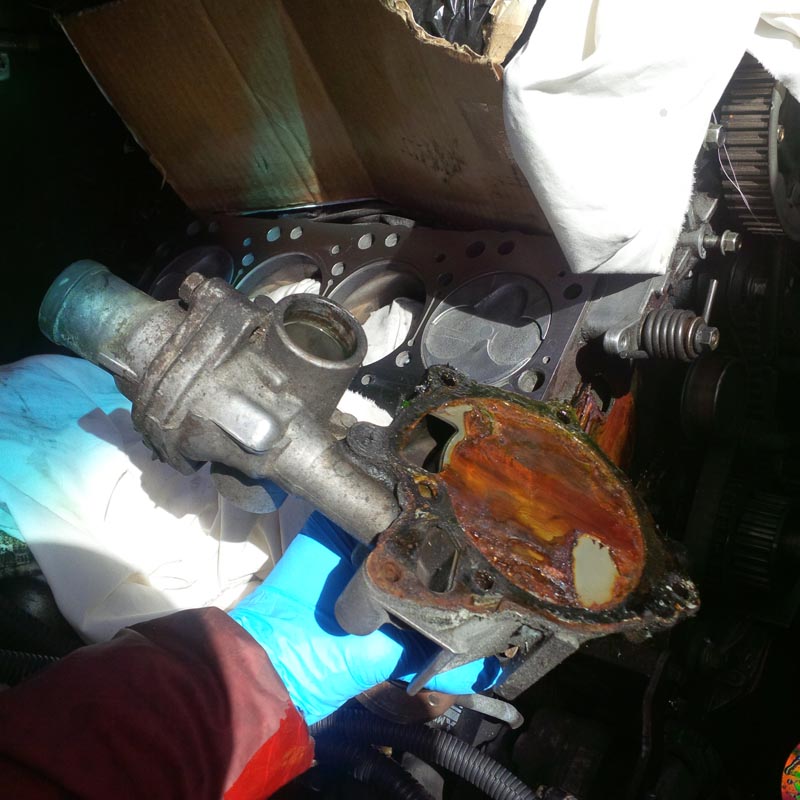

Removed the water pump, gross. Cleaned up the mating surface.

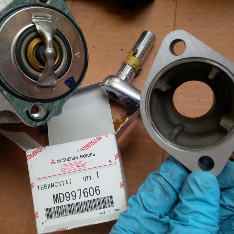

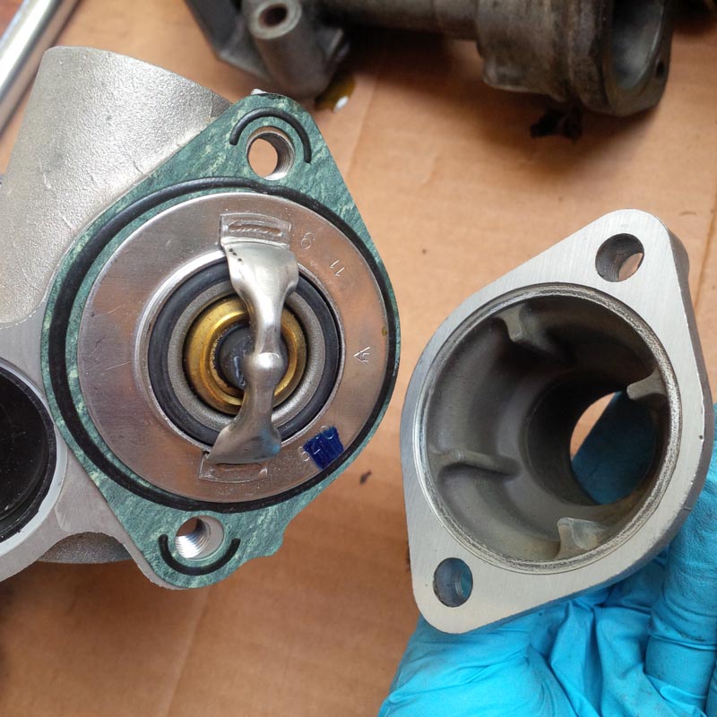

Move the inlet pipe over to the new water pump and replace the thermostat and gasket. Using an 82 degrees Mitsu part. Torque to 15 Nm or 11 ft lbs.
