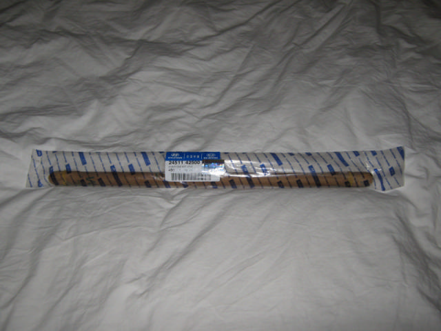

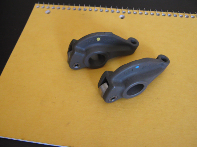

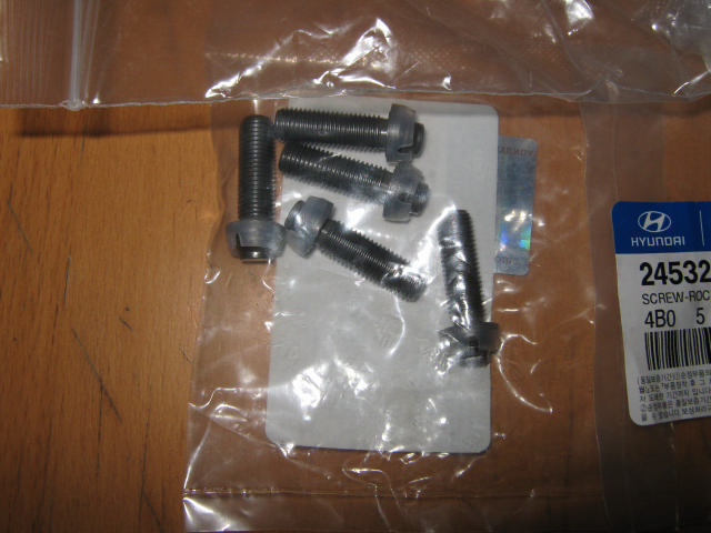

You can get new rocker arms , rocker arm adjusting screws, springs, shaft locally.
Shop can do this job around 3 hours including R/R valve cover gasket, bolt seals and semi circular packing.
From our experience, it will be desirable to do this including valve adjustment every 5-10 years for major tune up.
We do this all at $590 including new Hyundai OEM parts, FYI.
Steven
Steven
