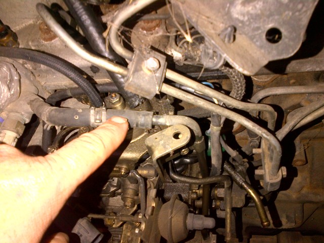

Ok, here's where the first coolant line attaches to the IP with a banjo bolt

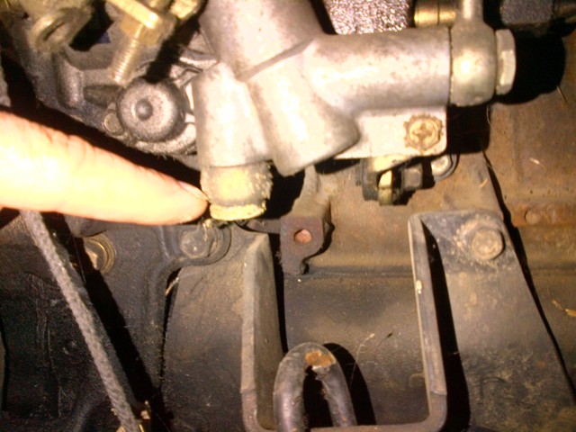

And here is where the rubber coolant hose attaches to it

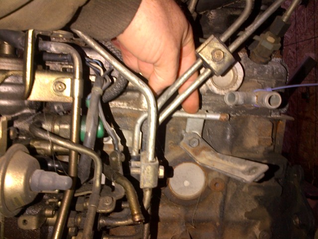

Here is where the other coolant line attaches to the IP, also with banjo bolt

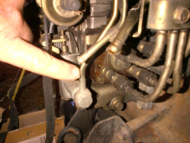

And here is where the other rubber line would attach.
Use a pair of hose pinchers on the two small rubber coolant lines, and remove them from the IP. Then try and blow through the steel lines, you should be able to blow in one, and about a tablespoon full of coolant will come out the other line. If you cannot blow through it, you have a clogged line, remove the banjo bolts holding the steel lines on, and remove, and clean out the steel lines. Use an ultrasonic cleaner if you have access to one, or soak in some CLR. Hope you can follow this. If it is still unclear, let me know.
