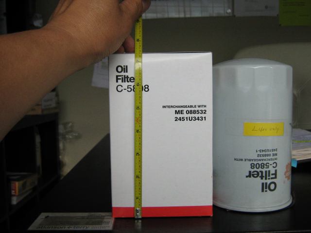

FYI, we carry Sakura oil filter for L400 at $27 each.
Its length reaches 7.40 inch.
Steven
L400 sakura oil filter length (2).JPG (66.54 KiB) Viewed 8607 times

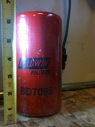

I get my oil filters from Acklands Grainger and just tell them I work for canfor and I get Baldwin filters for 15.08 each and its the large filter.
part #BD7095 for the 4M40 motor delica and Pajero
Baldwin filters are very good quality
Joe
