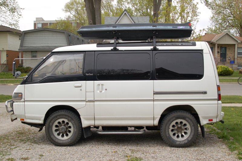

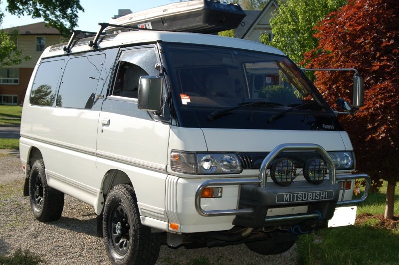

Today I installed a rooftop carrier that I purchased off Kijiji for $80 about a month ago. It's a Thule 250 that was in great shape. I already have the Thule 1050 feet and load bars from the ski rack WE USED TO USE :-( (when we lived in a place where there were actually mountains... a.k.a BC).
carrier installed.jpg (123.2 KiB) Viewed 20341 times
carrier installed2.jpg (112.76 KiB) Viewed 20341 times

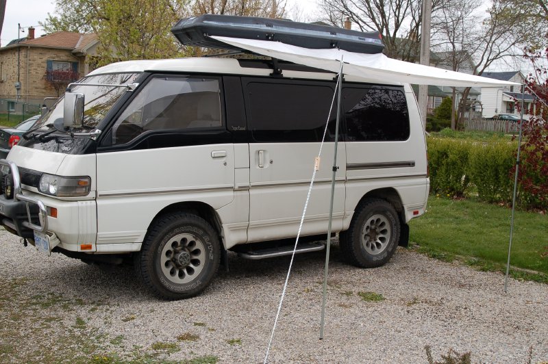

A couple week ago I came up with an idea that I haven't seen anyone do yet. So either i'm the only one to actually go through with it or people have thought of it and i'm just an idiot for actually doing it :shock: (hopefully not the latter).
Ghetto Awning!!

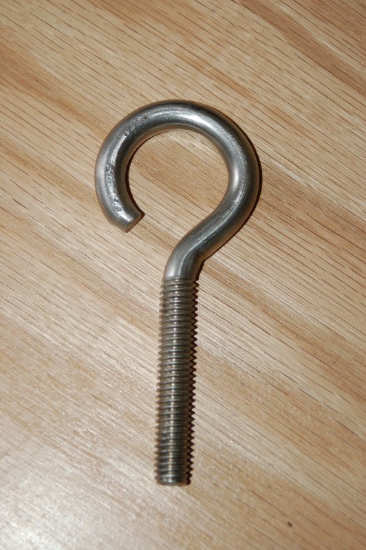

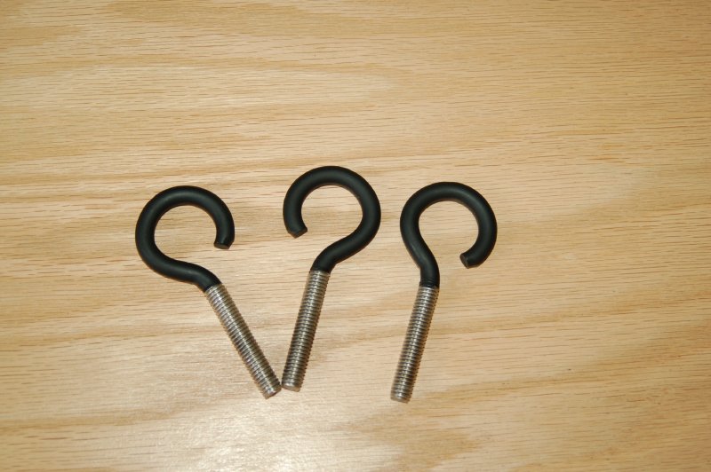

I found some hooks at a local fastener store
hook before.jpg (82.48 KiB) Viewed 20337 times
The opening wasn't wide enough for the gromets so we cut them a bit
hook cut.jpg (104.62 KiB) Viewed 20337 times
Then we painted them black so they wouldn't stand out too much from the carrier
painted hooks.jpg (77.61 KiB) Viewed 20337 times

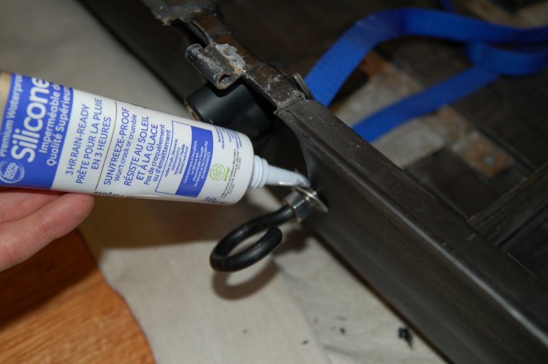

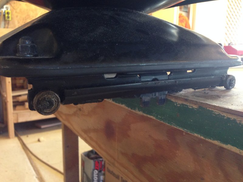

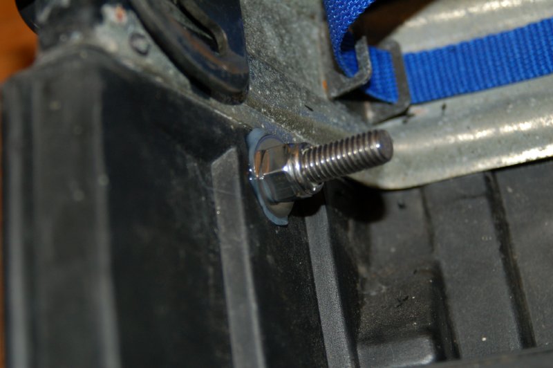

I installed 4 anchor points into the bottom of the rooftop carrier. Installing into the bottom will allow us to still access the carrier if we have the awning set up.
hook with silicone.jpg (54 KiB) Viewed 20337 times

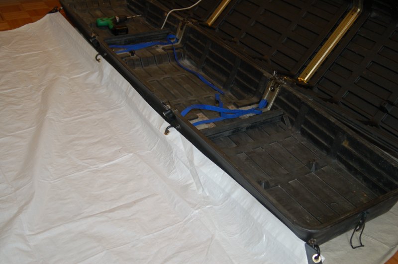

Used a 6x8' white tarp. We don't need it to be too big, we just want the area of the sliding door covered if it's raining. We chose white because if it is a cloudy day it should still let some light through. And it matches the van and makes it less ghetto-like (if possible).

Ghetto Awning Continued...
We bought two adjustable tent poles from CT
awning poles.jpg (81.67 KiB) Viewed 20337 times

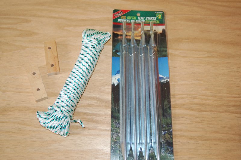

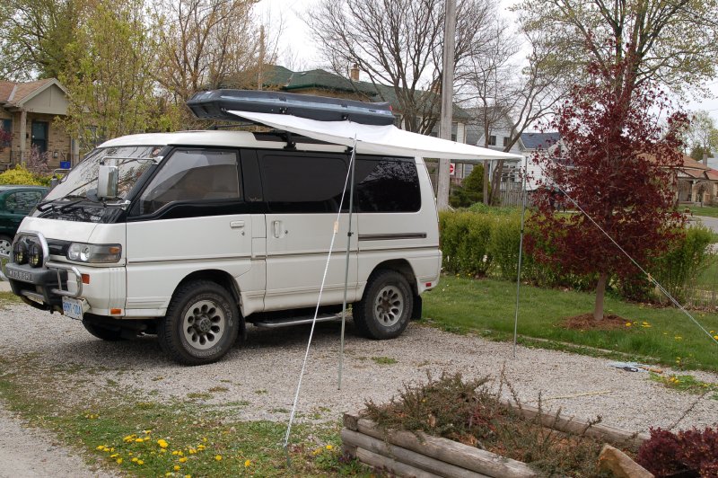

Then we also bought some rope and tent stakes. We made two little sliding blocks to adjust the tension on the ropes.
We measured the distance between the gromets and installed our anchors accordingly. Here is the test fit.
test fit.jpg (61.08 KiB) Viewed 20337 times
And again here it is, the first (I think), Ghetto Awning.
awning set up2.jpg (154.15 KiB) Viewed 20337 times

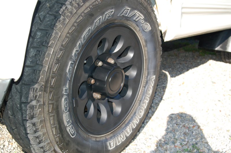

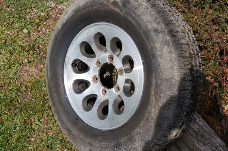

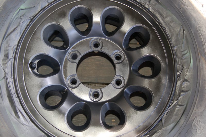

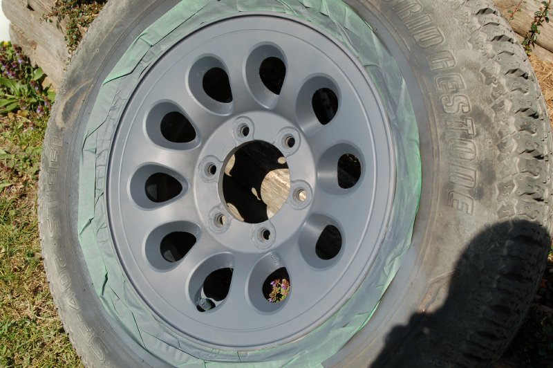

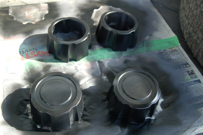

So this week I painted my rims. I started this project about 3 weeks ago with my spare. Then I went on to do the other 4 rims but I couldn't get the lug nuts to budge. So then I waited another few weeks to get an air compressor and power tools from my brother-in-law, BUT THAT DIDN'T WORK EITHER :shock:
Craig (bonsai rides) finally came to my rescue. I was over at his place helping change some fluids on his Delica, and he had a breaker bar that FINALLY worked.

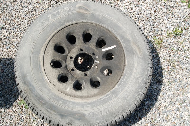

I had never taken my spare down before, this is what it looked like. Probably didn't even have to paint it :?
dirty spare.jpg (151.13 KiB) Viewed 20244 times
Here it is cleaned up.
clean spare.jpg (136.74 KiB) Viewed 20244 times
I primed them first.
Then painted.
painted spare.jpg (92.66 KiB) Viewed 20244 times
Painted the hubs too.
painted hubs.jpg (64.31 KiB) Viewed 20244 times
Here is what I used.
dupli color.jpg (50.47 KiB) Viewed 20244 times
Done. Got a little overspray on the tires, but I'm sure it will eventually wear off.
close up.jpg (86.02 KiB) Viewed 20244 times

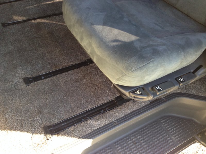

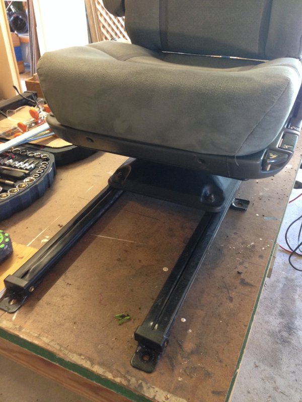

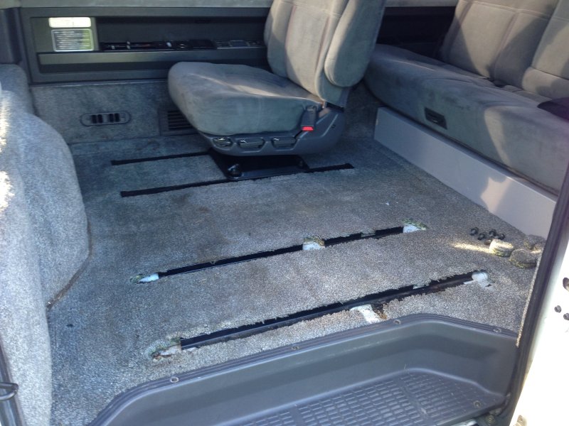

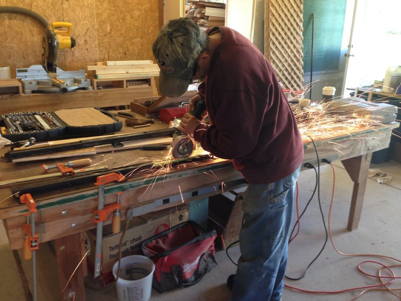

This weekend I thought I would attempt the "Captain Chair Removal Mod" on my L300. I got the idea from Artacoma (http://www.delica.ca/forum/l400-captain ... 13005.html) who got the idea from RichD. Not sure if anyone has done it on a L300 yet. Turned out great! We wanted to sacrifice a little sleeping space for some more "living" space.
I removed the captain chairs with tracks attached.
seat removed with tracks.jpg (96.82 KiB) Viewed 20022 times
seat with tracks.jpg (85.95 KiB) Viewed 20022 times
I then removed the seat from the tracks.
seat out of tracks.jpg (67.03 KiB) Viewed 20022 times

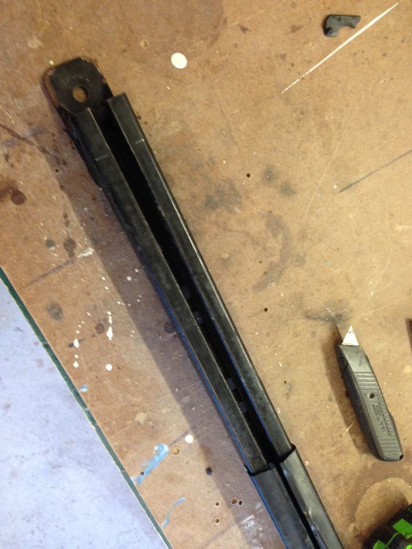

Measured what I needed to notch out. The smallest I could go was 10 3/4".
tracks measured.jpg (88.73 KiB) Viewed 20022 times
Then started cutting. I let my father in law do the first one.
cutting tracks.jpg (101.37 KiB) Viewed 20022 times
Re-installed the tracks.
tracks cut and reinstalled.jpg (107.63 KiB) Viewed 20022 times
Finished...just needed to drop the seats in.
seat reinstalled.jpg (102.75 KiB) Viewed 20022 times
I didn't get a chance to cut wood blocks to fit into the notch but I will do that shortly.

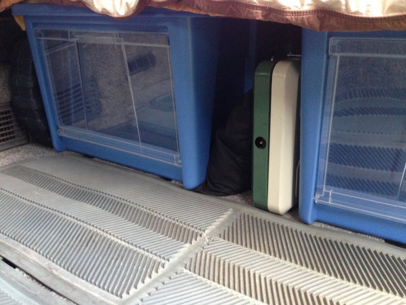

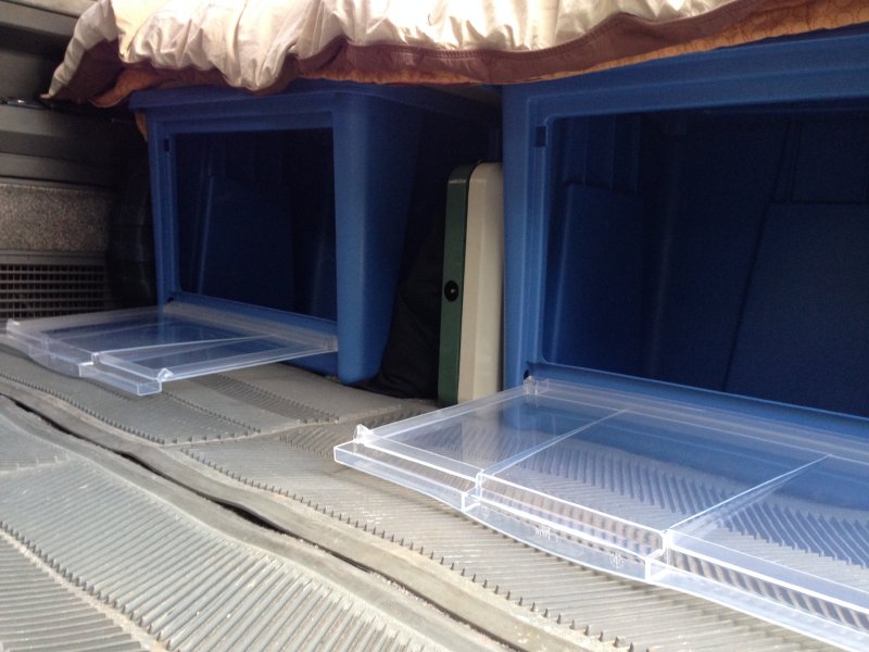

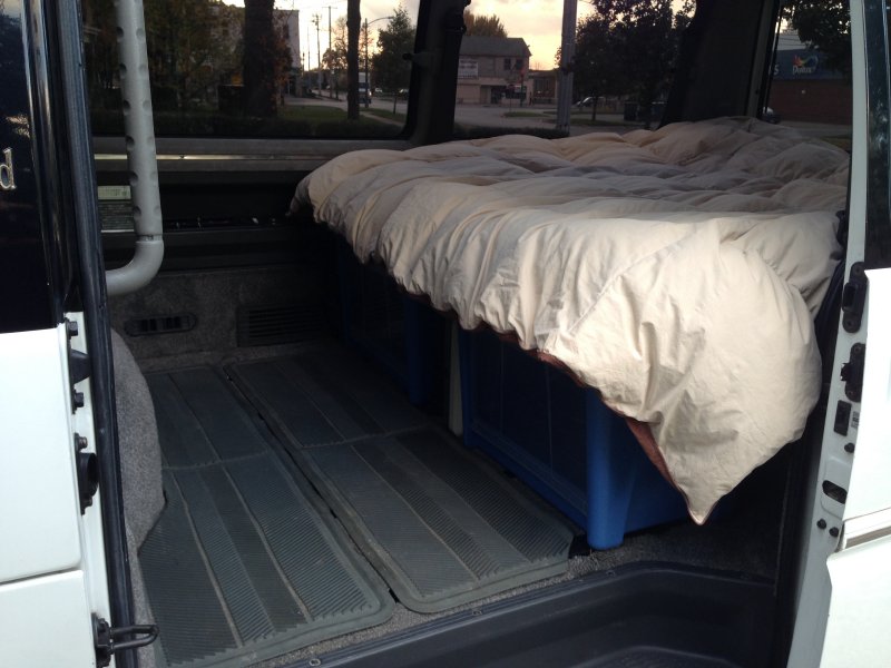

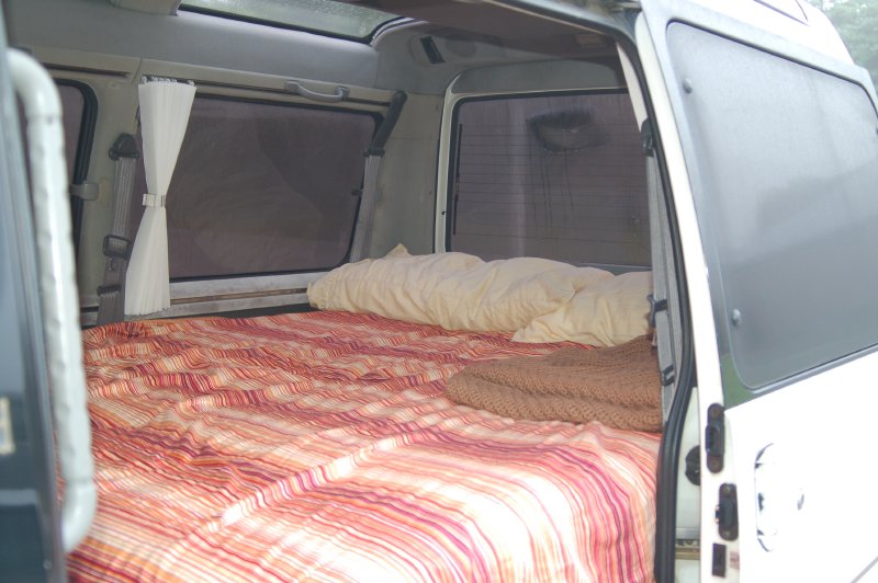

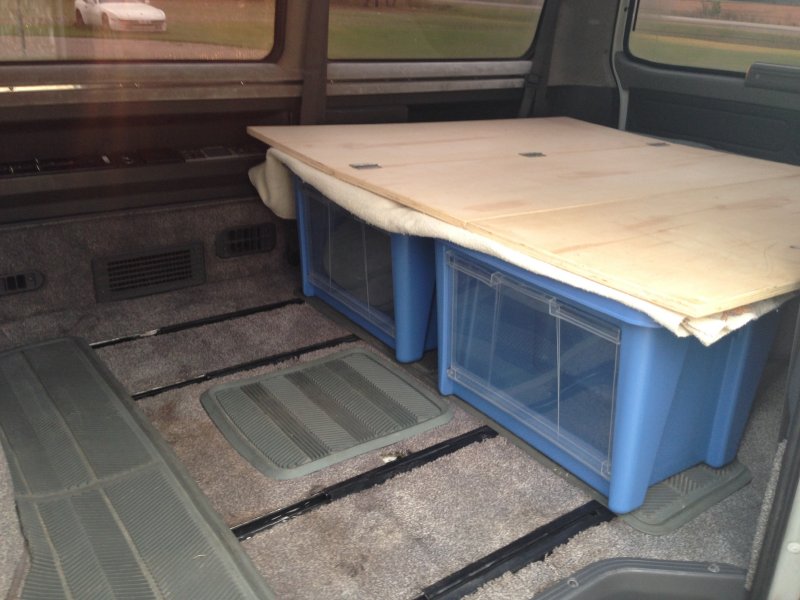

The reason we did the "Captain Chair Removal Mod" was to free up some more "living" space. Our bed used to take up pretty much the whole van. We had maybe 12" between the foot of our bed and the engine hump.
This is what our bed set up used to look like. Yes, it was very comfortable for sleeping, but it felt really crowed when trying to do anything else. Especially get dressed.
cooler shelf.jpg (89.66 KiB) Viewed 20021 times

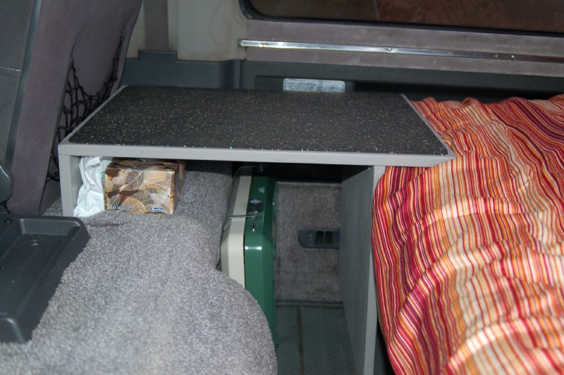

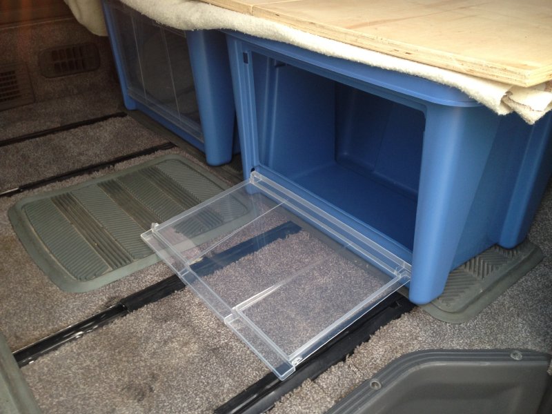

Now that we can easily take our captains chairs out we can make our bed a little smaller and free up some more space.

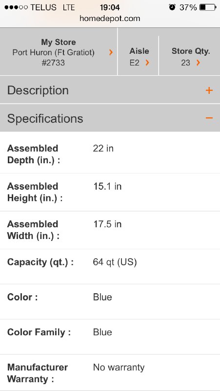

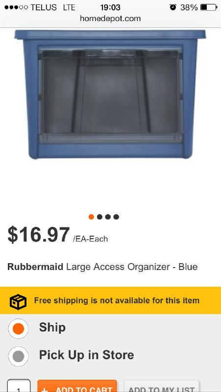

We also found these really cool Rubbermaid bins at Home Depot in the States. They have an access door on the front so we won't have to move them at all to get into them. They will also support the foot of the bed (not much weight). We think we will probably use one for dry food storage and one for dirty laundry. We're not too sure yet.
We will probably pull the bins a little more forward. We haven't decided on our new bed size yet. Pictures are pretty bare. I didn't have time to put the mattress out and get it all set up. This was just a quick test run.
revised bed with more storage.jpg (76.15 KiB) Viewed 20021 times
new bins with access doors.jpg (92.57 KiB) Viewed 20021 times

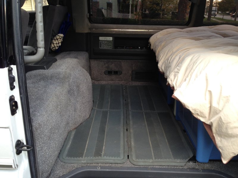

We were able to get one more camping trip in before winter. This is what our new set up looks like now. We have so much more room now.

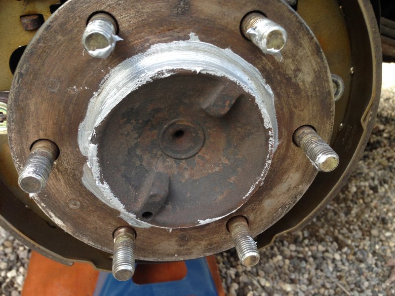

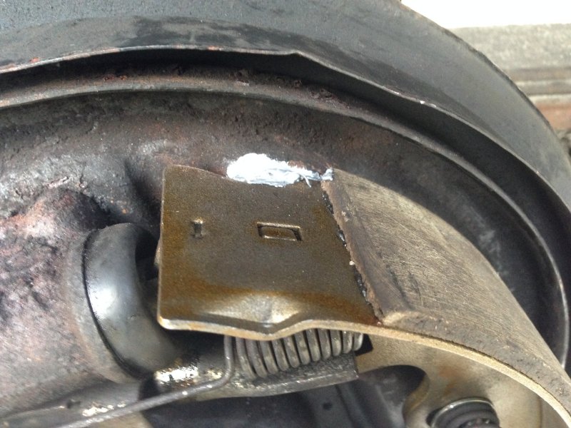

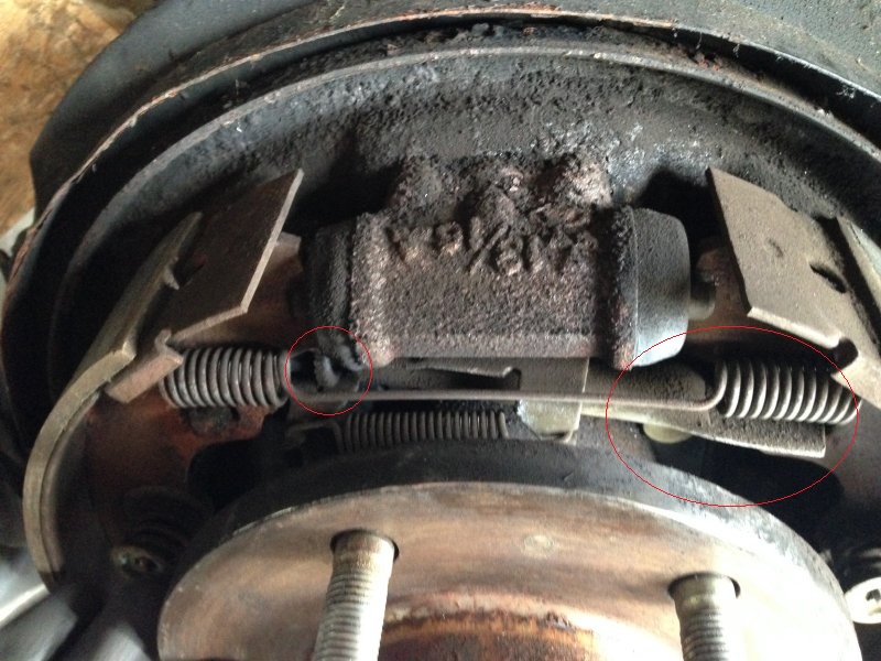

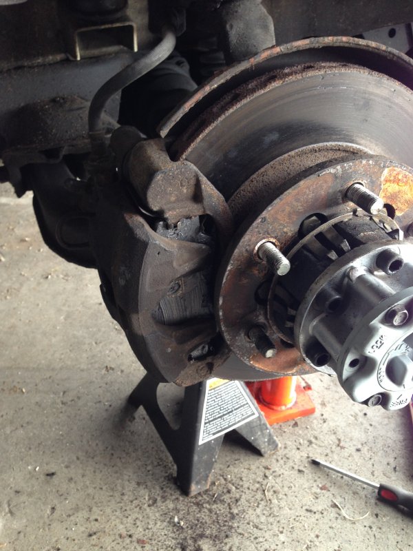

Replaced the front brake pads and rear brake shoes. Thanks to Craig (bonsai rides) for giving me a hand.
Before installing the new shoes, make sure you screw the "fork" on a bit (big circle...not sure what's it's called). It makes adjusting the shoes easier. Be sure to adjust the shoes (small circle) so that you can barely get the drum on. This will put the shoes close to the drum therefore needing less pressure on the brake pedal to stop.
pad adjustment.jpg (157.56 KiB) Viewed 19957 times

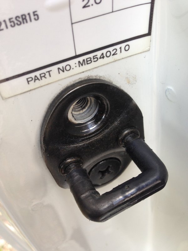

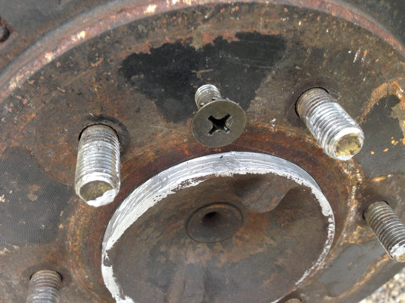

If you're really in a pickle trying to get the drums off...like we were, we discovered that the bolt from the front door fits PERFECT!
hinge bolt.jpg (55.42 KiB) Viewed 19957 times
easy drum removal.jpg (104.01 KiB) Viewed 19957 times
And don't forget to add some anti-seize so next time you need to remove the drums it hopefully won't be so bad.
anti seize.jpg (107.18 KiB) Viewed 19957 times

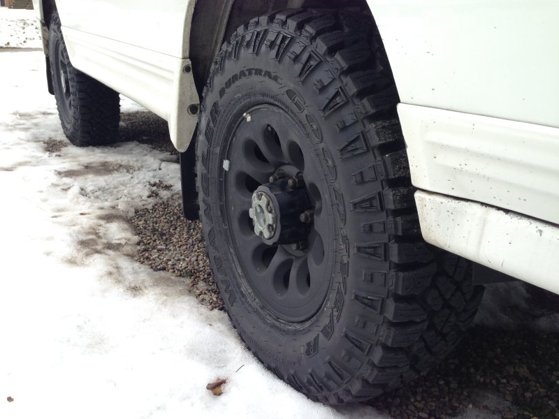

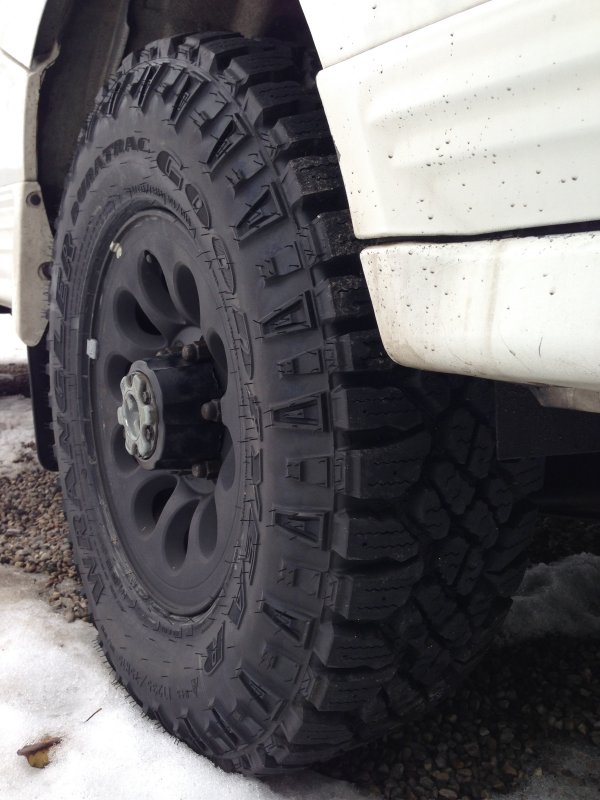

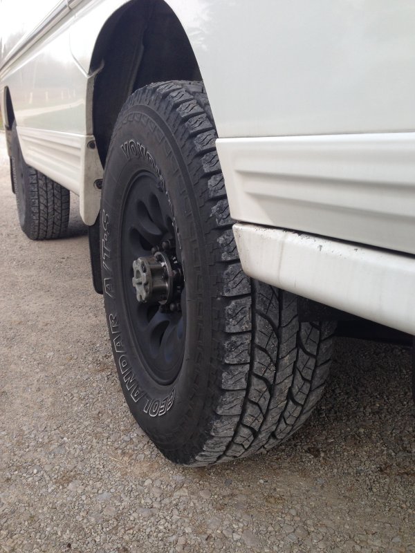

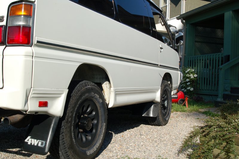

Finally replaced my 5 year old Geolanders for a set of Duratrac's
Out with the old...
Old Geolander.jpg (99.39 KiB) Viewed 19941 times
In with the new...

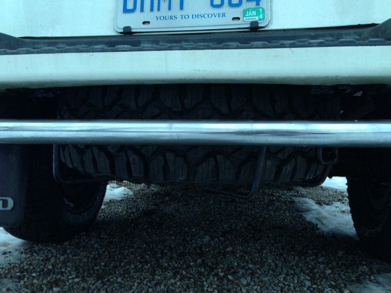

And a 5th Duratrac just incase :-) (actually I will do a 5 tire rotation every 10-15k to keep them worn evenly)
