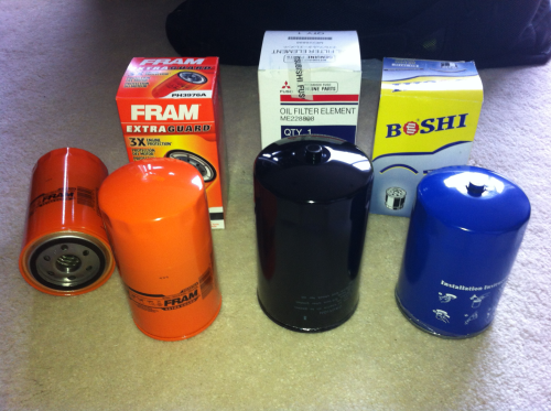

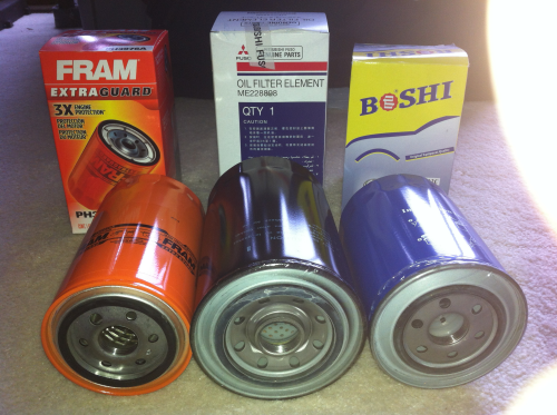

My Fram filters (at $5.99 each!) arrived today. Here are some comparison photos.
The Genuine Mitsubishi, is obviously the largest, it is also the most massive by a large margin. If I can find a scale I will weigh them. The Mitsubishi filter even outweights 2 of the Fram filters, it is extremely hefty! The Boshi is heavier than a single Fram, but lighter than the Mitsu.
The plan is to use two Fram filters in parallel, and a bypass filter for the finer stuff.
