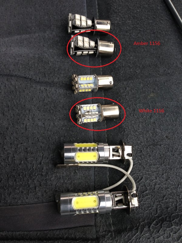

Did you ever figure this out? I just tried to install amber 1156's into the front side lights. Didn't do anything so I tried just regular 1156's. Didn't work either. All other LED's work just fine.nxski wrote:I just installed all of my LED light's today. For some reason the 1156 bulbs didn't work in the amber front side lights. Any idea why this might be?
These are the ones not working... I tried both amber and white.

Re: L300 LED bulbs?
The polarity is backwards. You should have bought error free bulbs. You will need to switch the 12vdc with the ground for these to work. I recommend getting a different bulb. Cree plus smd are mucho better and error free but that's just me. The basic smd bulbs are not that bright. You can test this by using a 9v battery. Attach the + to the end and - to the side. If it lights up then that's the polarity you need for your wiring. If it doesn't then - to the end and + to the side. It should then light up and that will be the polarity you need. If neither light up the bulb is garbage. If both ways light up they are error free.

Re: L300 LED bulbs?
They are supposed to be error free. I guess not since they work in the fog and turn signal (both types do).LeeHammy wrote:The polarity is backwards. You should have bought error free bulbs.

Re: L300 LED bulbs?
Yeah my Pajero was fine for all non error free except the side markers. For some reason they were backwards. Not sure why.
