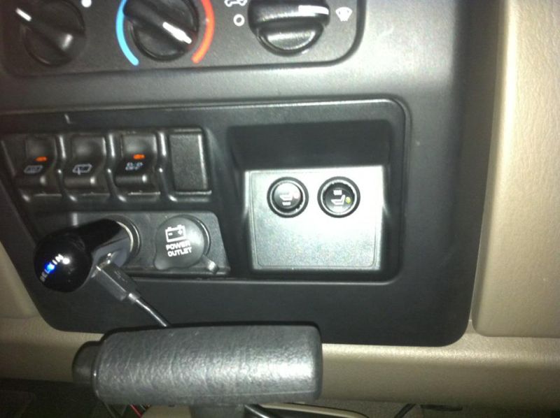

For those who are curious, here is a bad photo taken with my iPhone of the switches installed in the Jeep.
I used a stepped drill bit to drill the holes to ensure that the switches fit perfectly in the hole. I tested this first on a piece of garbage plastic to be absolutely certain I had the correct hole diameter for the switch, once I had that done, I put the switches in and used a little bit of krazy glue on the back to prevent the switches from spinning. (Even though they do have a bit of a tab on them, I glued them just the same).
Switches in the Jeep Console

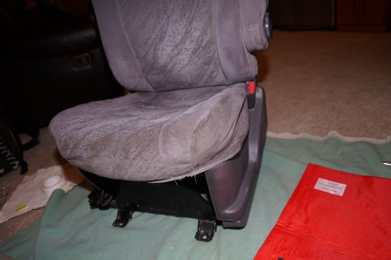

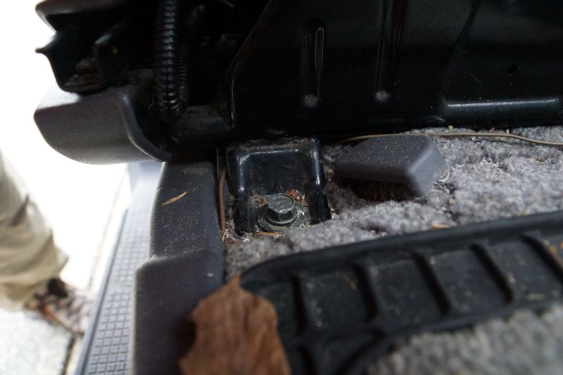

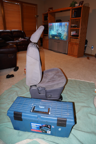

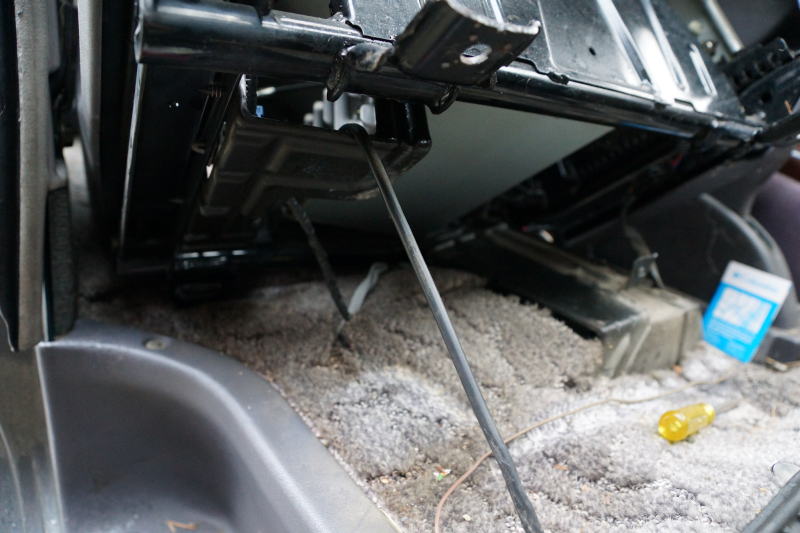

Ok, so I just got the drivers seat done, and after much agony and trial and error I got the seat pads in place. I took the drivers seat out before I began, which is what I would say is the normal best practice, taking out the seats and bringing them in the house to set them on carpet.
As it turns out, I had a nightmare getting the seat out, the old Karaoke amplifier under the drivers seat, plus lots of un named wiring everywhere made getting the seats out a chore, worse, as I put the seat back in, I stripped 2 bolts!
But, generally, it is easiest to do this kind of thing inside. However, I did not follow the normal procedure... In fact, I cheated.
So now I have CHEATED SEATS :-D :-D :-D
The pads are in place, but I have not had time to go through with the wiring. Figuring out how to do everything in a Delica specific way as opposed to the directions for the Jeep TJ took a bit of figuring out. In many cases I muscled through things and bent a few of the seat securing mechanisms. But it seems to have worked so far. I leave it up to you if you want to follow my directions, or do it the "professional" way as outlined in the Jeep tutorial. :)
First, if you feel the need to fight with removing the seat, unbolt all four.
Realize the need to clean your carpets as well...
Fight for an amazingly long amount of time with the millions of cables while you remove the old disconnected amplifier that you did not need in my case...
It also helps if your girlfriend is playing the new Skyward Sword at the time.
And bring the seat inside if you desire. (Although, I now believe you could do it in place with the brute force method I found).

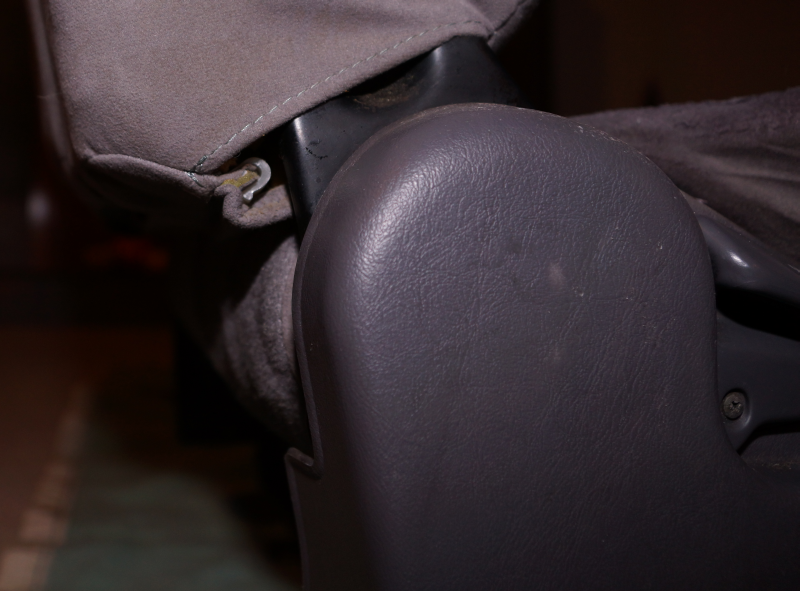

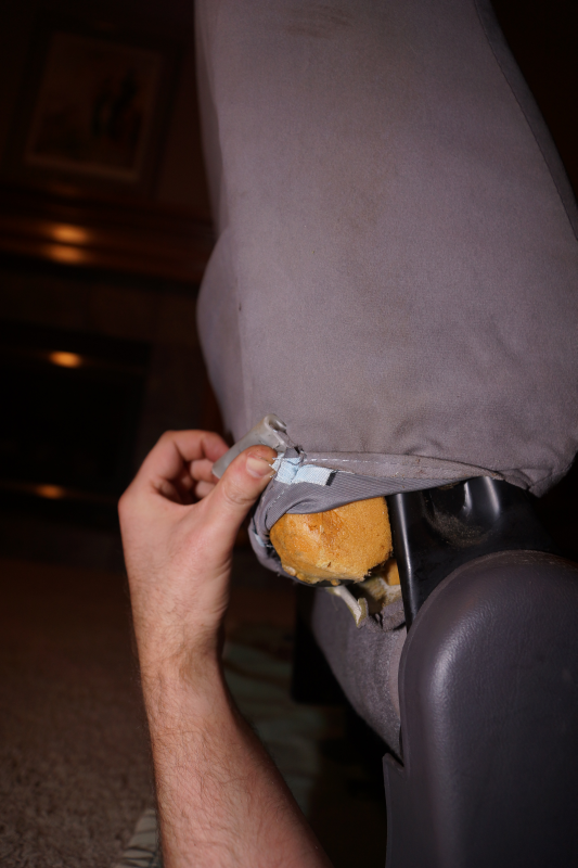

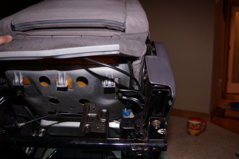

Looking under the bottom of the chair you can see one of the clips holding on the back of the seat. (You can access this WITHOUT removing the seat BTW)
The clip holding on the bottom seat fabric can be seen when the seat is upside down...
You can pull on it near the middle in two places to tug it off the side parts...
I pulled both ends off in this manner.
The middle part was more problematic, I ended up using the end of a crowbar as a "hook" to nudge the piece off... what happened in reality is that I bent that middle part all out of shape and ended up manhandling the plastic bit right off the seat! Not the best way, but it worked... after I bent the metal back into place...
I then pulled hard at the front of the seat, pulling down to detach the plastic rails from the seat
More to follow, other chores beckon before finishing updating all this....

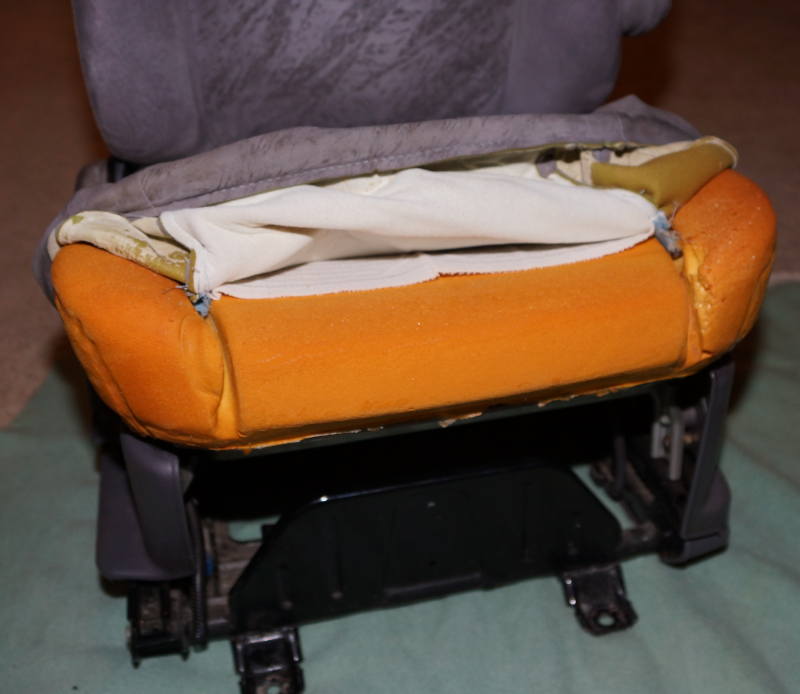

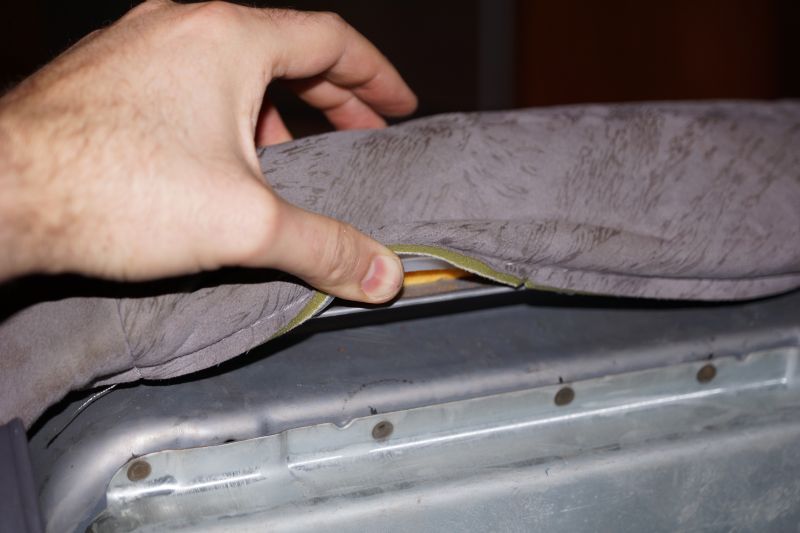

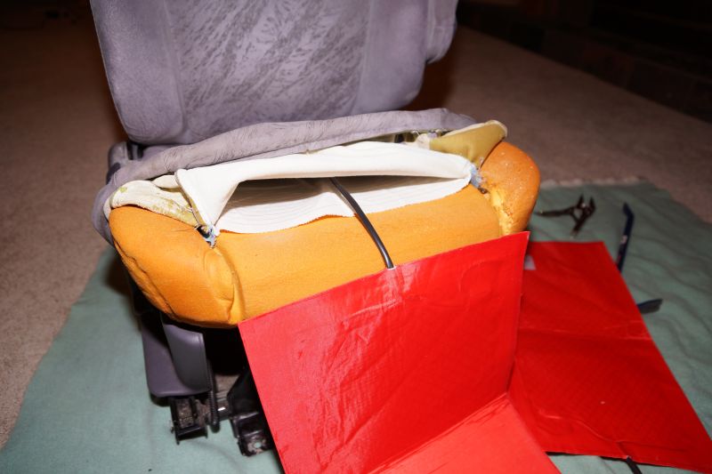

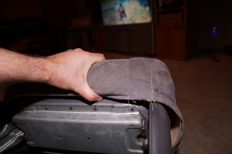

Pull the front of the cover off....
Pulling cover off (Actually quite easy!)
It comes off pretty easily.
Off
Off

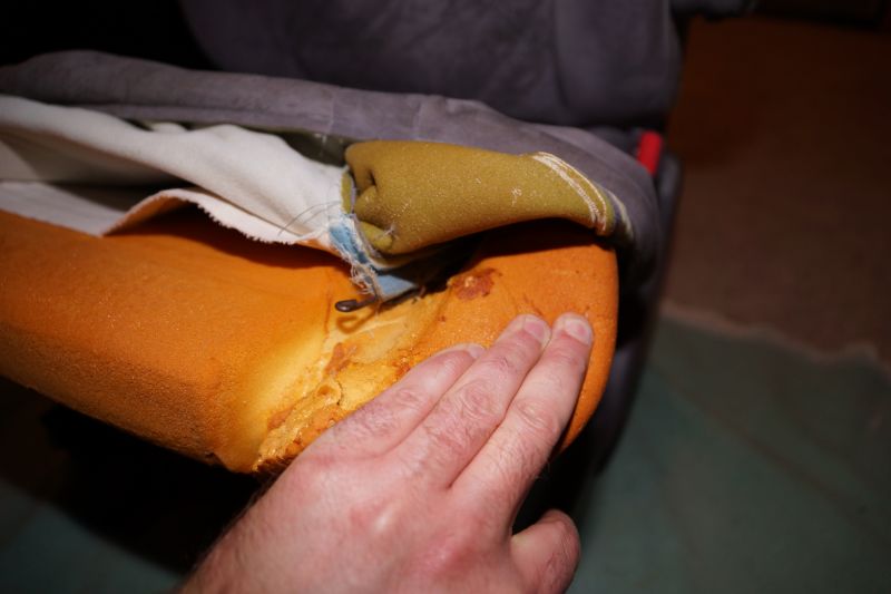

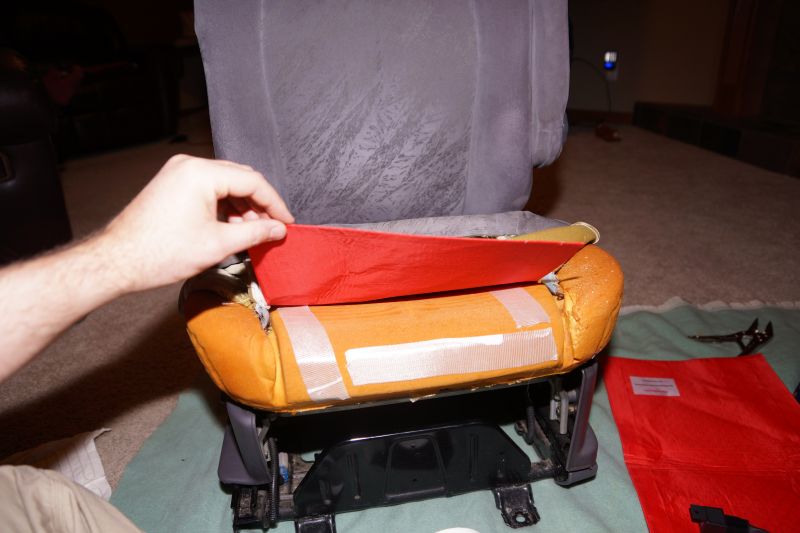

Here you can see the old heated seat element, it is actually PART of the seat cover! I ended cutting the bottom one out with a knife to make room for the new one. You don't have to do this if you don't want to, but I wanted it out of the way for the larger element in my case.
Old Element and cover

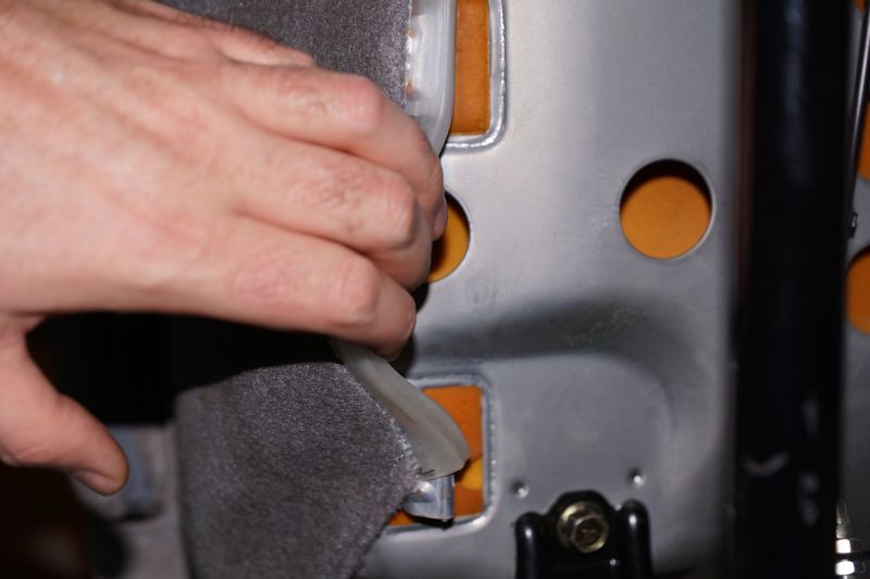

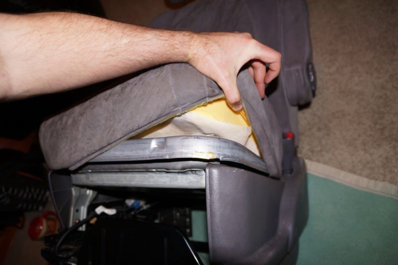

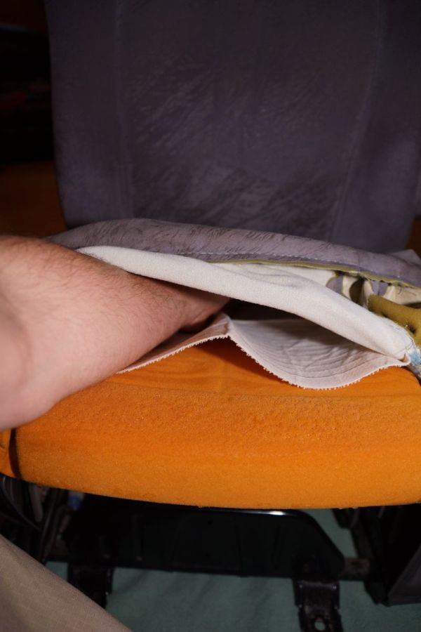

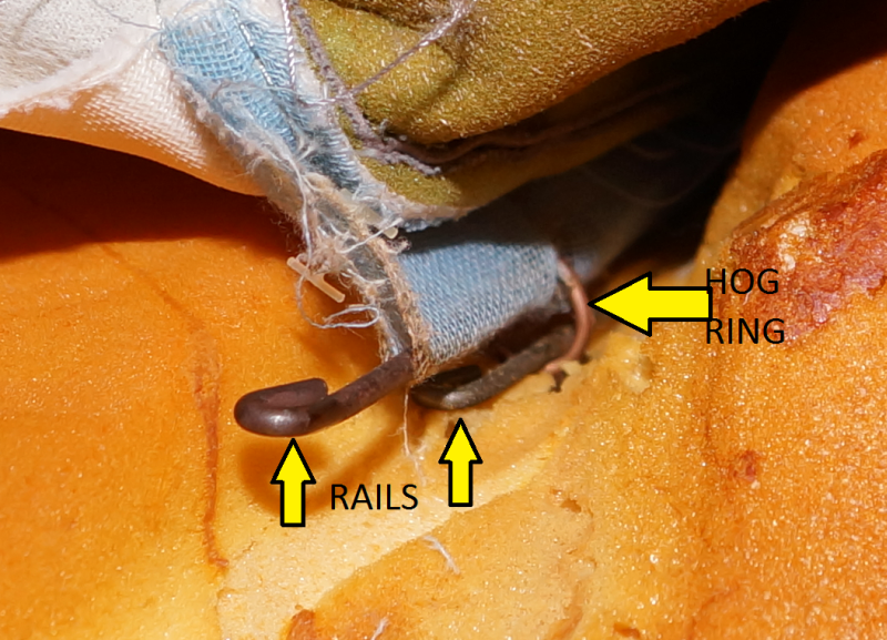

Here you can see the metal rail that holds the seats in place. There are metal hog rings on this, or at least some sewing holding down the seat cover to this rod.
As my seat covers fit very loosely, I realized I would not have to cut the cover away from these points, and I had more than enough room to slide the heated seat element under the seat without having to do any cutting on the inside. If your seats fit tightly however, you will need to cut the seat free from these and when done, re-attach the cover to the seat with zip ties.
Here you can see that I was able to reach my hand with ease all the way to the back of the seat, this is because the covers are so loose on my old seats. Again, if you can't do this, then you will have to cut away the cover from the hog rings to put your elements in. (See the heated seat install for the Jeep at the beginning of this thread for how that works.)
If you do choose to go the route of cutting all the hog rings, this photo will help. Note, you need to replace the hog rings with zap straps when you put the seat cover back on!

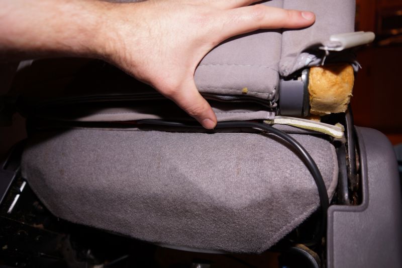

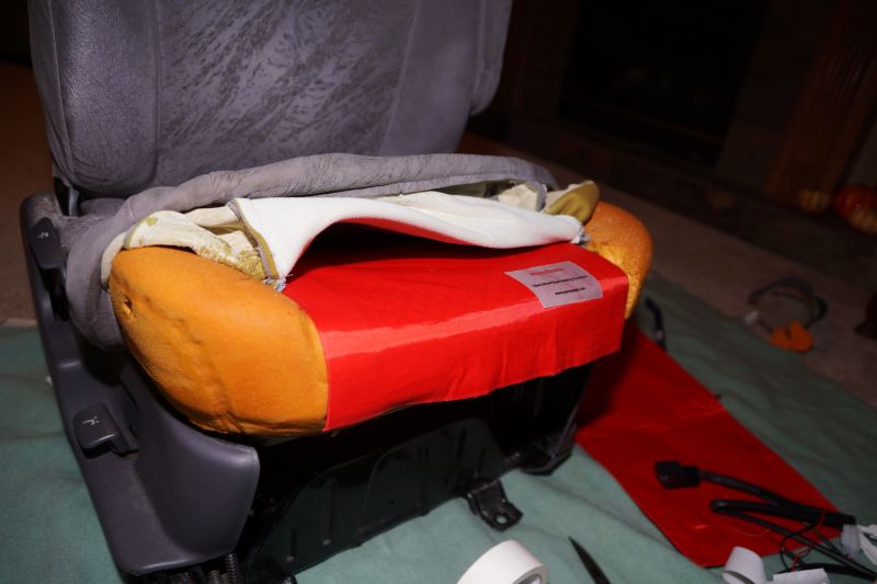

Here is how I fed the element underneath the seat. However, I found my element was a little too large to do it exactly in this manner...
So, I cut out the bottom of the seat element to make enough room for the wide seat element I had. I could have put the element under all that, but I could not see the point in having a double layer of fabric on top of my heating elements to slow down the warm up time.
here is the removed old element that was part of the original cover.
After sliding the element underneath, I put some double sided tape on the front of the seat to help hold it in place while I was snugging everything down. Given how slippery the waterpoof elements are, in retrospect, I would have put more double sided tape on these to prevent slight slippage in the seat cover when seated. The non waterproof ones don't have a slight slippery feel to them. This is not actually something you would notice AT ALL unless you were the person who installed the seats though! :)
Fold the seat down over the tape to make it stick. NOTE, if you get the non-waterproofed version it will have double sided tape already attached, so you won't need to buy any extra to do this.

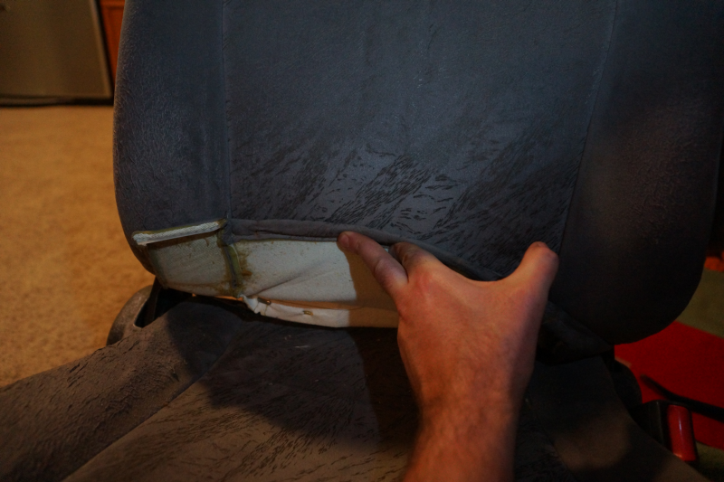

Next, we move on to the lumbar support. The lower seat part is now done except for the electrical wiring.
There are two options here.
Option 1, remove the arm of the seat by unzipping the arm cover, unscrewing the arm, remove the headrest, remove the back hog rings, remove the whole seat cover and the internal hog rings, add the seat element, and then perform the reverse order to finish off.
OR
Cheat your seats. :-D

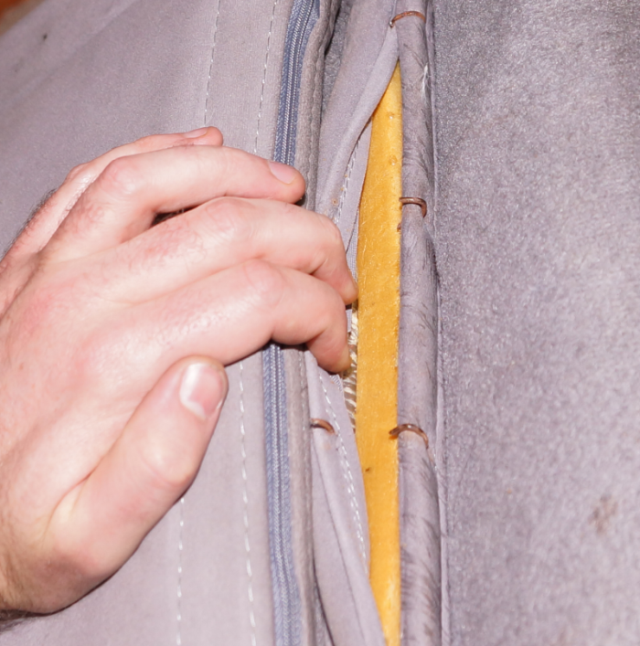

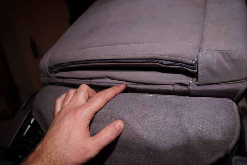

This involves, removing the Hog rings at the back (required):
Mr. Flibble
Posts: 1397
Re: Heated Seats
Post by Mr. Flibble »

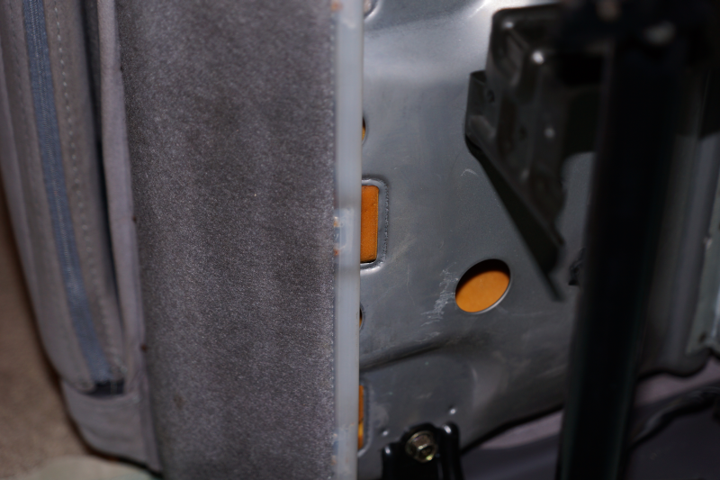

Now, cut those four hog rings. They are tough, and you might have to cut them into little bits to get them all out. They will leave very small holes in the seat. I recommend enlarging the holes with an awl or screwdriver if you have one that works. I actually used a two pronged turkey fork as it was the only thing I had on hand! (The point of enlarging the holes is so you can feed zip ties through them when done everything else to replace the missing hog rings.)

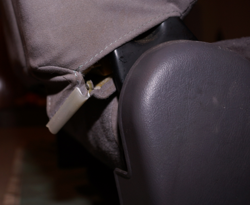

Next to those hog rings, on either side of the back you will find some small plastic clips that pull out to the sides with ease. Take these apart as well. (No need to cut, just slide them when the hog rings are gone.)
Clips in:
The slider clips removed:

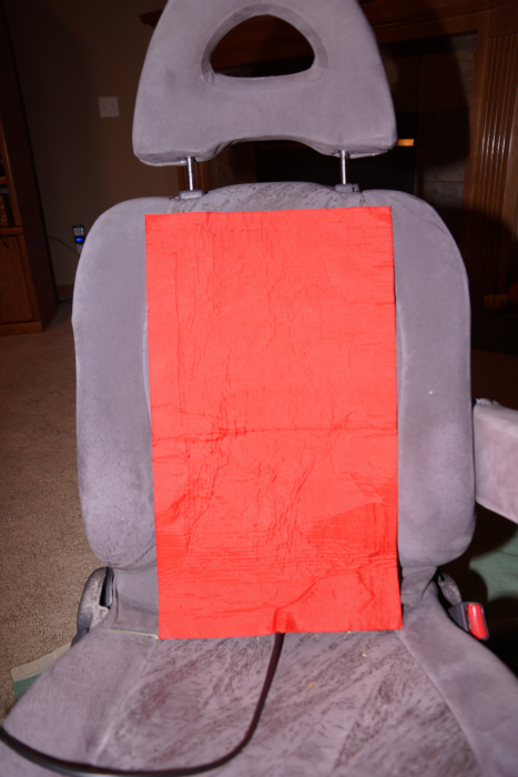

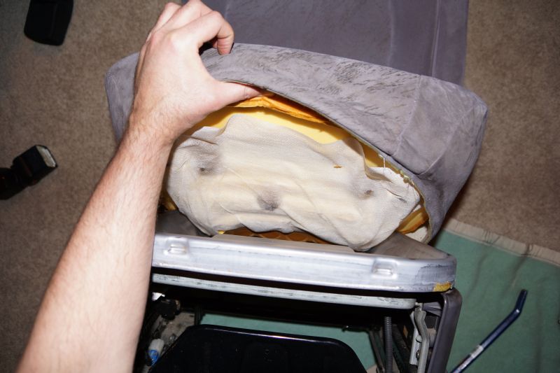

If you want to remove the whole cover, you are going to have to flip the seat cover back like this, and pull up...
However, to do so, requires removing the mid passenger footrest, arm rest and headrest. Not to mention cutting all the hog rings inside the seat back itself. I took a quick look at this and decided I did not need to to this at all.
Instead, I pulled the fabric for the seat through the front of the seat like so:
And with this part forward, I found I could reach my hand under the seat cover as I had done before with the bottom seat pad. I saw that there was absolutely no need to remove the entire cover at all! This would save me tons of time!

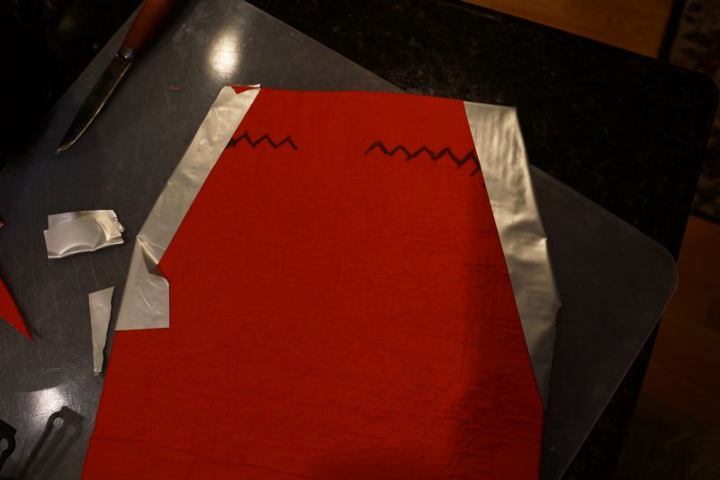

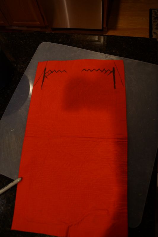

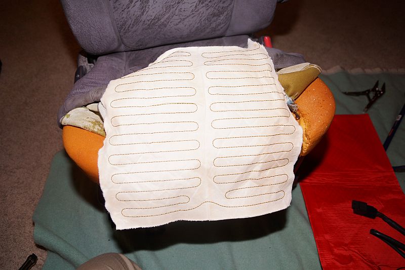

So, I matched the element up to the size of the seat:
Then I took note of where the actual internal heating elements where. (I drew on them with sharpie marker so people on the forum could get a good idea of where they actually are in relation to things).
I then cut the top edges of the seat taking care not to cut where the side "rails" are on the seat, but enough to taper the size of the element to fit in the back of the seat where the seat tapers at the top. I used the silver tape provided with the kit as I now know what that stuff is for!
Then I just slid the seat element inside the seat and pushed it up with my hand. It fit between the old element and the seat with ease, so no cutting was required. I then fed the cable out the back and made certain to route it to the side with the other cable I had moved out before.
