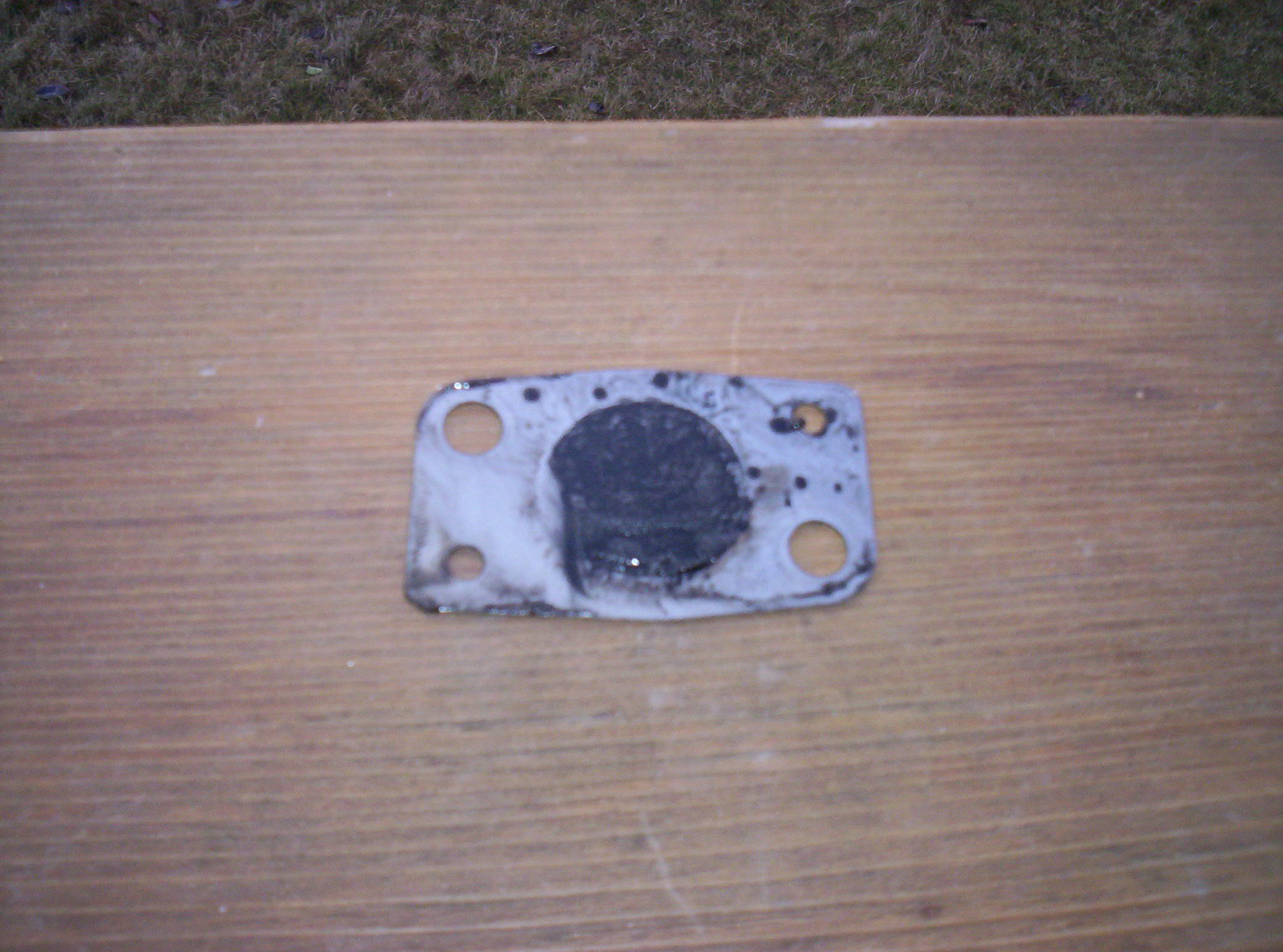

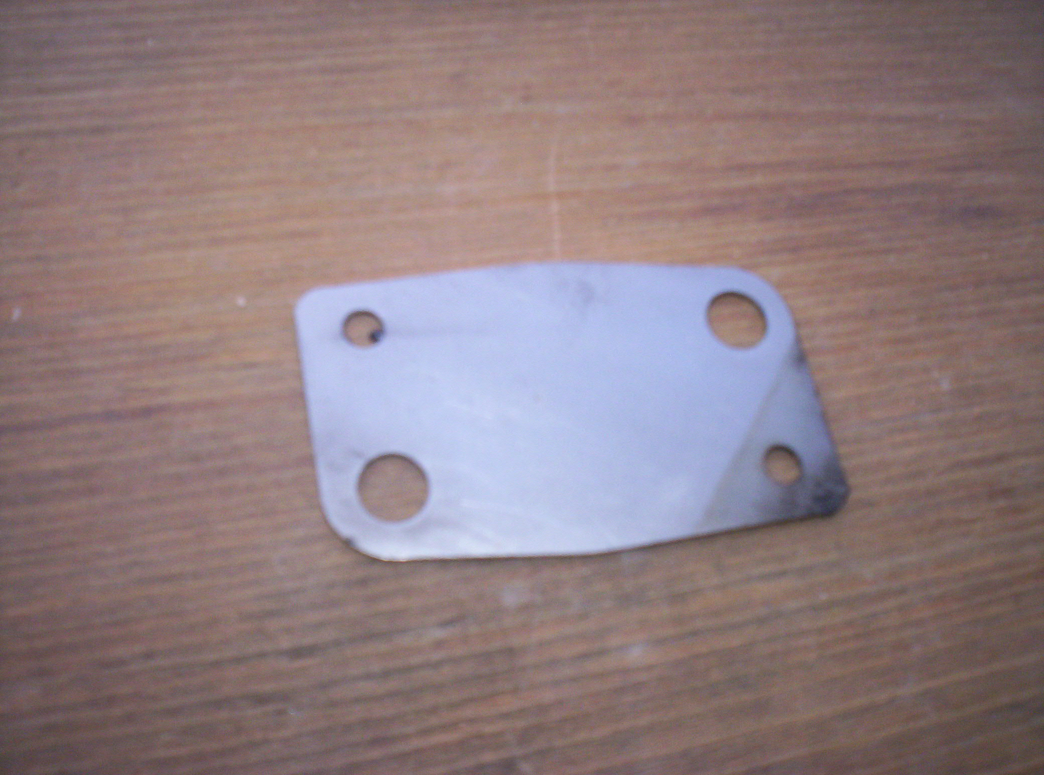

Just had to check the turbo on hers, seals are getting bad and the injection side of the turbo has a nice coating of oil. Here are pictures of a blanking plate with 80,000 to 100,000km's on it. The exhaust side has one small pit and the intake side (first pic) had coat of oil only.

- 100_2075.JPG (683.53 KiB) Viewed 4439 times
- 100_2074.JPG (707.94 KiB) Viewed 4459 times
