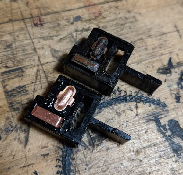

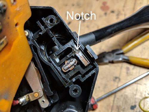

An addendum: the squarer contact develops a notch in the front edge where it runs into and over the button contacts on the PCB. If you turn the contact around, you'll get another 25 years of service out of it, and the switch will feel like new!
Here's the nasty old carriage (upper) and a clean one with the contact reversed (lower).

While I had the Combination Switch on the workbench, I figured the Turn Signal switch and Wiper switch are going to start acting up soon, so may as well take it apart and clean those too. Sure enough, it was filthy in there, cleaned it all up. Got the whole thing back together and the right turn signal didn't work! The copper contact for the signals is held into the plastic slider it's in (which mercifully only fits in the track one way) by a little tab in each end. Push in on that, and you can remove the contact for better cleaning and to stretch the spring, as someone else recommended on this thread. Did that and reassembled it all and now I'll get that warm, fuzzy feeling every time I use the Combination Switch.
