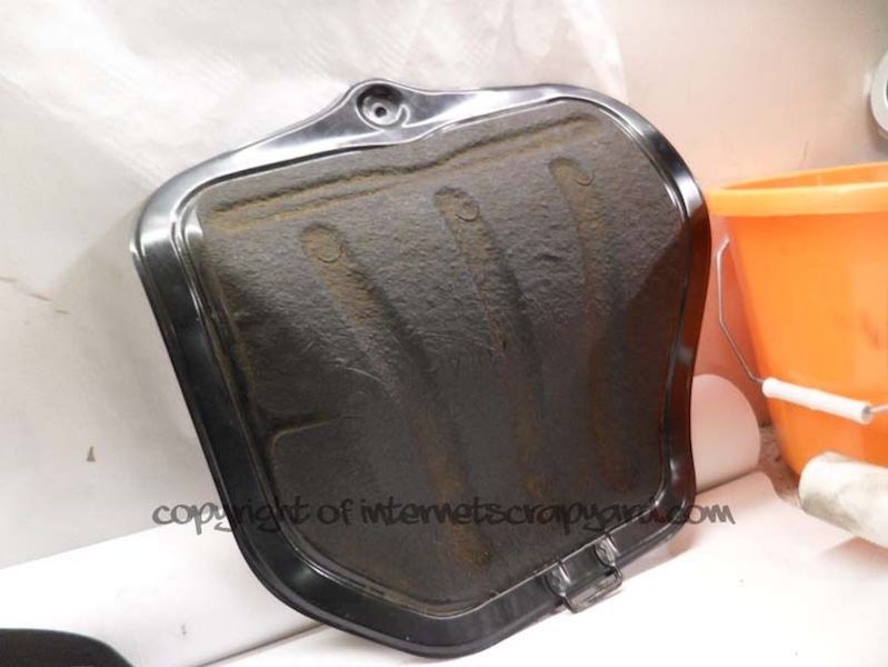

So technically these Vanwagon's are simply 2wd L300's? After some online searching...I'm pretty sure this is the part that my van is missing...makes for some warm driving conditions...I found this pictured part on UK Ebay...however I may be running into the LHDrive...RHDrive issue...anyone have a line on a LHD one of these?

Fair point, the LHD/RHD difference complicates things in some areas. Still, European/LHD Asian market L300s should have parts that fit too.

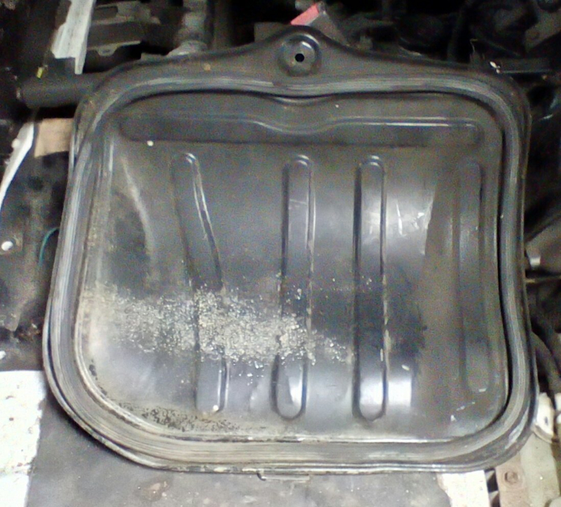

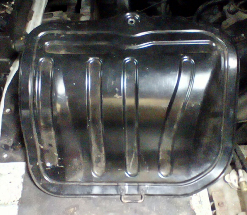

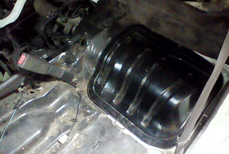

Been busy getting a camping trailer roadworthy for an upcoming trip and completely forgot about this. These vans pop up for sale up here on occasion but I haven't seen one in a wrecking yard in a long time.
- IMG_20170122_2209159_rewind_kindlephoto-319354691.jpg (659.99 KiB) Viewed 22750 times
- IMG_20170122_2208594_rewind_kindlephoto-320027245.jpg (590.79 KiB) Viewed 22750 times
- IMG_20170122_2209284_rewind_kindlephoto-319181292.jpg (625.95 KiB) Viewed 22750 times

Thats the part...Thanks for the pics! I've been looking at Pick n Pulls locally...but no part vans to be found. A camping trailer that will be pulled behind the Van? I know of guy in the Seattle area thats making hightop conversions for old VW Vanagons....Anyone know of an outfit making hightops for our rigs? El Pato has been getting insulated lately and will laying down a new floor soon...will post some pics once were all back together!

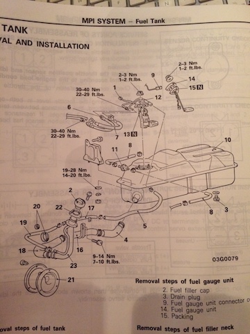

Thanks for the input...this may in fact be the issue...will check it out tomorrow...I was looking over my fuel tank diagram in the manual but can't locate the "vapor trap" you are talking about...I see the vapor hose #8 connected to a two way valve #11...Are you talking about the valve? You description of the failed O ring sounds spot on with what I'm experiencing. On my drive home this evening...I've also noticed a slight rough idle once up to temperature...especially in stop/Go traffic...it almost has a retarded timing feel or an exhaust leak. But no loss of power and even under highway load up an incline...the bus just goes...Does this rough idle once warmed up sound familiar at all? I used to run old VW's back in the day....only carb engines...so this is my first dealings with Fuel Injection...I've been reading up on the manual but any advice or tools for troubleshooting the FI system? Also curious how a cheat code works?
