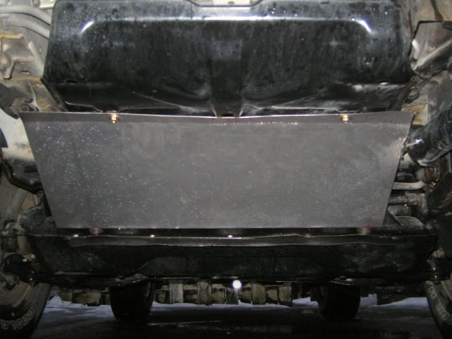

I made and installed a "Radiator Cover" for lack of a better term. My deli has never had the thermostat change (re: when driving in sub-zero weather with the heater on you can watch the temp gauge drop and it is hard to keep it warm inside. Like when driving to Princeton in -10)
I suppose I could have changed the thermostat but I decided to take an easier route and block airflow to the rad. I didn't, so much as cover the radiator, but instead, made a sheet metal plate that bolts between the upper & lower front skid plates. I figured this way if it does heat up (fan turns on) there is still airflow through the rad.
I really just wanted to block the ice cold air from directly flowing in.
I will keep an eye on it and the next cold weather drive will know if it actually has done any good. If not, well it only cost me $15 and a few hours of tinkering.
The only thing left is to paint it before it rusts.

Took a drive out to Abbey, BC yesterday on Hwy #1. The temp was around 4-5 degrees C. The temp gauge did run about a needle width higher than normal (I did this run about 4 days earlier, prior to installation) which doesn't seem like much. But what my Hunny and I both noticed was a considerable lack of draft in the cab - especially around the passenger seat.
What most of you (L300 owners) probably know or have experienced is that the cab is not the most airtight, especially around the passenger seat. With this new found idea of blocking direct (cold) air flow towards the rad it has also, unintentionally but appreciated, blocked that same (cold) air from seeping up around the engine access compartment (ie: passenger seat).
I just love these little experiments/ideas that I conjure up. Quite often they either give an extra benefit or do the exact opposite of what I thought. Either way there is an interesting end result and one that works for something. (note: did a similar experiment with my motorcycle and had opposite, but desirable results).

Hey Shaun Van Ramen
If the temps rise a bit outside keep an eye on your operating temp
I did the same with puckboard for mine. It was more to keep the snow
out for when I go icefishing.
I will say if your van/motor temps don't warm up normally do change
the thermostat. I had mine done when I got the van and it's a huge
difference. Heat within 5 minutes and normal range temps.

After making a solid piece I decided to cut 4 holes in it to let a little flow through.
Kept the temps where I wanted them in warmer weather.

Firesong,
thanks for the input. For sure I have been watching the gauge. In town (Vancouver) the gauge doesn't get that much hotter than normal (pre-plate), even in this balmy +8-10c.
As far as warming up, I always give the motor 5-10 min depending on the outside temp. I also do this with the Prevost Coaches I drive - but they are more like 20 min.
But the design was always "Winter Only" - 4 bolts and 5 minutes and it's outa there. There seems to be enough space around and inside to allow for airflow (via fan) when needed.
As mentioned above what I really noticed most (and best) is the cab is not so drafty now. So the pan with a little extra weather stripping around the engine access (ie: passenger seat) keeps it reasonably toasty inside the cab.
