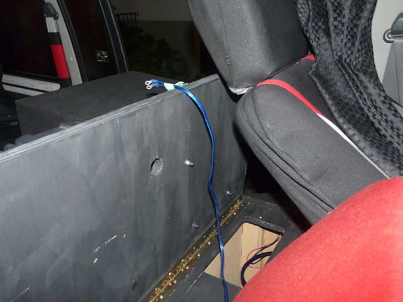

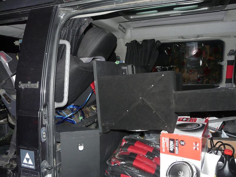

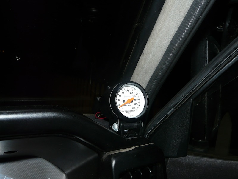

Here are the pictures of how the sound system hinges to allow access to the engine compartment. (sorry, the van is a complete mess)
I've also added a picture of my pyro and where it's mounted.
- P1060984.jpg (75.84 KiB) Viewed 4053 times
- P1060985.jpg (75.81 KiB) Viewed 4053 times
- P1060988.jpg (74.27 KiB) Viewed 4053 times

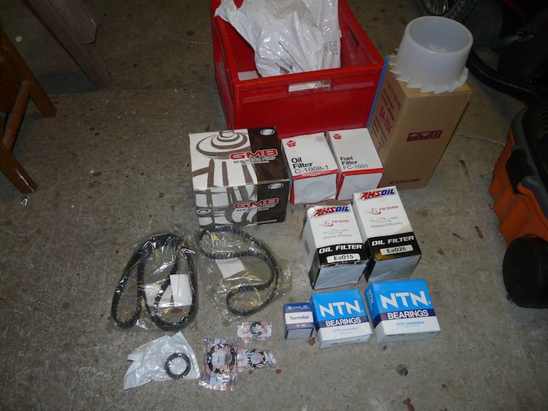

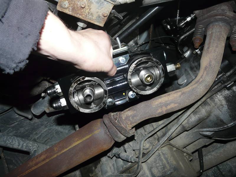

Some of my more useful gadgets, more parts and a possible location for my dual bypass oil filter install.
- P1070010.jpg (76.8 KiB) Viewed 3983 times
- P1060997.jpg (75.3 KiB) Viewed 4018 times
- P1060999.jpg (75.9 KiB) Viewed 4018 times
- P1060998.jpg (76.77 KiB) Viewed 4018 times
- P1060994.jpg (77.44 KiB) Viewed 4018 times
- P1060996.jpg (75.54 KiB) Viewed 4018 times

Re: Hermione's Makeover
Took me about 5 minutes to look at it and think how this works. Then i realized that you guys are driving rhd and my van is lhd. But i got the idea now, thanks for the pics...nxski wrote:Here are the pictures of how the sound system hinges to allow access to the engine compartment. (sorry, the van is a complete mess)

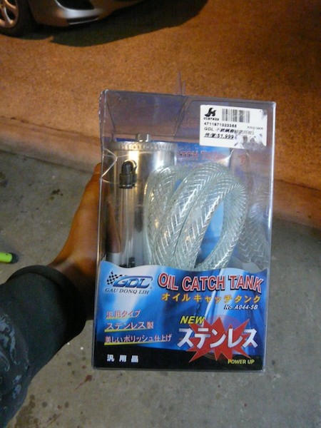

Here is a picture of the oil catch can I got from Maximum Overdrive. The tubing is 9mm so it will need a step-up adapter.

Check if there is any kind of baffling inside that catch can, most cheap ones have nothing. If nothing then find some way to squish a metal pot scrubby or two in there or it will be as useful as man boobs in actually removing any oil vapour. Also make sure that tubing and/or the inlet/outlet size isn't significantly smaller than that of what is one the engine or you can end up pressurizing your crankcase and blowing a seal.
There are 2 sizes of tubing, 9mm and 15mm. I'm not actually sure which is on the engine. mdrive just said to put in a step up or down adapter depending on what is there. It looks like the bottom of the canister is held in place with 4 bolts so if I undo those and put in a 'scrubby' I should be good to go?
EDIT: I just opened it up and there is nothing inside, so you're suggesting I put in one or two of those green pot-scrubbers? Should they sit at the bottom or top or does it matter? Do I not have to worry about contaminating the oil with this?

Get a couple of the stainless steel kind of pot scrubbers that look like a big ball of fairly loose rings not the green pads. Put 1 or 2 in the can depending on space. You don't want them to be compacted too much...you still want the air to flow easily but with disruption. The pot srubbers give lots of surface area for the oil vapour to be disrupted and impact on and cause it to separate from the vapour and collect in the can (ie letting the can do its job) leaving cleaner air to return to the engine.nxski wrote: EDIT: I just opened it up and there is nothing inside, so you're suggesting I put in one or two of those green pot-scrubbers? Should they sit at the bottom or top or does it matter? Do I not have to worry about contaminating the oil with this?

I used an empty oil catch tank on my Supra, and it worked flawless...
