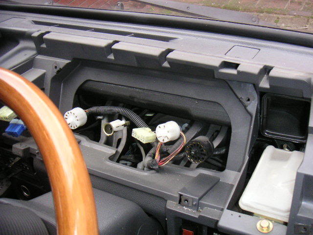

Sounds like a bad connection at the main plug for the dash gauges Its on the back of the gauge pod. Problem is there are about 25 or so contacts and which one is which is dificult to identify. Good luck Jay Tardis Deli

Oh Dear!
I guess it's one of these four rather interesting looking connectors....
I'm just going to hope I can re-seat the connectors and all will be fine...
