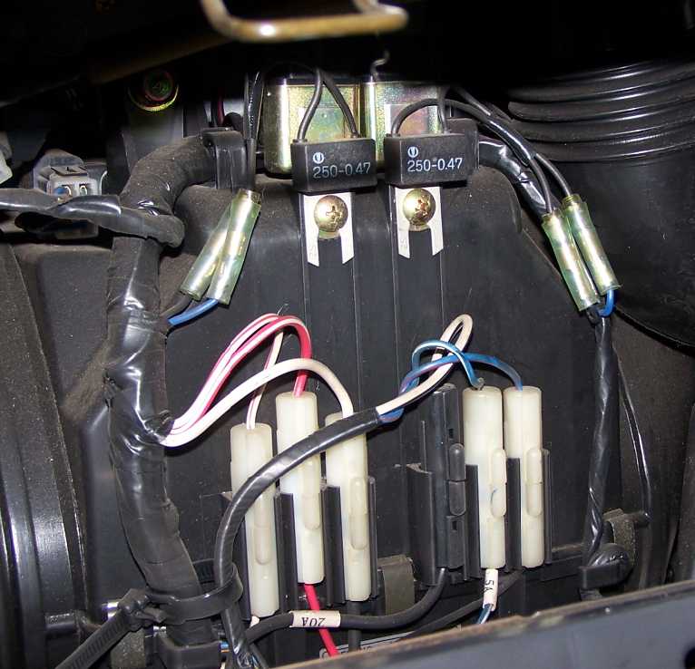

before you put it all together could you please photograph it?

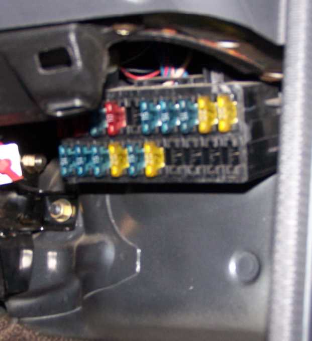

I took 2 pictures, 1 of the main fuse block where the 20A fuse is ( yellow ) on bottom right and another of the fan area. The 20A fuse is the fan for sure as when I pulled it the fan stopped. The other picture got me more confused after I looked @ the drawing as the drawing shows 3 resistors, which I thought were the black rectangles with 250 on them. I'm not sure any more. Have you taken the 5 white things apart which appear to be in-line fuse holders. They may not be fuses.
I also listened for the motor location but I couldn't really tell where it is. The wires going to it should be blue with a red tracer and possibly black. I'll do some more checking on mine this morning .

they are fuseslrp374 wrote:Have you taken the 5 white things apart which appear to be in-line fuse holders. They may not be fuses.

thanks for the photos.. they are fuses, yes, and theyre good. although mine only has 3 fuses there, not 6 like yours lrp374 (your black one is a fuse too i presume)loki wrote:they are fuseslrp374 wrote:Have you taken the 5 white things apart which appear to be in-line fuse holders. They may not be fuses.
