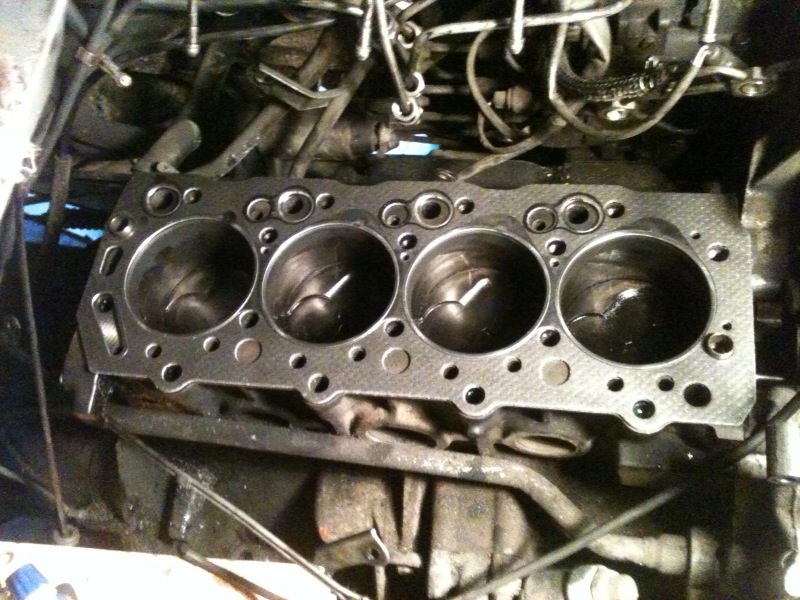

so I just finished installing the new head gasket into the delica, I also cleaned and polished the intake manifold, egr valve,and cylinder head.then I lapped the valves and installed new valve stem seals, replaced the camshaft oil seal, valve cover gasket and will be using a new intake and exhaust manifold gasket as well. Tomorrow I will install the new turbo and reconnect the exhaust system. Next thing I will attempt is the timing! any suggestions? Here is a pic of the new head gasket installed.

Hey,
You are a brave man getting right in there eh?
For timing my only suggestion would be
All new everything ,belts,seals,idlers and
Springs. There are two different belts (different
Tooth counts) depending on the year of your
Motor.
With all the other wicked stuff you have
Done you probably have that sussed out
Already....
