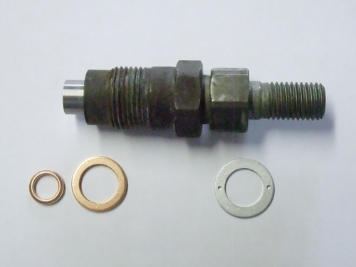

Will everything be reusable or is there a small kit of seals/gaskets that I require? I recall one shop mentioning he didn't include these in the price. Being a Paj, although a common engine [4D56T] are these parts he'll have or should I pick up a set??

We have them in stock, one injector has 3 different kind of heatshields and should be replaced.
$60 for 12 ( for 1 car ).

Part numbers for these seals/heat shields...? Anyone? I'd rather not have to bring these in from somewhere...
I checked the Tech downloads section and cross reference parts...I didn't see anything.
Should I just check a parts place for a 4D56T engine?

The washers are specific for the injectors on the 4D56.
If you can't find them locally, you're other option is to get a set from one of the dealers, parts suppliers like Rockymountain imports, Assiniboine imports, RS Imports, Amazing Auto Imports, Coombs Auto.
