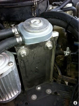

When I bought this truck the 1st mod that really mattered to me was converting it to run on Veggie and it's finally done! As usual, Jay (Tardisdeli) was a big help with this project and I'd still be scratching my head on how to wire everything if it wasn't for him, thanks Jay!
On my veggie set up I'm using the stock 90L tank for my veggie and installed a secondary 60L tank for the diesel as I still need to use diesel on start up in the morning and shut down (purging the lines from veggie at the end of the day). Total of 150L of fuel available, bring on the road trips!

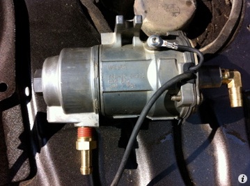

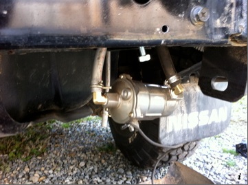

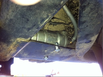

I started by mounting a 24v fuel pump to assist pushing the veggie to the IP. It's a Walbro FRP-16 24v. It's mounted inside the rear crossbar against the rear bumper. It's mounted in a way that it can be easily serviced (extra hose length).

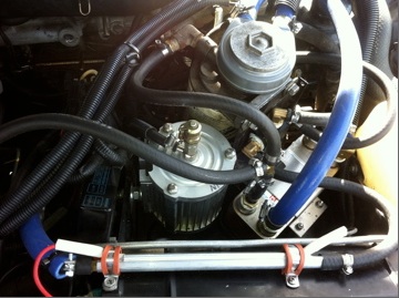

Next was installing a heated Racor fuel filter. I would have prefer to use the Plantdrive one but I had this one in my garage and couldn't justify not using it. I already relocated both batteries inside the cab so I'm lucky to have new space available for other projects including this one. I made a bracket sitting where the driver's side battery used to be and attached the Racor on it. It's slotted so the filter can be lifted out for servicing. Again, extra hose length.

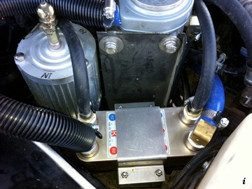

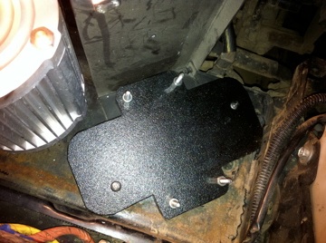

Jay made a platform sitting at the bottom of the Racor bracket to sit the heat exchanger and mounted the HE on it.

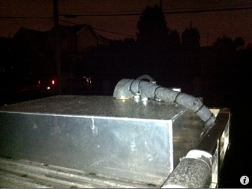

Finally I mounted my ghetto fuel tank on the roof. It will find a better spot at some point but I had this tank in my garage and doing this way allowed me to get going on veggie right away. My future options would be to mount it underneath (not a simple task given it needs it's own filler/venting...) or build a 10L tank and mount it inside the engine bay. Not decided yet and not too high on my priority list anymore. As it stands, the tank is quite low profile (7" tall) and can barely be noticed, especially that it's the same color as the roofrack.

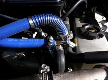

Start the truck on diesel, drive for 2-5min. Coolant warms up the heated veggie filter and HE (coolant line T from the main line to bring hot coolant to both heaters and return to next main line) then switch to veggie (3 way switch inside the cab). Supply valve turns on, blocks the diesel and alloys veggie instead. Return lines turns on, blocks diesel from returning to tank and alloys veggie to loop back before the Vegtherm. This way the hot oil doesn't get wasted by going back in the wvo tank and gets immediately recirculated in the system.
For shut down at the end of the day I switch to the 3rd position (purge) on the switch inside the cab. Supply valves turns off (alloys diesel), return valves stays on (loops left over wvo back to the IP until it's fully flushed by the diesel). This way I don't end up sending wvo back into the diesel tank.
There might be a way to improve how the coolant flows through the system by forcing it all to go through the HE before being T'd but I need to think a bit more before figuring how to properly do it. Until then the system is still running great as it is, nice and hot!

Pictures description:
1, 2 & 3: WVO fuel pump
4: WVO heated Racor fuel filter mounted behind the bracket
5: Heat Exchanger bracket
6: HE mounted
Racor & HE mounted.jpg (52.86 KiB) Viewed 8854 times

Couple more pictures and details...

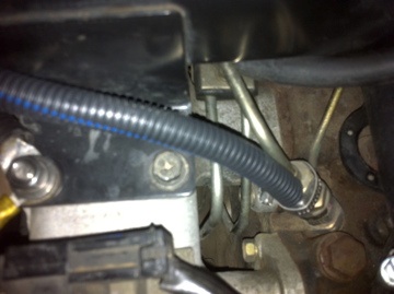

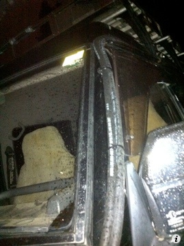

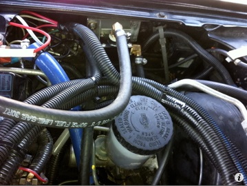

1: 3 way return valve
2: Vegtherm sensor allowing to power it on/off within a certain temperature range. (see details in previous page)
3: Coolant lines T'd on main lines

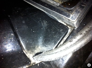

4: Diesel fuel lines (supply and return) going through the bonnet

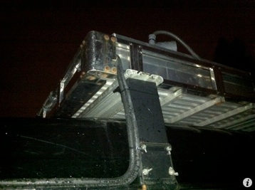

5: Diesel lines going up the pillar and onto the roofrack
6: Diesel lines making it to the mounted fuel tank on the roof
7: Roof top mounted fuel tank with protection cover for the lines. (I still need to change the fitting for the vent from straight to 90 degree)

Soon enough the fuel lines going up by the windshield will be hidden and protected by the 3.5" snorkel I'm working on. This system might be a bit overkilled with the 26plates heat exchanger but my wvo tank isn't heated so it could be even more efficient if I had the patience to do it. With our typical weather here I didn't feel the need to heat the tank, time will tell!

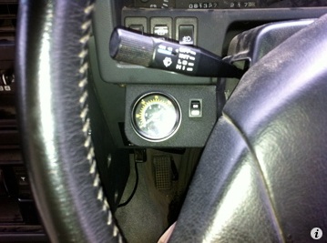

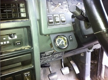

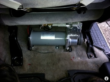

I mounted my onboard 24v Viair compressor. It's mounted under my seat and best part is that when it's running it's identical to those massage chairs sold for a couple thousand$! :-D Lovely bonus massage!
All left to do is mount my 2 gallons air tank. It's all ready and I've got a good place to mount it under the truck. Next project, mount it and run the lines. One going to the rear for endless air supply (tires...), another line for a air horn and finally another one for the front locker (but that's not on my priority list yet).
I mounted a gauge for the tank pressure and power on/off conveniently by all the other switches. Works for me!

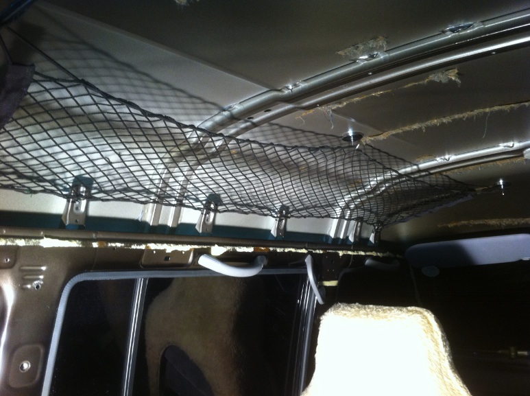

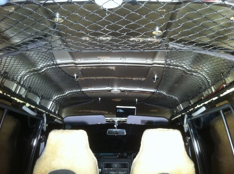

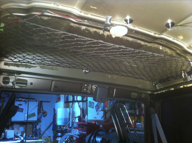

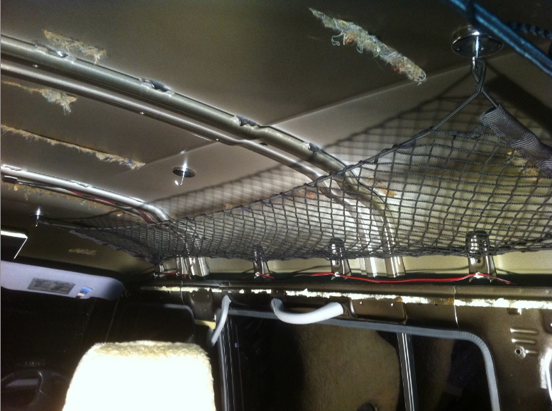

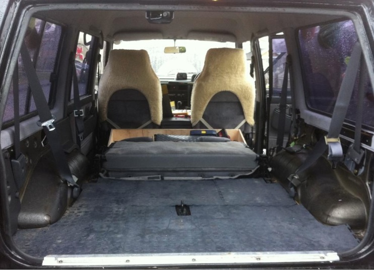

A lot has been done since the last mod so here's a simple one to get started... In preparation for the storage cabinets I'm building and new roof insulation, I took out all the headliner. This allowed me to use these nifty little magnet hooks (strong enough to each hold 20lbs) onto the roof/pillars to partly support these cargo nets. Nothing fancy here but very practical (it's amazing how much stuff you can store up there)! They do their job fine; store my clothes, sleeping bags and other light items when I'm out camping. The nets are also supported by brackets along the roof line so quite strong. If I decide to keep them I'll consider building a bracket across the roof to make it even stronger but so far so good.

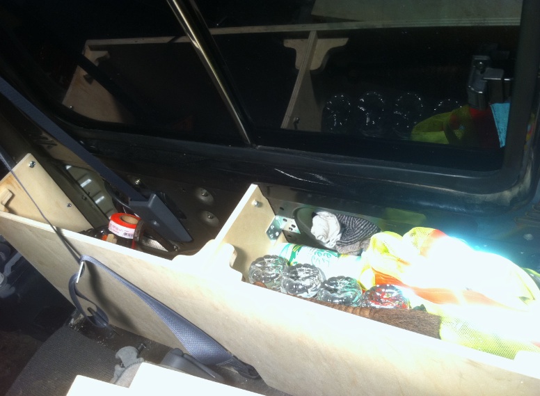

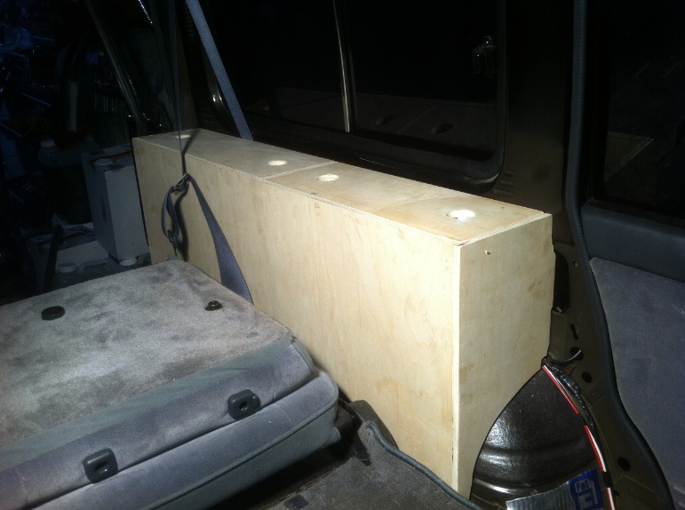

Also got started on my wood cabinets but still a long way before the project is fully completed. This is the first unit, the left rear cargo. It's scary how much stuff I can hide in there! I'm posting a picture of the empty cargo to give an idea of the room I have to work with. As you can tell I ditched the middle seats and only kept the back bench. This way I get way more room where I need it and it's also more comfortable for the kids at the back.
Next will be a similar cargo box on the right but much taller (almost to the roof) and I'll replace the rear cargo net with a solid wood box/shelf. Then I'll start the cabinets behind the front seats but that's for down the road.
Cheers!
Mr. D

delicat wrote:
What's in there? burritos? ice creams?

Re: Delicat's new ride! Nissan Safari
Thanks,
Burritos are coming, soon! 8-)
