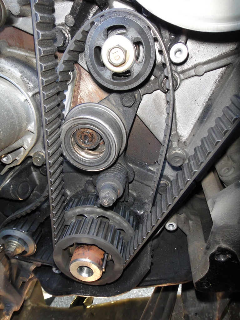

Sooo, I did my oil change today and decided to poke around a bit and took the timing belt cover off...
Turns out I've been driving around with a busted balancing belt tensioner for a couple of months. Retrospectively I know what day it happened: we were driving on some really rough logging roads so I didn't hear it happen and didn't notice the increased vibration (I thought it felt a bit different later on driving on the highway but didn't think much of it and we had been shaken up all day anyways so I thought my judgment was clouded...)

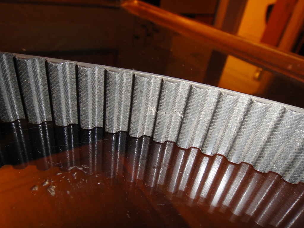

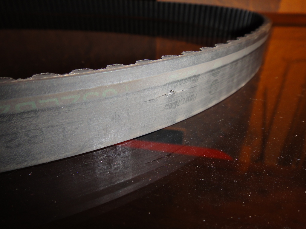

Anyways, it's pretty lucky overall as it doesn't look like there is any permanent damage (read the thread about driving around without the balancing belt) and the timing belt could have easily snapped: there are 2 slits in it where balls from the tensioner bearing were squeezed through the timing belt (can see the slight mark on the crankshaft pulley too) :shock:!
It was an interesting learning experience taking everything apart, lost a fair amount of knuckle skin and had a hard time getting the cranckshaft pulley off: no loose key for me! (The bolt wasn't too hard once I put it in 5th gear, 1st in low range wasn't helping much at first though) I think I can put it back togther :?

Overview:
Where one of the balls from tensioner got pushed through the timing belt:
Inside of the belt:

You should check the condition of the bottom pulley too, as they have a tendency to delaminate, and also the water pump, just becasue you are there.

Thanks for the input; the bottom pulley looks happy (I'm assuming you are talking about the rubber part in there) and as far as the water pump goes, I'm not sure what I am looking for but everything I can see looks good...
Lordco doesn't have these on their cheat sheet (which I suspected) and the delica wiki seems incomplete: there is only one tensioner listed, not sure which one it is and nothing for the crankshaft pulley bolt. I can get the belts but that won't help me much...
