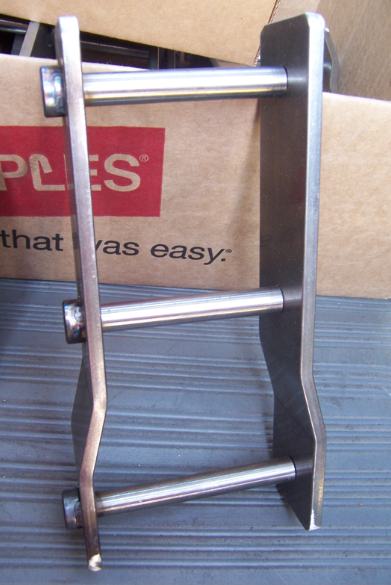

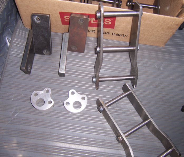

Got most of the parts ready. I made 10 kits but some are already spoken for... The shackles didn't come the way I wanted so I'm getting them re-done and they'll be ready within a week. The new ones will look similar but beefier. Those ones can still be used until I get the new ones if you're in a hurry to reach new heights!
The kit includes the following:
2" lift shackles, zinc plated

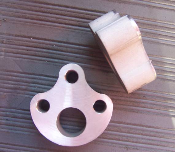

Tranny spacers (I have two sizes so you get to try which one works better for your van, 1/2" and 5/8")
1" balljoints spacers. They are shimmed to help protect your balljoints from premature wear.
All hardware included as well as longer grease nipples to compensate for the spacers.

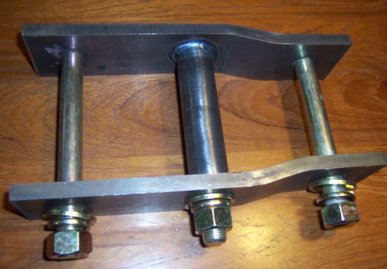

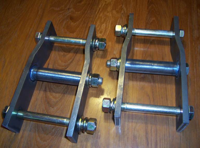

Just got the newer shackles, they look great!
I'm not sure if you can tell between the previous pictures but the new ones are like on steroids! Very happy with the result.
Here's a couple pictures before they get zinc plated:
These things weigh 6lbs each, the van will fall apart before they do!
