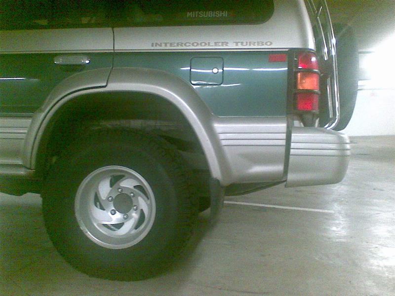

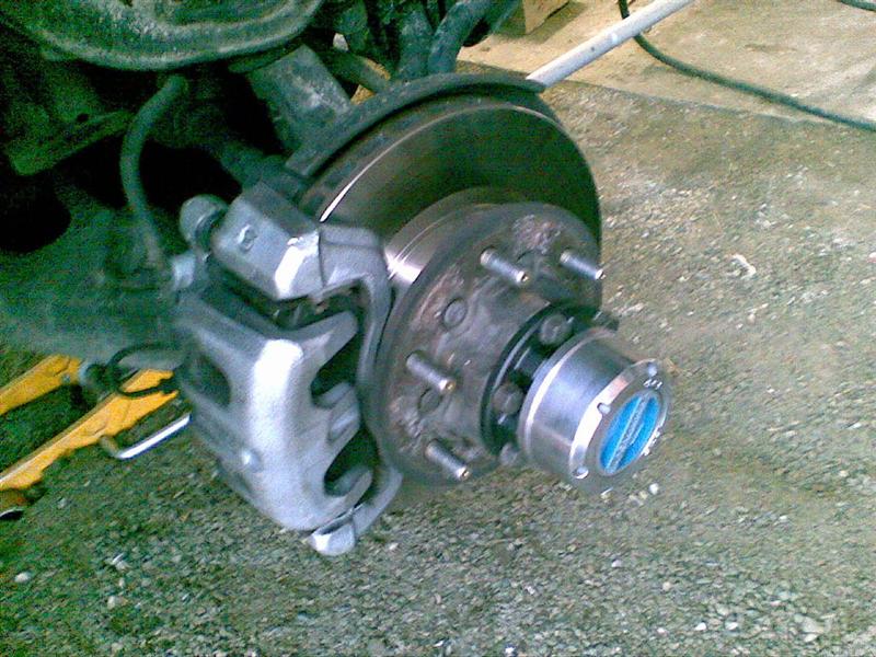

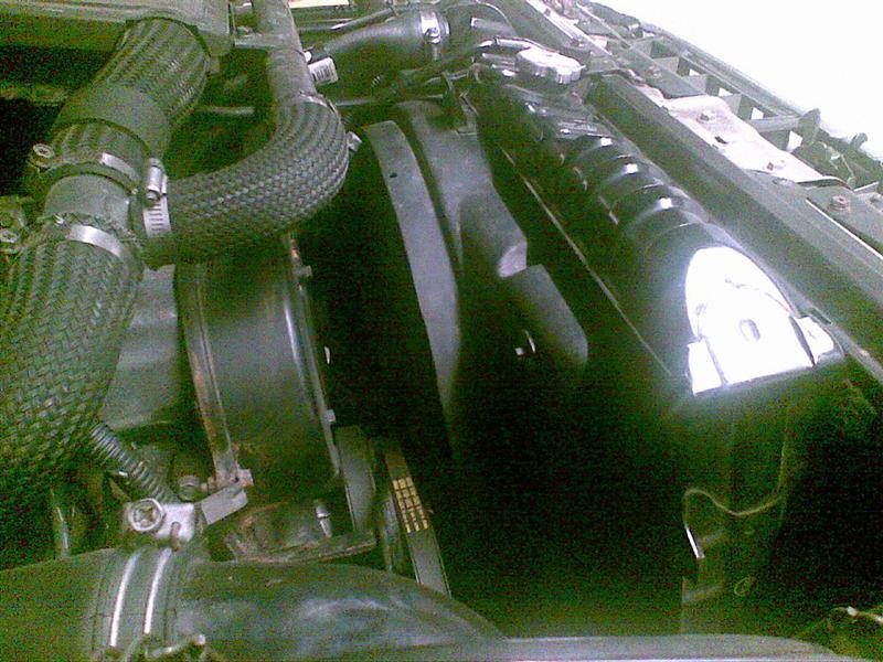

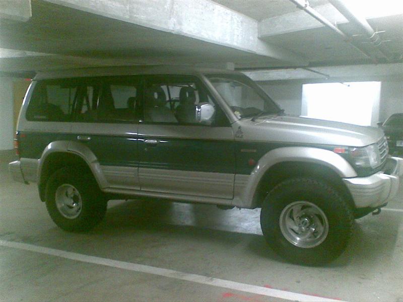

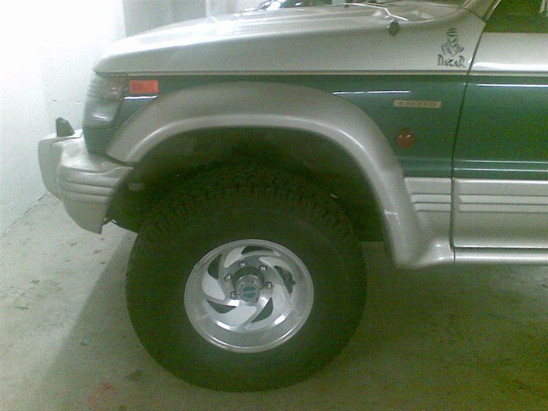

2" body lift -
I made a kit a while ago. Can probably churn one out if you need it.
http://www.4x4wire.com/forums/showflat. ... ost1044552
I added a 2" body lift, twin piston brakes and an electric fan to bypass the stock clutch fan.
On the Delica, you can do the twin-piston caliper upgrade and put in an electric fan as well. I'm going to do that on my new rig.
2" body lift -

thats sweet! so basically you need rubber spacers( princess auto??) and high grade stainless bolts? the hardest part is rewelding the bumpers?
