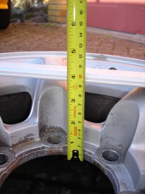

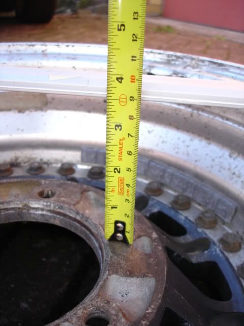

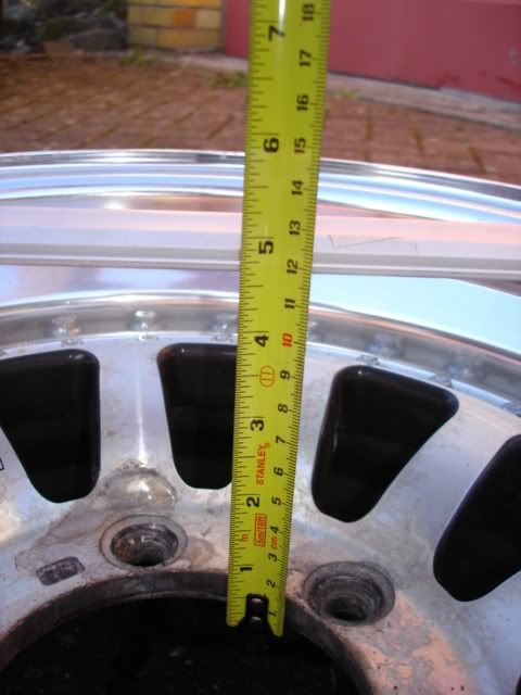

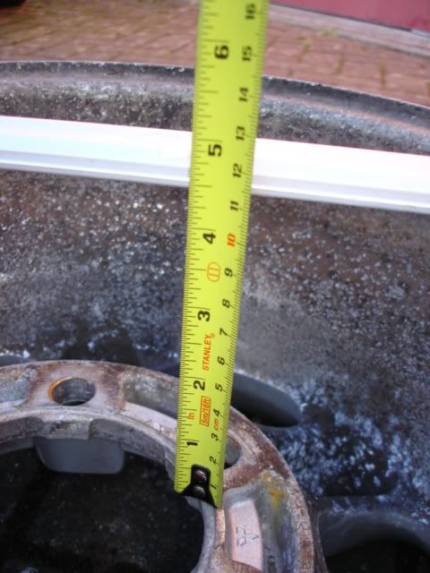

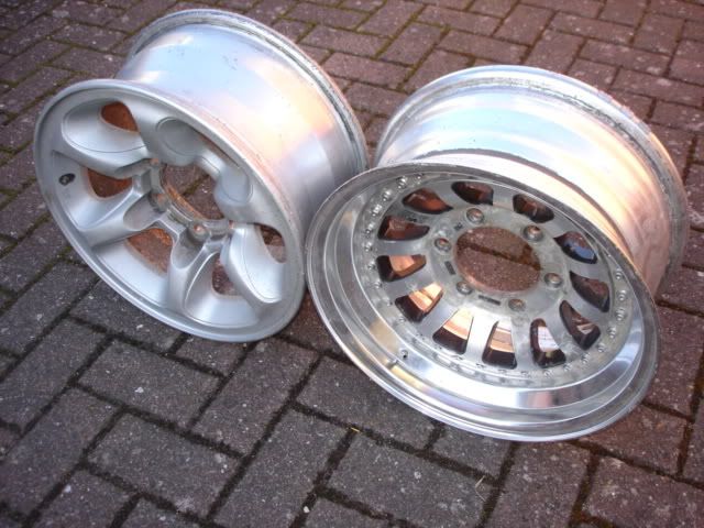

Hi Mitch,
I'd love to say - "YES they'll fit" - but the offset is fairly big, so I can’t give a definite answer I’m afraid!
The size (7x16) and the tyre (245/75/16) should not cause a problem at all beyond some tickling and trimming of the front arches....
The offset however ‘could’ cause a problem! Do you know if the offset is + or - ??
I’ve taken a few pics to illustrate and hopefully help you out…..
This one shows 2 different 7” alloy wheels.
The first is a genuine Mitsubishi wheel and the offset is +10mm (et10)
To get the true offset, sit the wheel on the ground and place a flat object over the face of the rim. Next measure the distance from the MOUNTING face of the centre to the flat object – in this case 95mm
Next, turn the wheel over and do the same on the other side….but remember to take the measurement from the MOUNTING face as before – this is 115 for this wheel.
Divide the difference between the two figures and you have your offset: (difference is 115-95=20 divide this = 10mm….et10)
The +10mm is because the mounting face is further OUT from the centre of the rim by 10mm
With this wheel, the distance from the front is 120mm
The distance from the back is 90mm
So the offset is -15mm (et-15) 120 – 09 = 30 divided = 15mm but this time the mounting face is further IN from the centre of the rim by 15mm hence the minus et.
If your rims are et38 then they will tuck inside the arch by 38mm, if they are et-38 they will protrude by 38mm so depending on which offset you have, there is 3” difference between the two options!
I really cannot say if either will fit the L300 because 38 is quite an offset whichever way you look at it! I think it would be worth trying one on for size if you can – it is quite possible these will fit! If it is et30 then you could easily fit some 32mm spacers to push them out, or it if it et-38 I might be able to offer you some pointers about getting them to fit if they are a ‘bit too wide’.
Beyond that, I’m afraid I really don’t know what else I can do at the moment?? I wish I could be more certain that they will or won’t fit – but wheels and offsets are a minefield and I tend to find ‘suck it and see’ works more than science and calculations! :lol:
Best of luck and let me know if you need any more info…..
:D
Regards for now,
Bruce.
