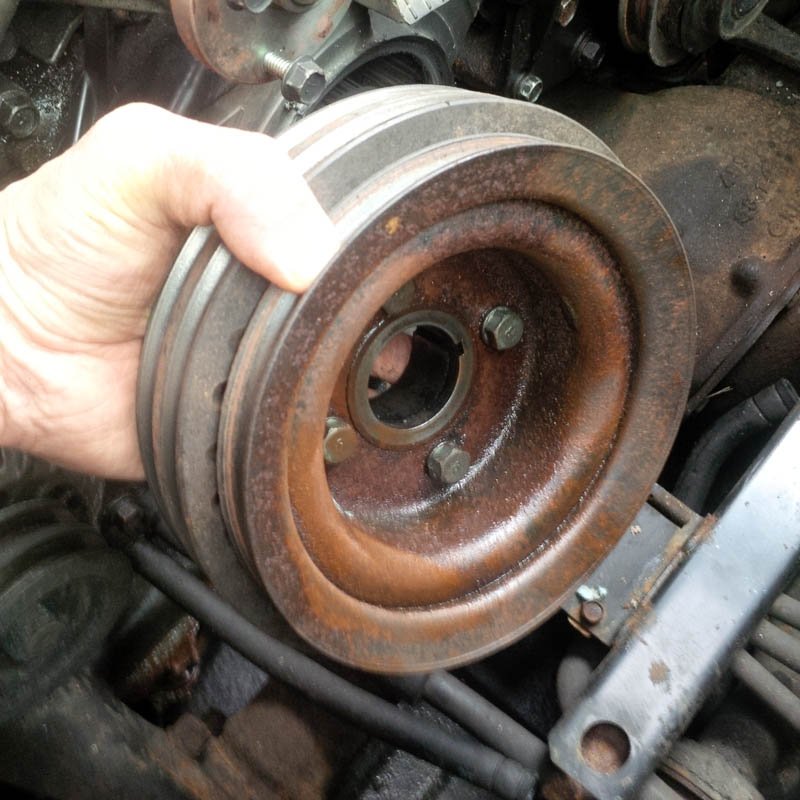

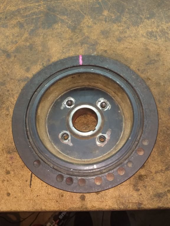

Here is a picture of my crankshaft pulley with "Wet n Wild" nail polish marking the timing mark.
Can someone please confirm that my pulley has slipped with a known good pulley?
Bonus points and manicure tips to those who reply!!

Yeah that's not right. The crank pulley looks wrong too. The timing mark should be almost 90 degrees counter-clockwise from the woodruff key. (When the crank is at TDC the key is on the right, but the timing marks on the belt cover aren't quite above the crankshaft.)
Did you turn the engine over by hand before attempting to start? 19mm socket and ratchet on the crank pulley bolt, make sure it does a few revolutions. That way if you were a tooth or 2 out (from a slightly slipped timing mark) you would have felt the engine binding. If you did that and it felt fine then the valves are probably ok (not that it helps with your warped head).

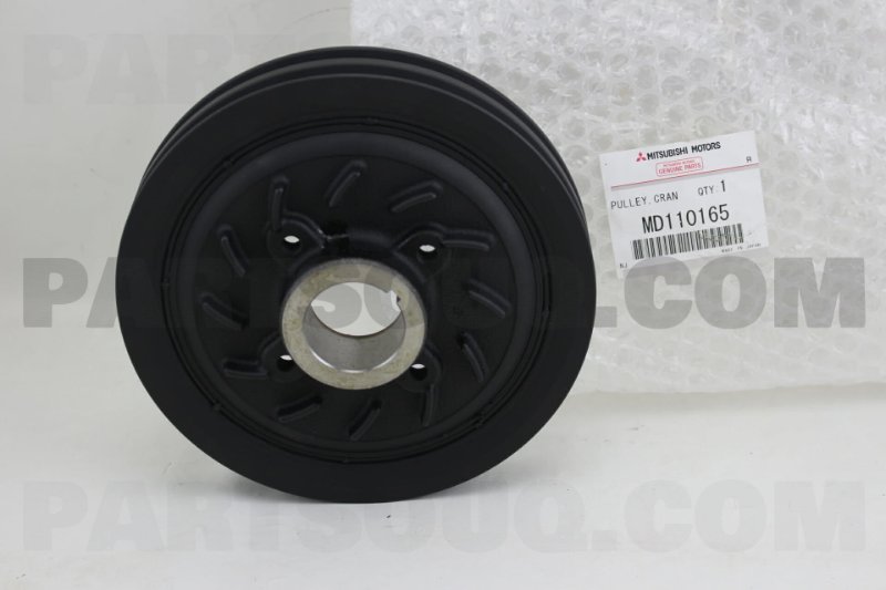

Thanks for the reply
I do have what appears to be the correct crank pulley based on this pic from Partsouq using my VIN
Unfortunately it doesn't show the timing mark.
I definitely turned the crank bolt by hand for a few complete revolutions.

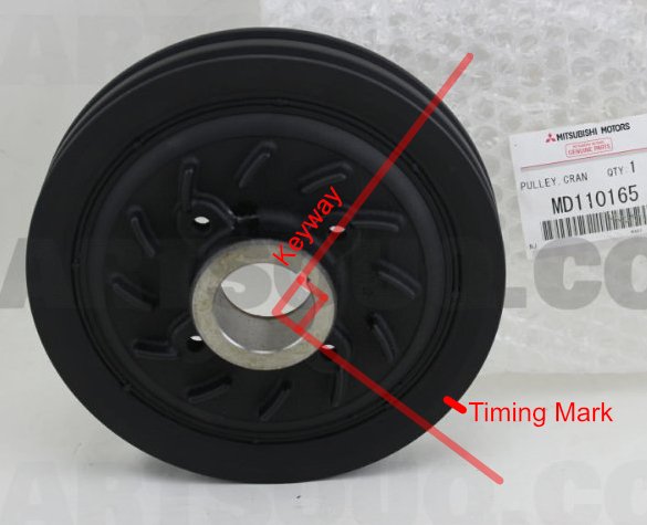

Approximate position of the timing mark:
...though that warped head is going to be a problem. To get it running I'd want to fit a new head. Before committing to a new head, check the pistons for signs of valve contact, just in case the pulley slippage is a consequence of engine lockup.
