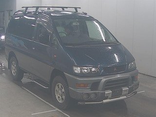

So I managed to get my hands on a Space Gear, after trolling these forums for a while. Woohoo! Took some work to get exactly the car I wanted - I was trolling the auctions across Japan... after incessantly researching trim levels, I realised I wanted a Super Exceed (Long if possible, but no lower than that), mostly because of the Crystal Lite Roof... and there are MYRIADS of Chamonix on the auctions, with very few Exceeds/Super Exceeds. A few in "R" condition passed by... obviously skipped those. Thought I had a great one lined up... until I had it looked at, and the 4WD light was on on the dash - could've been as simple as a switch somewhere, or something more sinister, based on forums... so I skipped. That one went pretty cheap, but who knows. Then I missed another 2002 one with a inop driver's side mirror and a nonfunctioning audio system and about 90K kms, I missed another 2001 with a 3" lift and slightly high (>100K kms) mileage because of a miscommunication with the guy placing the bid.... and today, I finally got one!
It's a 1998 Super Exceed:
I only have an auction picture from outside because it hasn't made its way to the yard yet where I can go look at it before it gets on a boat and off to Vancouver.

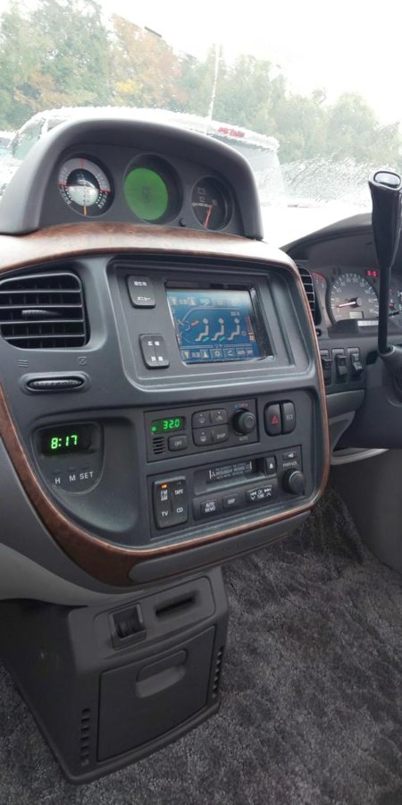

Looks like it has the usual Super Exceed package, though no parking sensors... and this is where things get really weird with the specs. First, there's no rearview camera on it ... because ... it has no aftermarket navi. I don't think I've _ever_ seen a Japanese car without a navi system, so it's completely mind-blowing to me that it has the ORIGINAL CASSETTE DECK. It also has seat covers on all the seats, so I feel like there's going to be virtually no use of the seats themselves. It also has .... 15,000 kms on the odometer. That's right, I didn't miss a zero there. And it's had a single owner all its life, so I'll be owner #2! To top it off, I thought OK, maybe someone did some fishy stuff and rolled back the odometer... but it seems to have dealer checkups every year for the last, well, 20 years, and the records are provided. I'm anxious to see how many kms were put on it between each checkup :D Looks like I'll have the lowest mileage Space Gear in Canada... maybe in the world, hahaha.
