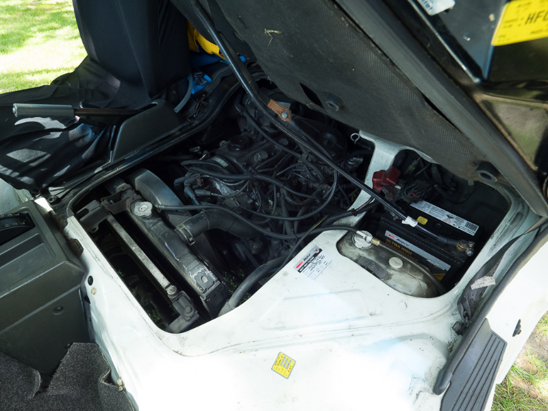

Growlerbearnz wrote:I'd pull the distributor cap off and look for moisture inside.
In the photo I attached of the engine, whereabouts is the distributor cap? Sorry I'm completely new to Delica engines.
Submerged engine in river crossing. Idle is now jittery.
It's at the front- it's the thing that all 4 (5) spark plug leads plug into. Inside is a tab that spins around, directing the high voltage spark to whichever lead needs it- if it's got water inside, the moisture will be conducting the spark to ... well, anywhere really.
