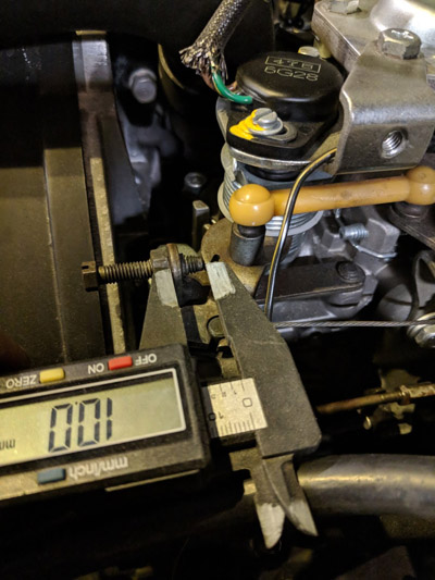

Before you change any setting or move anything, measure it and write down those measurements so you can return the pump to stock settings. Take photos. Index things with a centre punch or indelible marker. Being able to undo might be a lifesaver.
You should be measuring at least: idle adjustment, full speed screw length, full load screw length, diaphragm orientation, spring seat height.

Step 3: Adjust the full speed screw (AKA "throttle stop") to about 6mm long. Warning: this effectively disables the injection pump's built in rev limiter. It gives you more power above 3500rpm, and the engine will not "run out of puff" as much as it gets closer to the 4500rpm redline. DANGER! It's now your responsibility to not rev the engine over the redline. Not an issue if you have an automatic as it will upshift before the redline, unless you're in 2nd or Low.

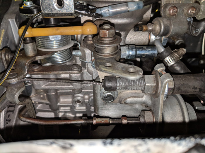

Step 4:Set the idle adjustment quite short, to about 1/3 of its length. On mine it was about 10mm from the bracket.
Step 5: Re-orient the linkage on your AC idle-up vacuum solenoid so it won't interfere with the accelerator linkage. Adjust accelerator cable if needed so there's still some free play at idle. On an automatic, adjust the kickdown cable so the metal stopper on the cable (under the orange boot) is just touching the threaded tube at idle. Make sure that the IP linkage hits the full speed screw ("throttle stop") before the accelerator pedal hits the carpet. If not, bend the accelerator pedal up a little.

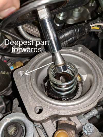

Step 6: Remove the boost compensator cover, mark the diaphragm's orientation so you can return it to stock if needed (on mine there was a small dimple on the diaphragm disc, I took note of where it was pointing). Remove the diaphragm and plunger (rotate it while lifting, eventually it'll come out). If there's a white nylon spacer on the plunger, remove it. (The spacer is the fun police and prevents too much fuel being added while under boost).

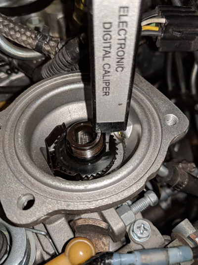

Step 7: Measure the depth of the star wheel (so you can return it to stock), then wind the star wheel/spring seat down to 12mm from the top of the threaded tube. This makes the spring softer, which will allow more fuel earlier on the boost curve, making the turbo spool up much faster.

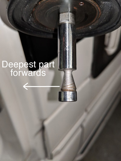

Step 8: Take the diaphragm/plunger and notice how the tapered cone is offset. Reinstall the diaphragm it so the deepest, most offset part of the cone is facing forwards (front of engine).

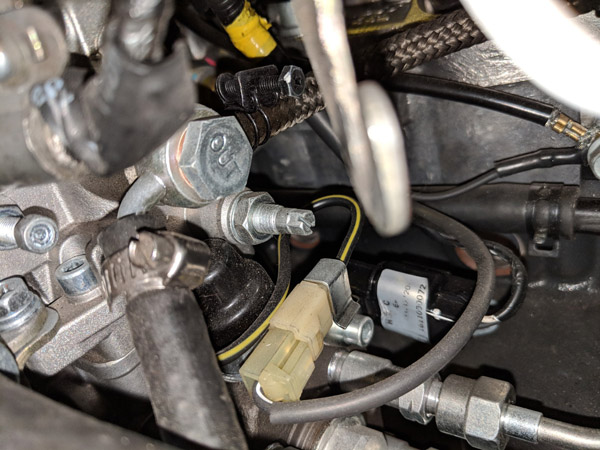

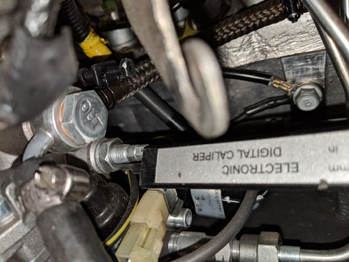

Step 10: Find the full load/mixture screw on the back of the Injection Pump: it may be covered by an anti-tamper cover, which comes off fairly easily. Measure the screw's length. Figure out what arrangement of spanners/sockets/screwdrivers you're going to use to adjust it. Crack the locknut loose.
Step 11: Start the engine, and wind the full load screw in until idle is around 750rpm. Tighten the locknut with the engine running. (Winding the screw in increases the baseline fuelling). You'll be using the idle screw to fine-tune the idle speed at the end, but this gets the overall adjustment into the ballpark.

Tuning by smoke/EGT: if you stomp on the accelerator, especially from idle, you want a brief belch of smoke until the boost hits 8psi or so (engine around 2000rpm). This is good for power because the extra fuel helps the turbo spool up faster. If there's too much smoke (it's your call here), wind the star wheel/spring seat up (S7). This increases the spring pressure on the diaphragm, preventing extra fuel injection until there's enough boost to support it.
NOTE: a compensator spring that's *way* too loose can lead to a smoky idle. The smoke will come out irregularly, in stuttery puffs. This is from the diaphragm bouncing around because the spring isn't holding it still. Same solution as above- wind the spring seat up until the smoky idle stops. That said, if it's that loose you'll also have massive amounts of black smoke while accelerating.
Winding the spring seat up may decrease your power at the top end- watch your EGTs and compare them to those in the previous step.
