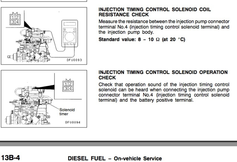

grab of l300 fuel injection systems manual

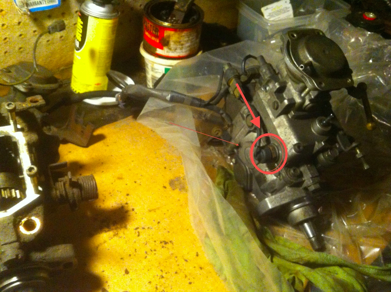

What do you suppose this solenoid does? I'm looking at pumps, concerned something may have changed after I had the pump cover off to replace the top seal, judging by the exhausted fuel under load.
The purpose of the throttle position sensor is a mystery yet on my manual trans 1990, and I'm wondering if both this solenoid and the TPS are there simply to replace the cold starting timing advance done mechanicaly on previous models and other ve type pumps. And not to time the injection, which is done mechanically with governor. Any thoughts?

weelsey wrote: What do you suppose this solenoid does?

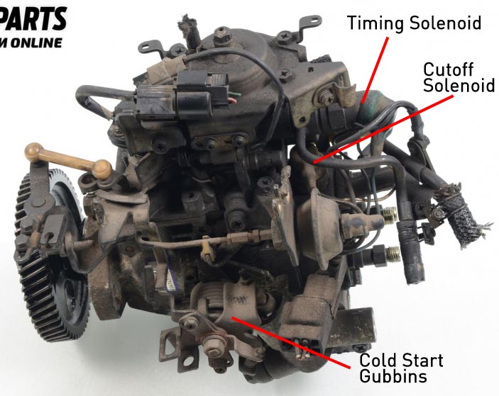

Weelll... that section of workshop manual is from an L200, and not entirely applicable to our vans. You shouldn't have one of those- and I want photos if you do! On an L200 that solenoid changes the pump's internal pressure, which changes the injection timing. It's used to retard the timing under high-load situations to allow more boost and power. It was an attempt to get more control and power out of an old pump without having to spend the money on an electronically-controlled unit (and all the wiring and ECUs).
Not your pump:

The TPS connects to the glow plug ECU, and cycles your glow plugs more if you start driving while the engine's cold. The ECU also controls Exhaust Gas Recirculation, which needs to know the throttle opening.
Normal L300s don't have cold start timing advance, and the rest of the timing is still all done mechanically. On the L200 pump the solenoid is only capable of retarding the timing, to advance the timing for cold start there's still the usual electromechanical gubbins hanging off the underside of the pump. (On a regular pump that area is covered by a blanking plate).

Ah, yes, I see there is in this image the advance mechanism on the pump, something not on our delicas. nor the return solenoid thingy from the in-between times of pump evolution. I missed that. Yet there is this electrical plug on the engine side (not on the fuel return) also wired up to something. (Pictured below)
Yeah, and we don't have that on this rig. but there is that electrical thing ....

weelsey wrote: Ah, yes, I see there is in this image the advance mechanism on the pump, something not on our delicas. nor the return solenoid thingy from the in-between times of pump evolution. I missed that. Yet there is this electrical plug on the engine side (not on the fuel return) also wired up to something.

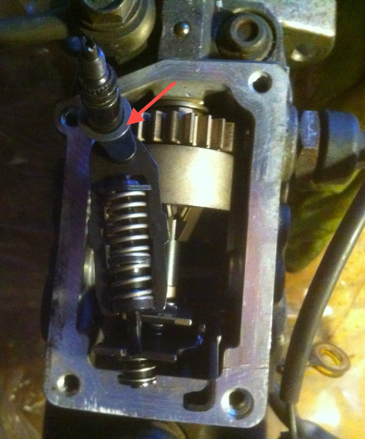

What you have there is the rev counter engine speed pickup. It's a hall effect sensor that watches the teeth on the injection pump governor drive gear.

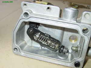

weelsey wrote: I don't really think it's possible it could have gone back together incorrectly configured and still have operated.
It seems like a long shot to me too. It's a fairly complicated mechanism and really only goes together one way. (picture found on teh internets. I recall our pumps being a bit more complex in there)
weelsey wrote: Do you think the compensation business of it could have changed from below as a result of the governor cap fiddling?
Not from below, but I did notice in your photo the cap was off. If the diaphragm is rotated it changes the fuelling, and the same with the spring seat (the serrated wheel thing under the spring). All of that can be checked without pulling the whole pump though:
Remove the compensator cover, then remove the diaphragm and control rod. While looking down the control rod hole, move the throttle lever. A small pin should poke out into the control rod bore. The small pin should move freely. You'll need to push the pin back in before you can reinstall the control rod. That pin can get sticky, and can jam the compensator in "full boost" mode and allow more fuel than needed.
The control rod under the diaphragm has an offset cone at the end- you can adjust how much fuel is added under boost by rotating the diaphragm to move the cone towards (less fuel) or away (more fuel) from the pin. The cone will have a wear mark on it where it's been pushing on the pin- reinstall the diaphragm so the wear mark faces the pin.
The spring seat is a bit trickier, and I don't have an unmolested one to measure. If you didn't move it it's likely fine. If you did change it, then wind it up a bit at a time until the smoke goes away (or you find an acceptable balance between power and smoke)

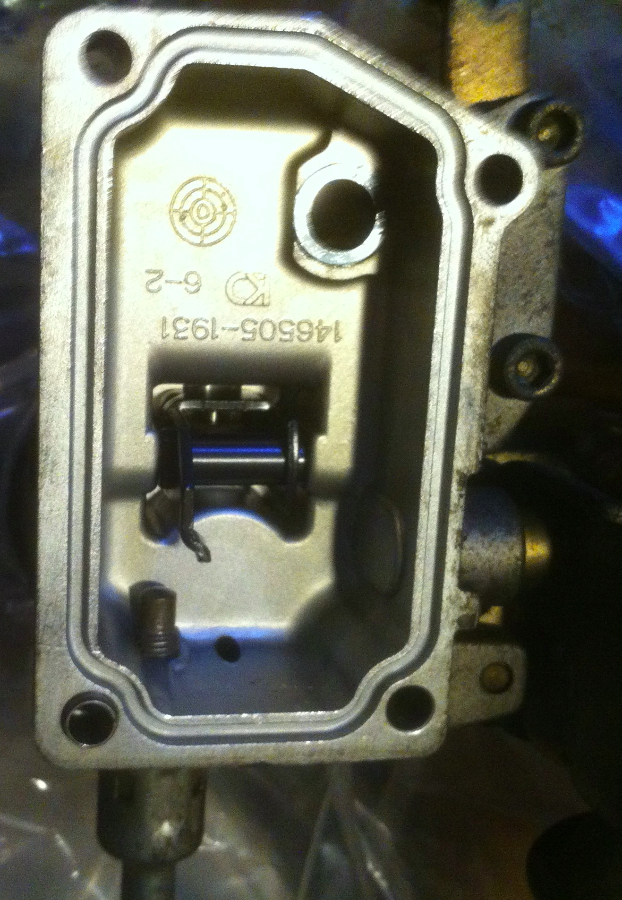

Here is a picture of our pump cover underside:
I agree it would be hard to put it together incorrectly. but perhaps a part could be missing, or dropped in the pump. egad! I realize now I don't remember seeing a washer on the throttle shaft of the van's pump, shown on the open pump on the bench.
hmmm. This is not making me relax.
I did not have the compensator cap off of the pump in the van. I appreciate you sharing your knowledge on the compensator adjustments. The one on the bench appears unmolested, and it appears a good option may be to put energy into the spare pump send it to my pump guy and replace the original.
