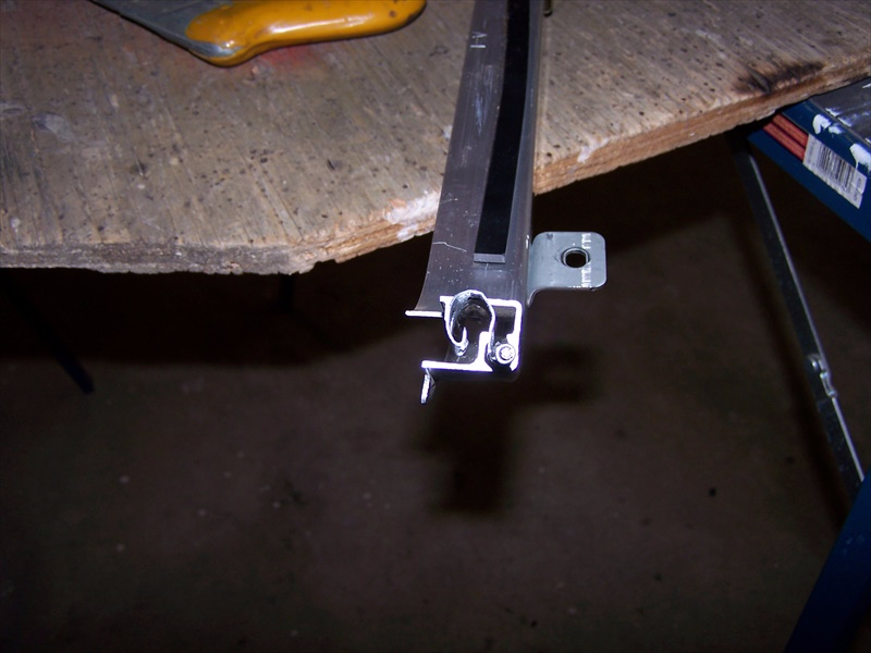

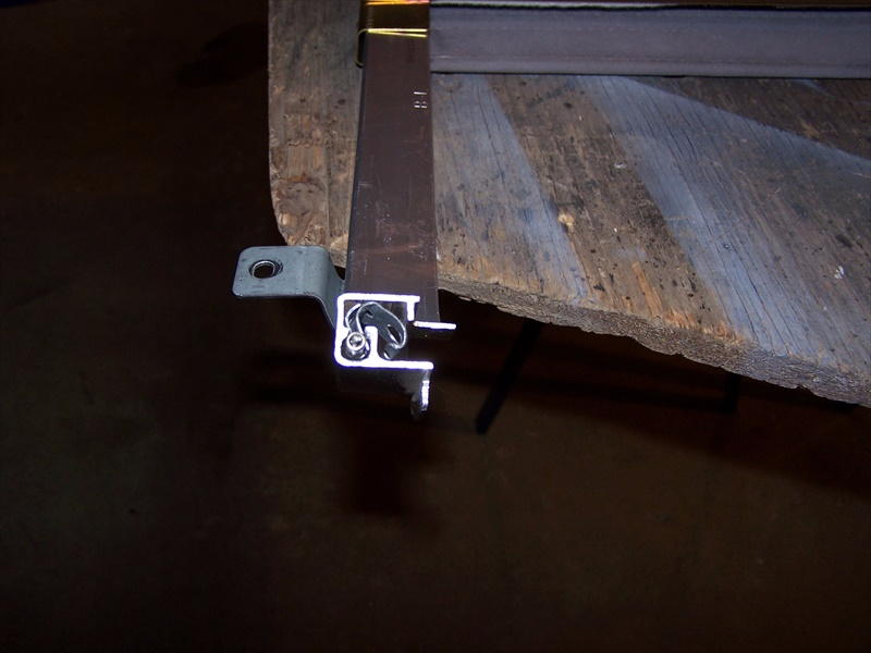

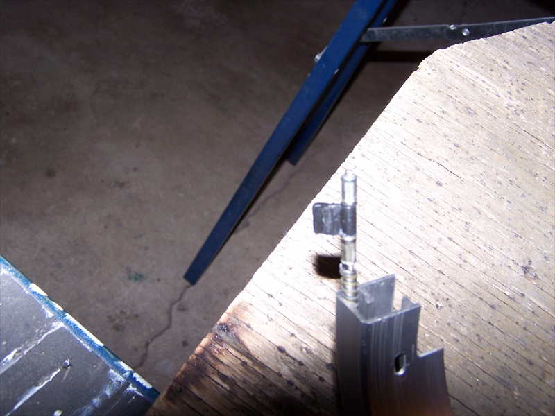

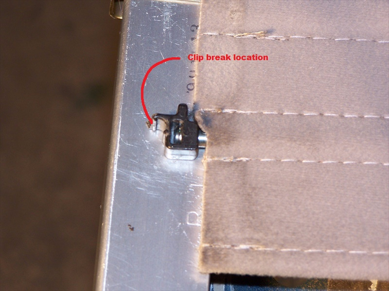

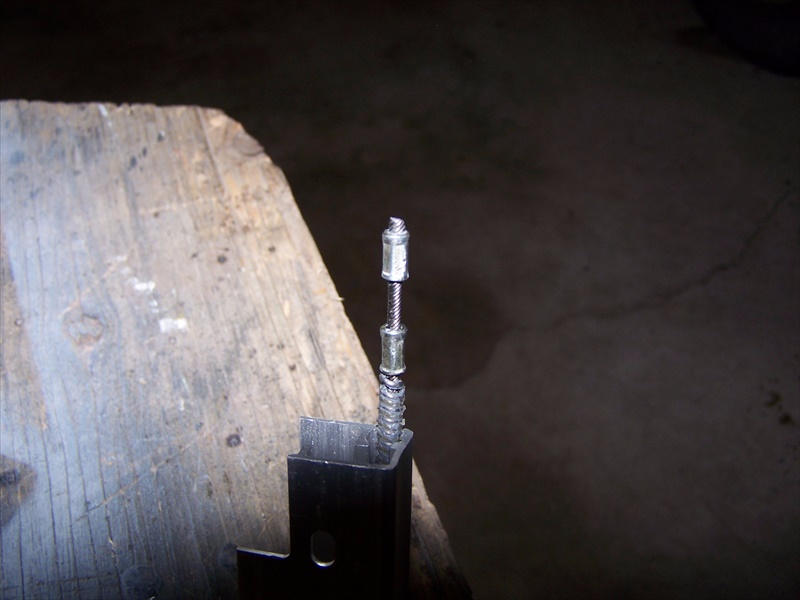

The broken clips need to be removed before the new clips can be installed. The pieces left on the cable and blind are very tough. I found a pair of wire cutters and a hack saw worked.
- Blind rod with broken clip
- 100_8070 1a.jpg (370.24 KiB) Viewed 14839 times
- Blind rod with clip removed and C spring clip in place
- 100_8073 2a.jpg (340.87 KiB) Viewed 14839 times
- Broken clip on push rod
- 100_8075 3.JPG (406.49 KiB) Viewed 14839 times
- Broken clip removed
- 100_8074 4.JPG (289.21 KiB) Viewed 14839 times

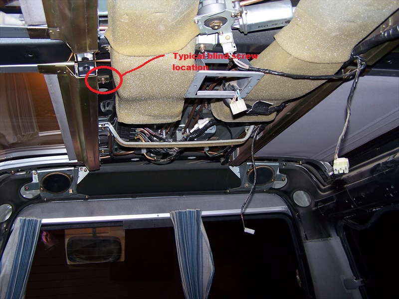

That is the blind I needed to repair. I don't think it will make much difference that the one end is still good. In order to repair the blind you will need to remove the blind stops, likely for both ends. This is necessary to get @ the cable and rod to remove the plastic and install the new clip. In order to remove the stops you will need to remove the bolt that supports the blind track. To get @ these blind stops and track support I think you would need to:
remove curtains and associated trim
remove the center trim around the light
remove the trim panels around the light on the PS
remove all the channel trim associated with the area you're working in
loosen or better remove the entire front ceiling panel
I think this would be the minimum to gain access to remove the blind track supports and remove the blind stops. This should allow the cable to be run out the end of the track far enough to get access to remove the plastic and install your new clip. If you need to remove the blind mechanism then the light will need to be removed. If this is the case the entire roof system needs to be removed which means the curtains etc. on the DS of the van. It's not hard just time consuming.
Hopefully this makes sense. If not let me know and I'll try to improve my explanation. In any case be prepared to remove the entire roof once you get started. The bonus of that is it's easier to do a through roof rust check!! Good luck.

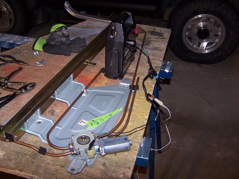

I used a test 'bench' to operate the blind and test the clips. I found it valuable to make sure they don't bind. To bend the clips I tried needle nose pliers, pliers, vise grips and a vise. All I can say about the process is be patient and beware of metal fatigue. The 12V fused supply was very handy as several of the clips got wedged in the channel and blew the 5A fuse.
- Test ' Bench '
- 100_8083 1.JPG (481.65 KiB) Viewed 14831 times

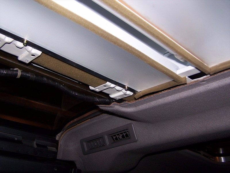

Below are a few random pictures of the install which may be of some benefit.

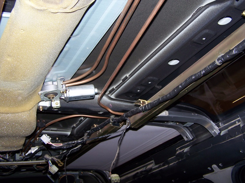

- Center area after florescent light removed
- 100_8047a.JPG (398.49 KiB) Viewed 14831 times
- Rear panel area
- 100_8049a 1.jpg (469.41 KiB) Viewed 14831 times
- Front blind area
- 100_8050a.JPG (490 KiB) Viewed 14831 times
- Front area one duct removed
- 100_8051a.JPG (454.48 KiB) Viewed 14831 times

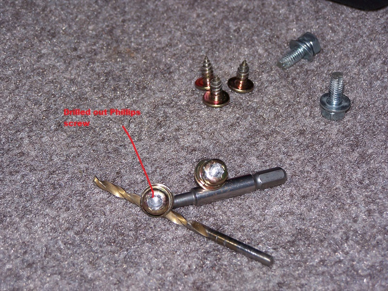

- Drilled screws from florescent light support
- 100_8053a 3.jpg (675.54 KiB) Viewed 14831 times
Crystal Lite Blind Repair
Remainder of pictures for install. Good luck and be patient for those who do this repair!!

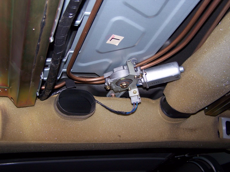

Hi - I have a 1991 L300 P35W with Crystal Lite roof, with a curtain in need of repair. I've located the replacement mechanism on-line, but the motor looks a little different --- mine has more plastic, this one is more metal looking. Can anyone offer any guidance or advice as to whether or not this mechanism will fit, and what the differences are, etc. For example, was this a re-design to make it more durable, etc?
Thanks!
