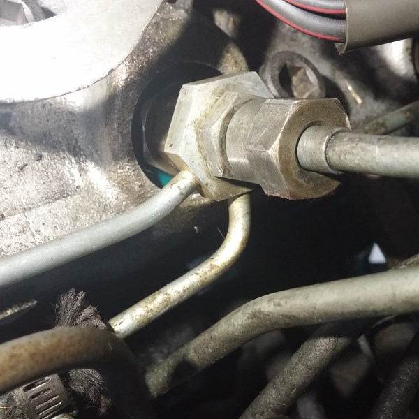

Okay, maybe this will help some people. I was getting some terrible power, high EGT's, gnarly white smoke, brutal cold starts, and everything just sucked. At one point I pulled an injector that looked a bit 'juicy' around the base. Unfortunately, I hadn't realized these bushings are single use and so I dropped it back in and went on my way. Well it wasn't long before things went bad again and then I noticed visible bubbling out the base of that dastardly injector. I decided to pull everything and replace the washers. While I'm in there I'll give the injectors a good cleaning and see what happens.
Notice the diesel pooling in the recess? (green liquid)

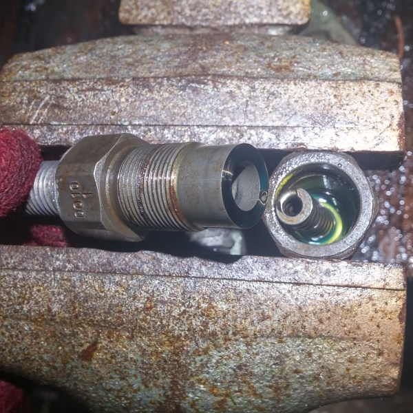

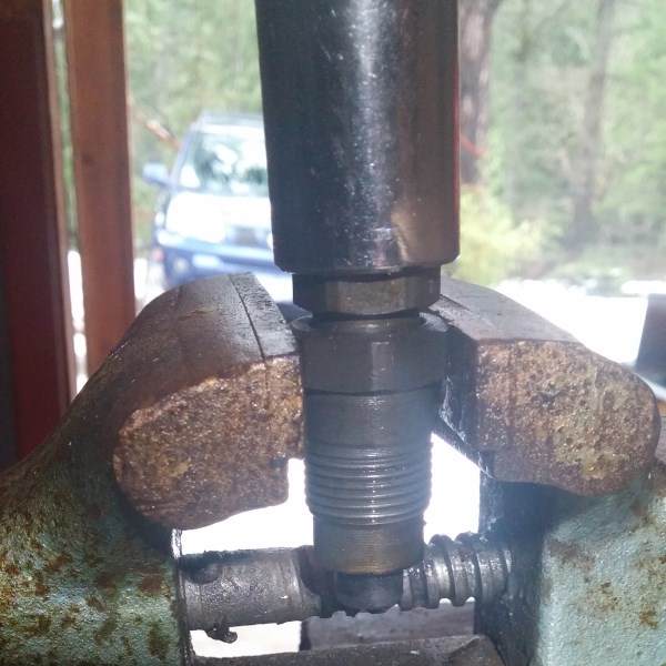

Support the injector body in a vice and using a 17mm socket, crack the body.

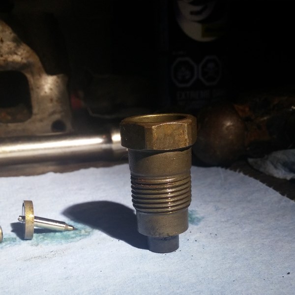

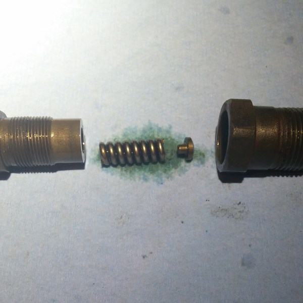

Here's what you'll see. It's important to disassemble in this orientation or you'll risk dropping the little spring seat on the ground.
This is what pops out of the body at this stage.

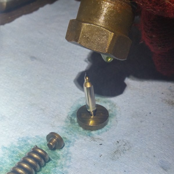

To drop the pintle and seat, gently tap the injector body on a clean surface and the pintle and seat will drop out.

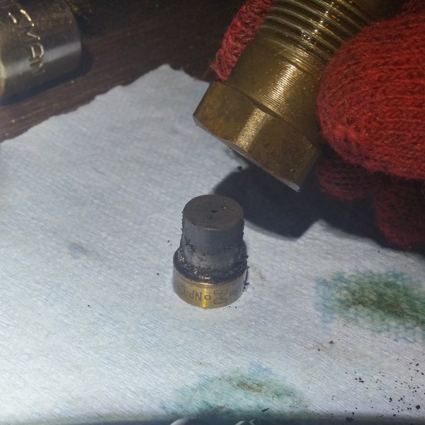

Turn the housing around an place it, nozzle down. Give the body a tap and the nozzle will slide up into the body and you can pop it out.
Voila. As you can see, my injectors were desperately in need of a re/re. I hope they go back in okay, lol...
