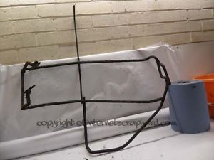

The standard spare tyre holder is a specifically shaped rack made of 1/2" steel bar. Like so:
Not the best photo, sorry. The left side in the photo is the front, which bolts to the crossmember above the axle and has a couple of hinges in it. The J-hook attaches to the right hand side. To remove the tyre you unwind the bolt in the rear hatch opening, which lowers the J-hook, and then the carrier swings down on its hinges. I believe the Mitsubishi Van/Wagon used the same arrangement.
