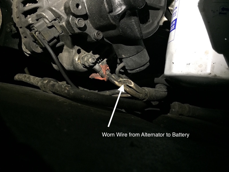

Did some more digging and discovered what I figure is the problem.
A worn wired leading from the Alternator to the Battery.
Now I have to figure out should I cut it back then splice in new piece or replace the whole run?
Then there is the green wire that I pulled off the connector. I cleaned and re-connected it.
