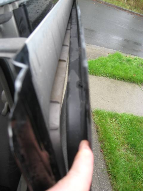

Our sliding door clunked over bumps for a year. It turns out some clips fell off and the the sliding door glass started coming away from the door frame.
Window pulling away from frame. To the right of my finger is the glass. The window should be flush with the body but is out an inch.
The repair: Carefully remove the inside trim piece around the sides and top of the window. There are plastic tabs inside the trim piece that click into metal clips on the door. The plastic is old and brittle so expect to break some of the tabs. I find a plastic bike tire lever is great for removing trim pieces.

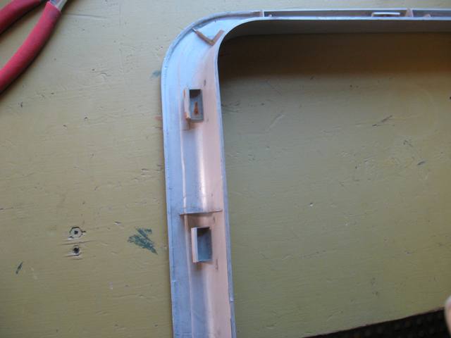

Inside of trim piece with tabs.

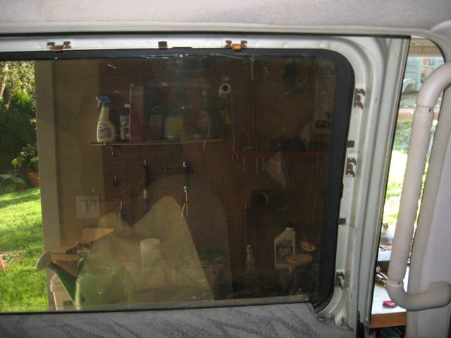

As you remove the trim piece metal c shaped clips will fall into the footwell of the sliding door. You need these to reattach the window. Some may also hide behind the lower piece of trim and you can carefully reach behind it to retrieve them.
This shows the larger clips that accept the tabs, but also the smaller c shaped clips (little black squares in photo) that hold the window to the frame. I bent a few of the clips tighter with pliers before putting them back on. With all the clips back in you can think about reassembly but first you are probably going to have to glue the broken plastic tabs back on.

I too broke a few tabs. They are made from a very brittle plastic which over the years has only become more brittle.
I suggest trying to spray some silicon lubricant in the general direction of each tab using the little tube that comes with those spray cans. It may help the tab release from it's metal clasp and possibly prevent them breaking.
I lubed all the ones I didn't break so that they would go in easy and come out easy should I need to work on the door again soon.
