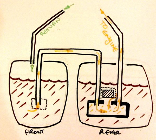

——Fuel Supply to engine——
Here’s where it gets tricky. The fuel supply to the engine is primarily drawn from the rear tank, but it’s a bit more complicated than that. The rear tank’s pickup draws fuel through the strainer and into the pickup chamber.
The pickup chamber is also connected to the front tank- so the fuel is also drawn from the front tank. Normally the pipe connecting the front tank to the rear tank would be full of fuel and acting as a syphon, keeping the tank levels equal.
If the syphon loses its prime the fuel level in the rear tank can get too low, and the float inside the strainer blocks the inlet into the pickup chamber. Fuel is now only drawn from the front tank.
Excess fuel from the engine is returned into the front tank.

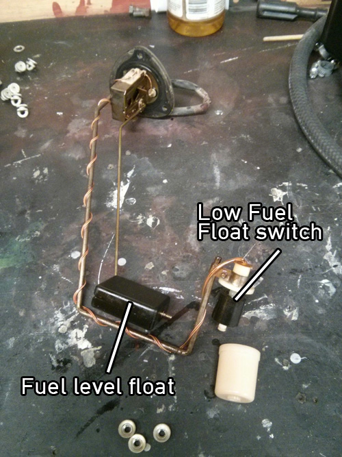

——Fuel gauge and low fuel light——
There are two fuel level senders, connected in series so the fuel gauge shows the sum of their levels.
The low fuel warning light sensors are likewise connected in series, but work in different ways. The front tank’s sensor is a float switch which turns on when fuel level gets too low.
The rear tank’s sensor is a NTC Thermistor- a small component that has high resistance when cool (like when immersed in fuel), but rapidly heats up when not immersed, flowing more and more current until there’s enough to make the light in the dashboard glow.
Not actually a Delica level sender- but pretty close. The NTC Thermistor is inside the metal can (circled).
For the light to be on, both the front tank switch and the rear tank sensor need to be on.
