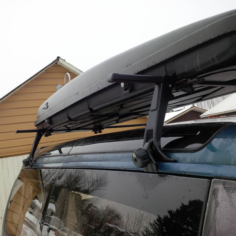

My L400 with high roof and crystalite has a Thule footpack #953: http://www.thule.com/en-us/ca/products/ ... 953-_-1089
Matched that with 58" load bars and a ski box.

How much overhang do you have on each end of those bars? I'd hate to get the 50" and then have it be too snug, or *gasp* too short!!Matched that with 58" load bars and a ski box.

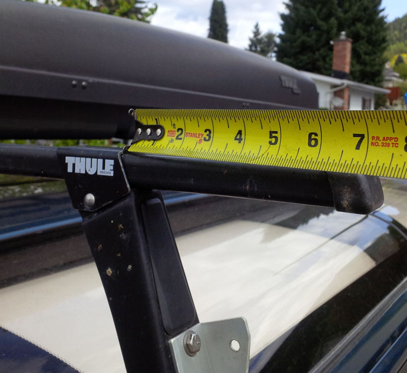

Bars overhang about 7" on either side with 58" bars.

Also, what height feet did you get to clear the Crystal Lite? Site says you can get 5, 8, or 11". I'm thinking the 5"s won't get it done, and they look like at least 8". Is it possible you need the 11"s?
I do have two questions, though...
Wouldn't that mean that there are 14" of extra bar? Or is it just 7" on the one side?Bars overhang about 7" on either side

In my case there is 46" between the two feet, so a 50" bar would protrude a couple of inches on each side. I have an 11" tall foot, and I measure a 4.5" clearance to the crystal roof at it's lowest point, so yes, at least an 8" foot height.

Tojo, I have the same Thule racks for my L400, however, the rain gutter spacings did not allow me to mount my towers as far apart as yours are in the attached picture. Did you have to trim the base of the mounts?

Would you be able to grab the measurement from the bottom of the gutter to the bottom of the load bar on the rear bar?? I'm going to get some pieces cut at work to make custom feet. And with that measurement, how much clearance approx is there between the bar and roof, I want mine as close as possible.
