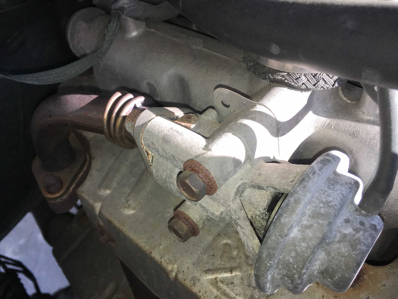

Here is a pic of my EGR valve ...there is a little aluminum plate in between. Is it from the original or was it an attempt to blank the EGR valve?

You will remove the EGR when you install the blanking plates AND plug the vacuum hose that you remove from the EGR actuator. If you do not plug the hose it will suck dirty air into your vacuum pump and may cause vacuum issues elsewhere (brakes, 4x4, etc). The plate you see at the top of the EGR is just a seal, meant to be there. I can't remember if you need to add a seal to the blanking plate kit or not. I think it comes with everything you need though.Delica_Acadie wrote:Here is a pic of my EGR valve ...there is a little aluminum plate in between. Is it from the original or was it an attempt to blank the EGR valve?
